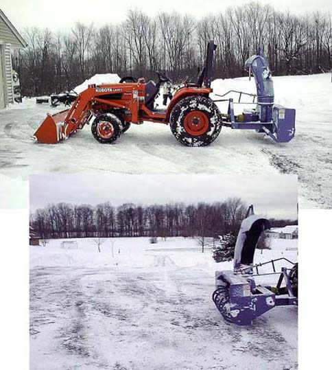

I plan on ordering a rear mounted snowblower for my B7500. Will I need to also buy chains or will my filled R4's be enough?
I have a 20 degree rise on my road.

I have a 60" Lucknow behind my B2710 with loaded turfs w/o chains. See the attached photo and you can see that I have a hill to my driveway. I have no problems with traction. I would try w/o the chains and see how it works out.
