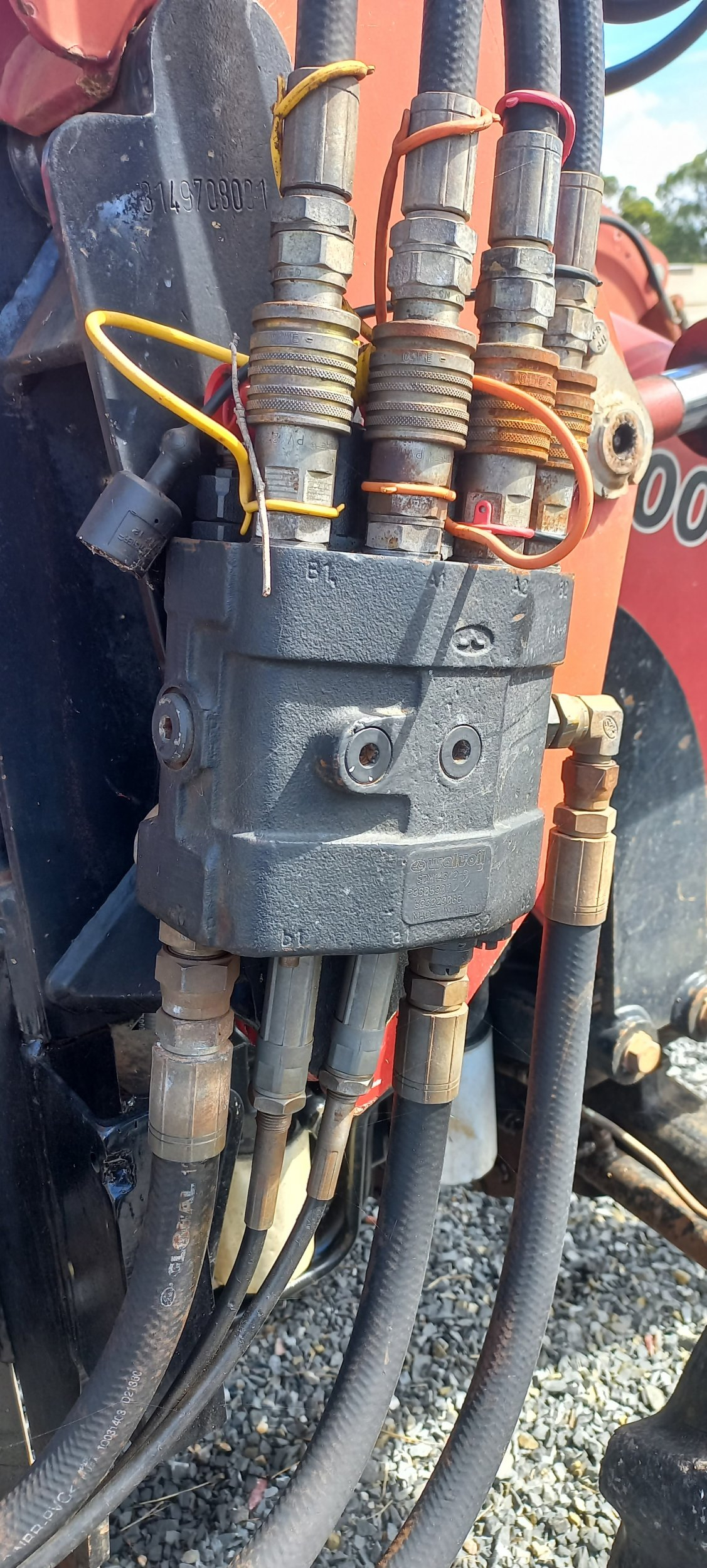

Dec 24, 2021 / Third function Case JX100u #1 B Brettb69 New member Joined Oct 15, 2019 Messages 3 Tractor JD 6610 G,day could somebody tell me where the power beyond is on my Case JX100u. Its a Walvoil valve. Cheers Attachments 20211225_092800.jpg 1.9 MB · Views: 89
Dec 24, 2021 / Third function Case JX100u #2 LouNY Super Star Member Joined Jul 4, 2015 Messages 14,823 Location Greenwich, NY Tractor Branson 8050, IH 574, Oliver 1550 Diesel Utility (traded in on Branson) NH 8160. Kioti CK2620SECH Any marking on the valve body next to the fittings? look for an N
Dec 24, 2021 / Third function Case JX100u #3 K5lwq Elite Member Joined Aug 6, 2017 Messages 4,920 Location Mineola, TX Tractor Kioti LK2554, Branson 4815C, Satoh Beaver, Speedex I marked your picture for you. P=Power In T=Tank C=Power Beyond.
Dec 24, 2021 / Third function Case JX100u #4 K5lwq Elite Member Joined Aug 6, 2017 Messages 4,920 Location Mineola, TX Tractor Kioti LK2554, Branson 4815C, Satoh Beaver, Speedex Here is a link to the manual for that valve just in case you want it. http://www.walvoil.com/allegati/catalogo/DAT009_ENG.pdf

Dec 25, 2021 / Third function Case JX100u Thread Starter #5 OP B Brettb69 New member Joined Oct 15, 2019 Messages 3 Tractor JD 6610 Thats perfect, thanks people.
