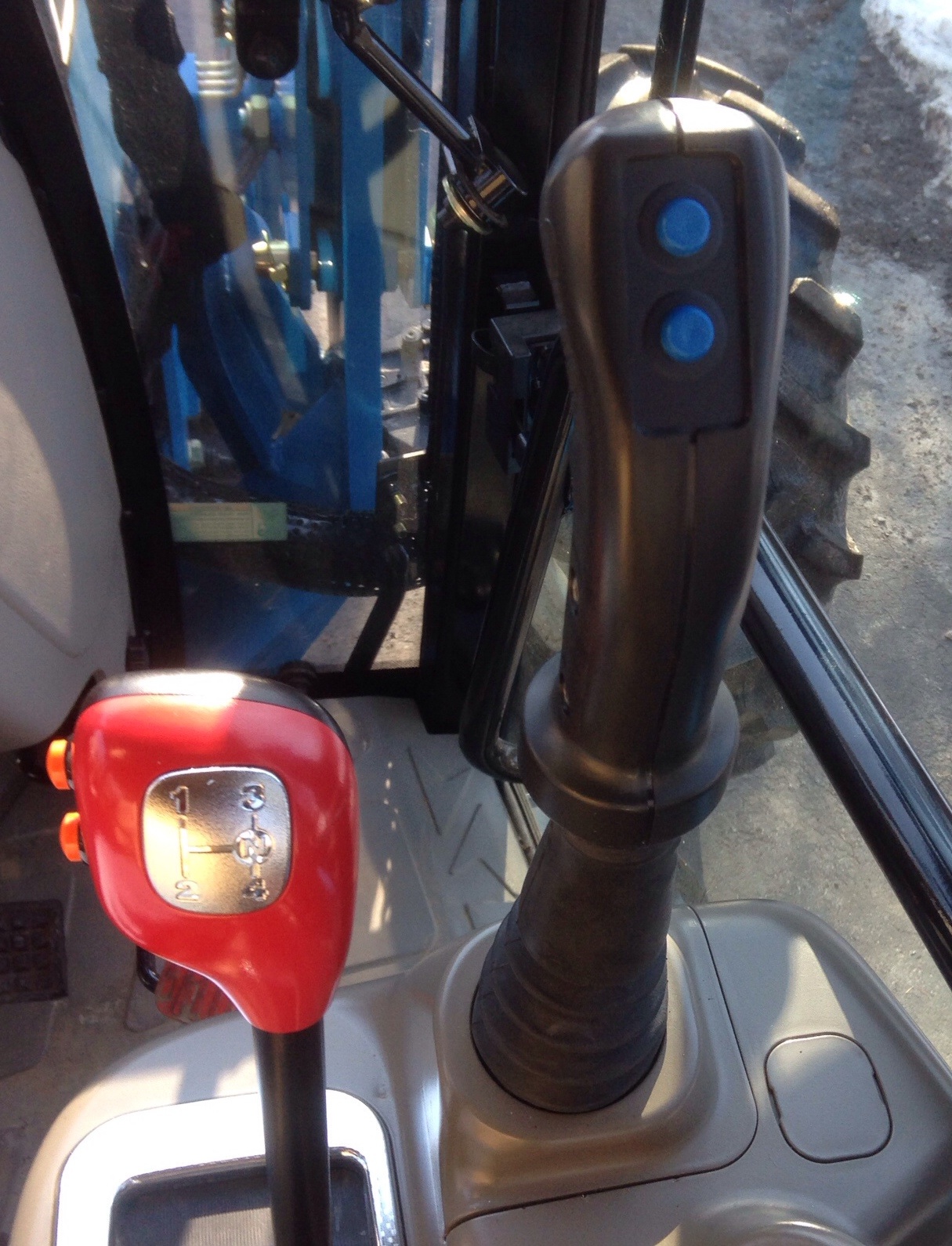

I am having a third function added to my John Deere 5085 E Cab (should be here late next week), and wanted to know if anyone has this same setup so that I can see what it looks like on the joystick? I might be expressing this wrong. But it was my understanding that you would have a couple buttons on the joystick that controls the FEL to open and close the Grapple that I purchased too. Anyone have pictures that could be shared?

Okie dokie and thanks. Did you install this yourself?
/ Third Function - Joy Stick #4
No, the Kubota dealer did the entire third function wiring & plumbing. Just got the tractor with third function plumbed in back from the dealer this last Friday. Land Pride SGC1560($3200) & the third function valve & plumbing/wiring ($1200). Got the grapple from same Kubota dealer.

Nice, and I am in the waiting game. Mine is suppose to arrive late next week. Can't wait! Thank you for sharing the pictures I appreciate it.

Is this a JD kit or aftermarket? That will determine what handle you get.

It better be the JD kit, after all it cost me over $1,000. :)

Could be a WR Long. They are a first rate real 3rd function kit. We have added this to our NH TL100A for the 84" grapple.

I contacted the dealer this afternoon to find out what kind it was, but he was out. I know that the front end loader is a H240.

I have the WR Long 3rd function kit also but didn't like the control grip and bought a Scorpion grip to replace it.

I was told it was going to be the John Deere model.
/ Third Function - Joy Stick #14
Hmmmm. I staggered out in the dark and checked mine. Its a WRLong. That joy stick handle is the new WRLong one (post #2) also.
