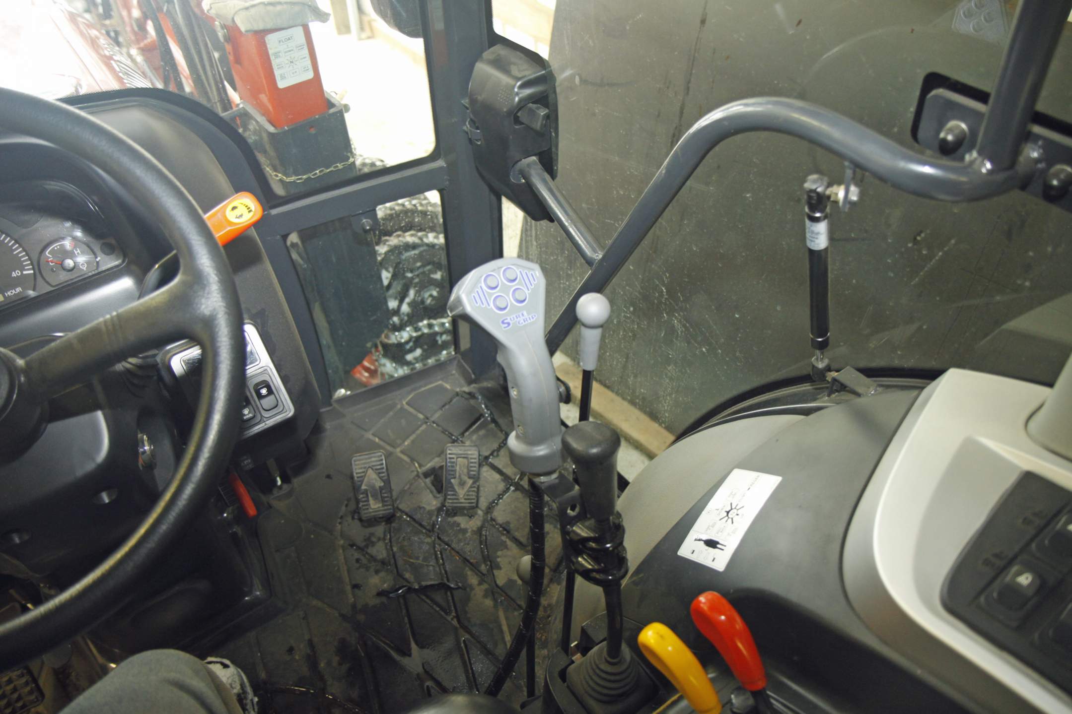

   / Third function on Kyoti #4

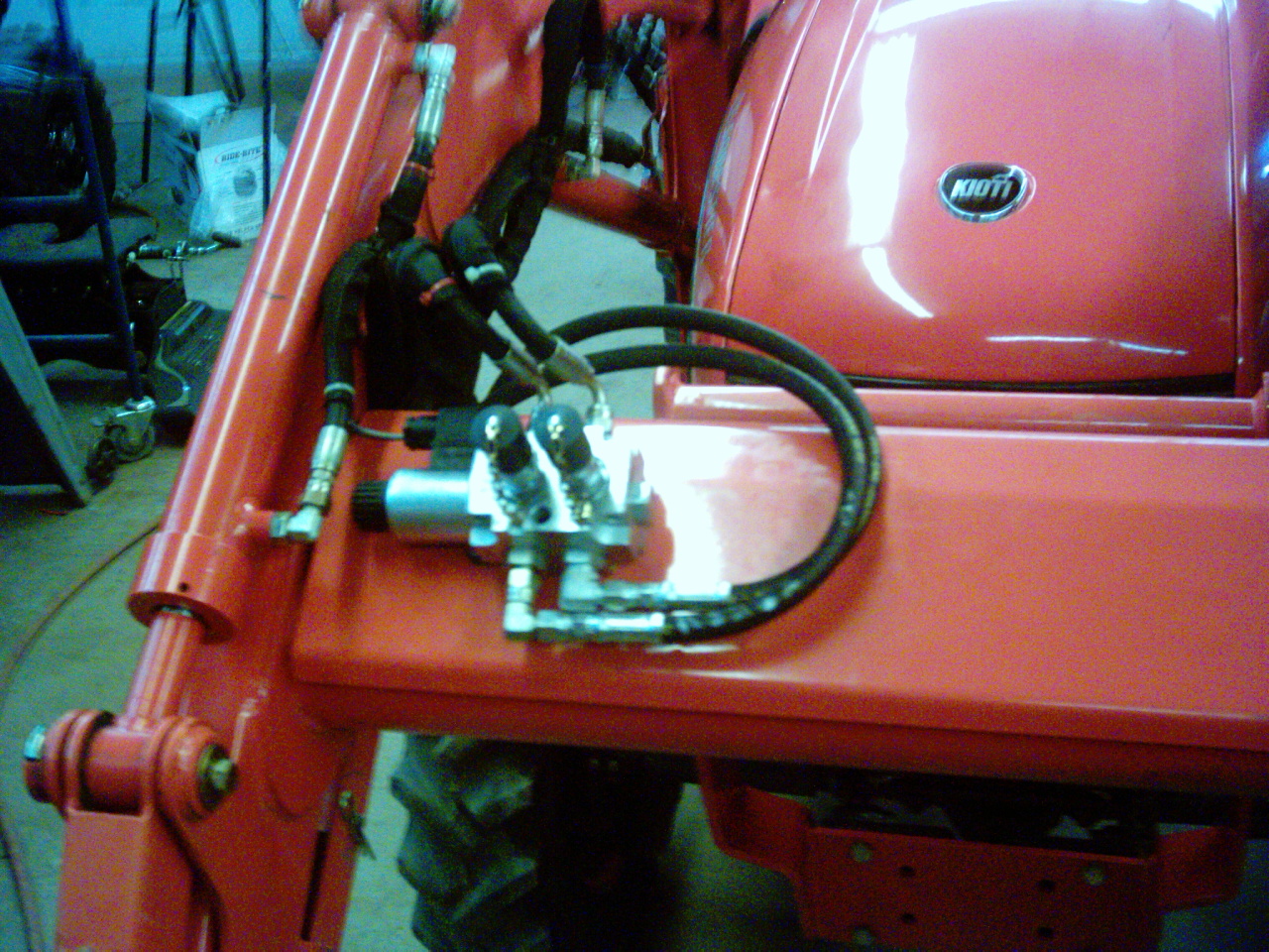

The dealer installed an electric diverter valve on my loader, took about half an hour. I was there when it was installed if i would of known i would have installed myself. I need both my rear remotes for the snow blower and thought to add an extendable snow plow this year, so i had the valve installed. I'll post pics of how the hoses are connected later.

   / Third function on Kyoti #5

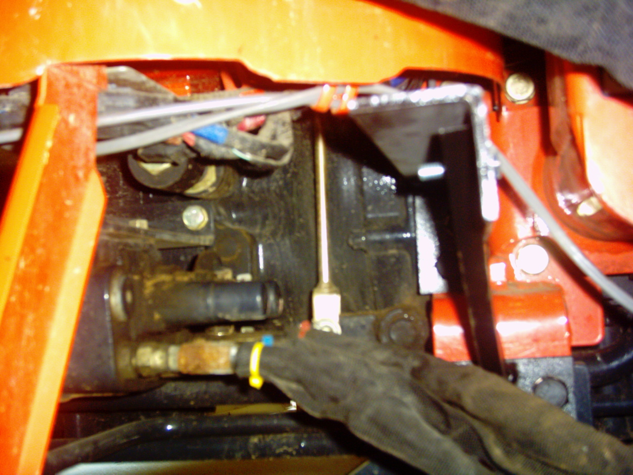

Interesting location. Mine is underneath the Tractor, behind the 2 rear remotes and the hyd lines run to the FEL connections by the right step to make it easy to drop the FEL w/wo the grapple attached, and I also have QD where your 3rd function is to make it easy just to drop the grapple.
Very interesting location...
Thanks for sharing.
David

   / Third function on Kyoti #8

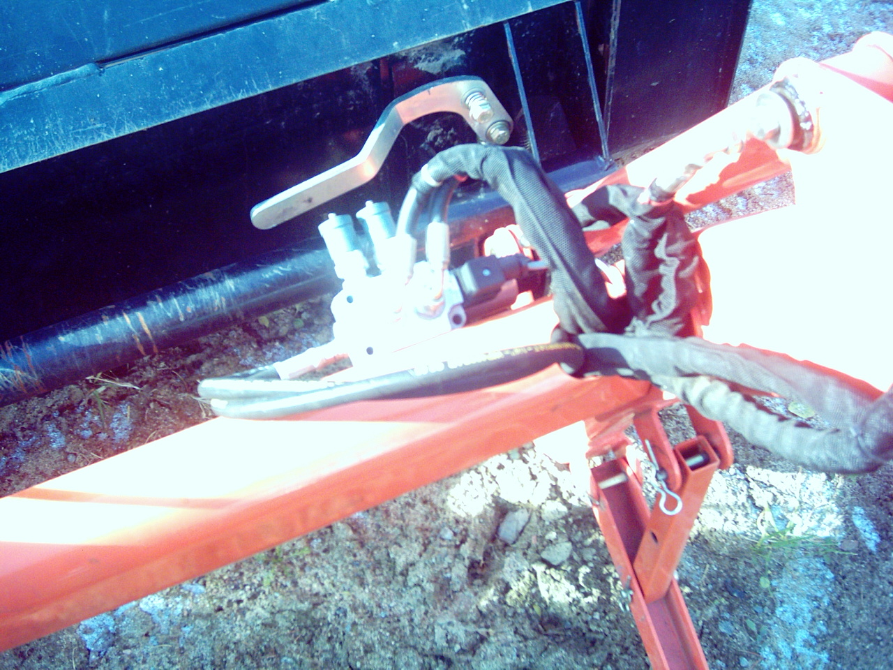

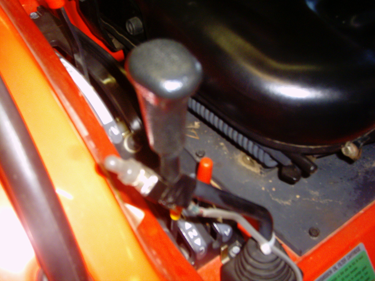

To remove the FEL, all i have to do is remove the 4 QC hoses and disconnect the switch connector. I will install a push button on the joystick later to control the diverter valve, to busy building a cab for my tractor:thumbsup:
