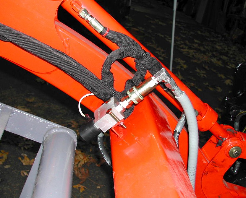

Mine is underneath the Tractor, behind the 2 rear remotes and the hyd lines run to the FEL connections by the right step to make it easy to drop the FEL w/wo the grapple attached, and I also have QD where your 3rd function is to make it easy just to drop the grapple.
Mine is on top of the FEL cross-beam like KARL's above, but I would
consider putting it on the bottom side of the cross-beam for somewhat
less exposure to the errant log....
For me, minimizing the length of hoses was paramount.

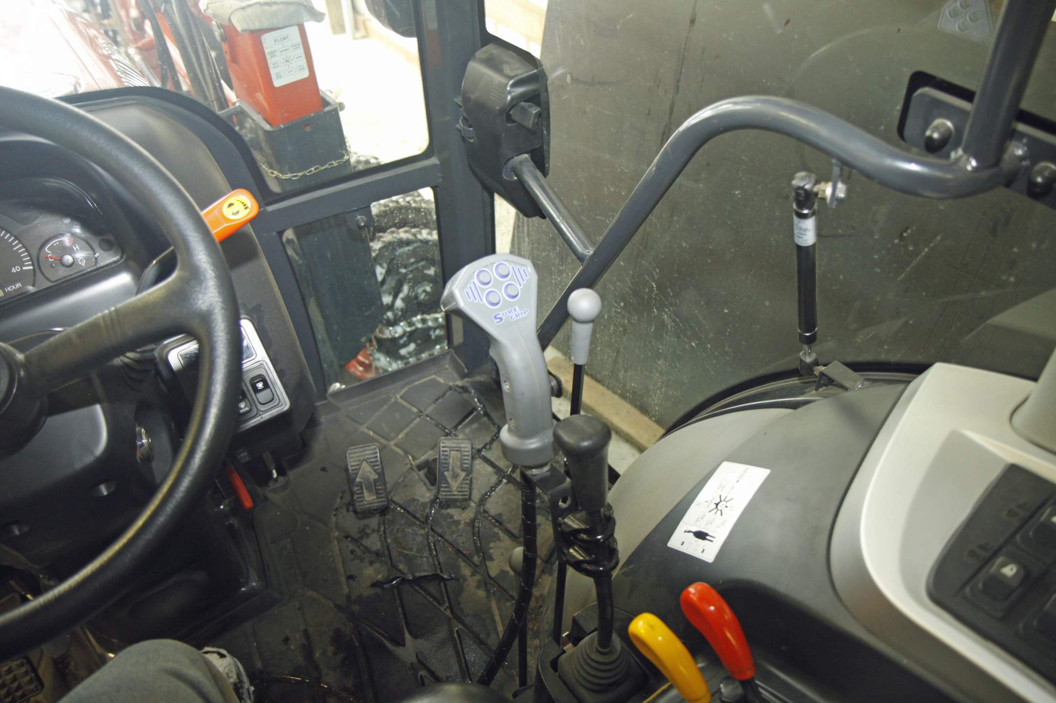

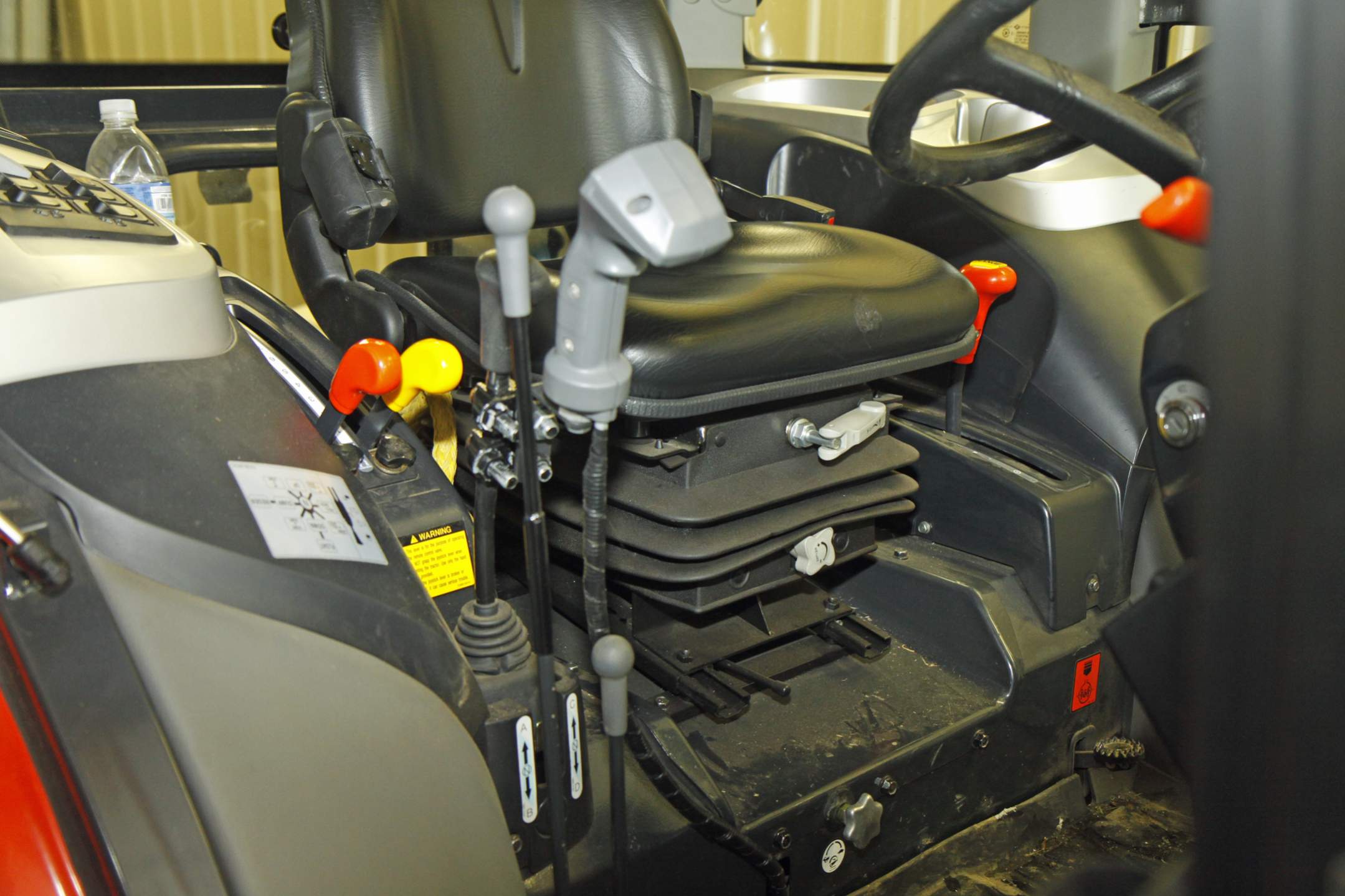

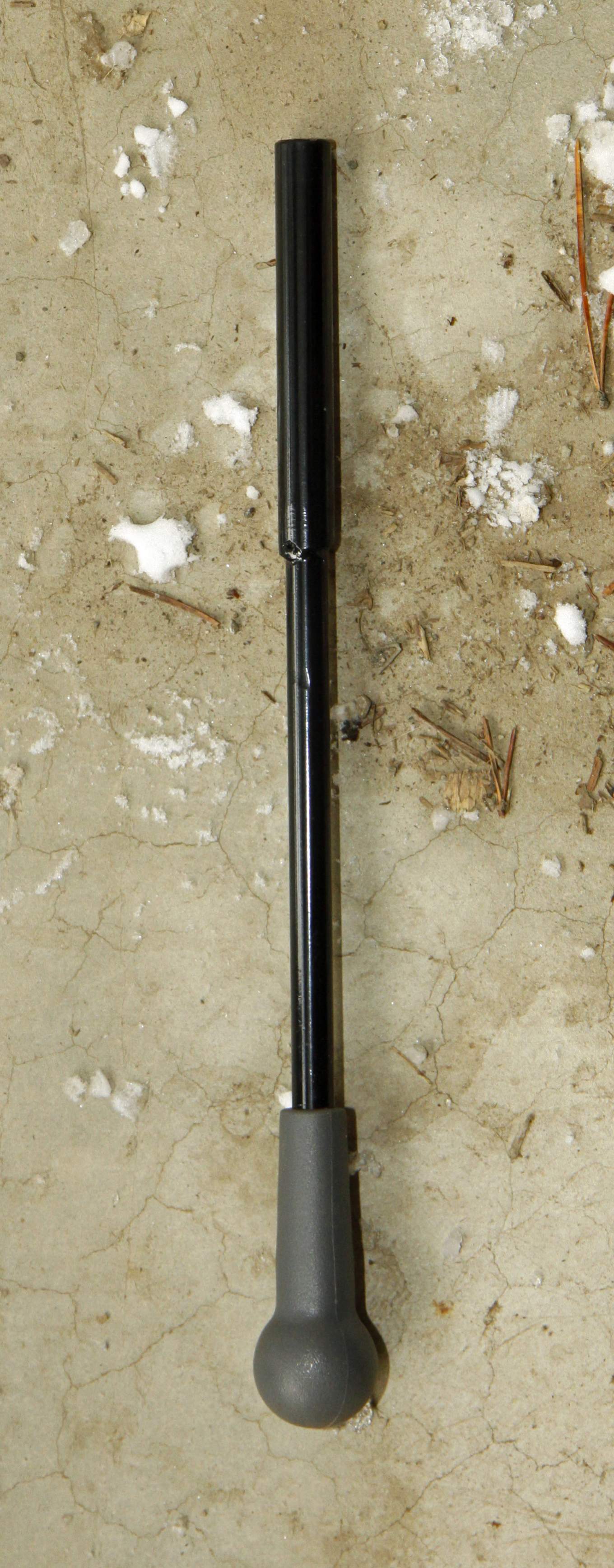

On my Kioti i simply made an removable extension rod from the rear remote control that goes up right next to the loader control. I use it for my plow...and love it. Especially as i have the plow set for both depth and rotation, and i cant accidentally move the plow position as i fan it right or left.
I'm still pondering the possibility of getting a 3rd valve control installed, but it might not function when i mount my blower control to the joystick. still playing with the idea.
