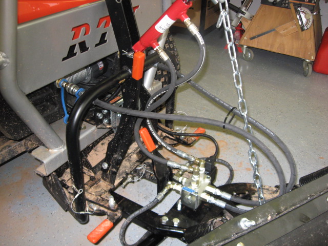

I used a similar setup on my RTV900 to control the up/down and left/right for my Curtis plow using the existing hydraulic control valve that is hooked to the dump box. So, I unhook the dump box and hook up the QC for the plow. The two lines run to the 12 volt selector valve and from it two go to the up/down cylinder and the other pair go to the left/right cylinder. Each pair are on one side of the solenoid. In other words the top say has the up/down cylinder, the left side has the two inputs from my control valve and the right side has the pair going to the left/right cylinders. When not energized the up/down operates as this is the one most often used. When energized the left/right cylinders swing the plow.
Your box will be slightly different in which side hooks to what, but each side should do a particular function, ie power in, up/down or left right. Make sure nothing is crossed functioned is my only guess.
Found a picture. Front two, plow side is inputs, back two are my left/right and top two the up/down. Like I said yours maybe different but each side are a set.

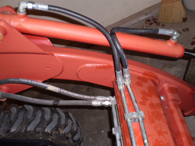

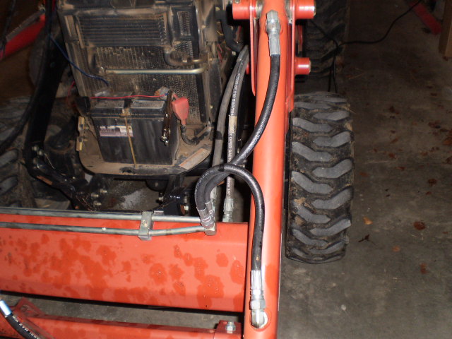

Well I feel like a maroon!! I flipped the valve over and ran the lines and guess what....It works like a charm. Now all I have to do is figure out how to wire in my relay and mount my switch and I am good to go.
One other issue... It's been so long since the cylinder were actually used they are leaking some fluid out of the weep holes in the bottom of the cylinders.
Thanks for the help guys and I have learned my lesson the hard way, as usual! I'll pay a little more attention to the diagram next time.
One question. I am thinking I would like to mount the valve down on the cross bar on the loader. Would it be possible to remove the hoses from the end of the curl line that go to the left cylinder and run them to the valve and then continue from the valve to the left cylinder in the normal mode and then run lines from the valve to the plow?
Working late tonight?:laughing::laughing::laughing:
Yes, you can mount the diverter anywhere, but I think it's to vulnerable up there on the cross tube-just to many hoses. Plus if you get a grapple in the future (since you already have the hydraulics complete) there will be sticks and branches in that area. My vote is on the upright frame or "mast" as they call it, it's much more protected there.
As far as the cylinders, the inside of the bore is probably rusted and pitted so the seals got torn a little.
