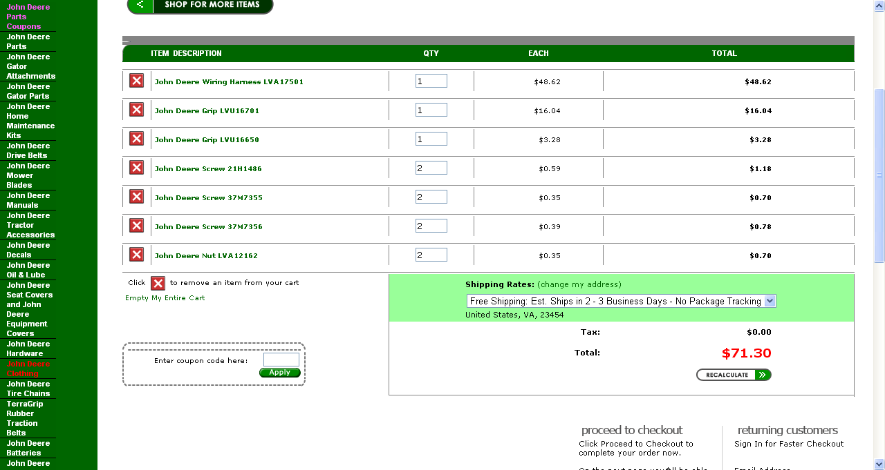

I just ordered one for my tractor.
Here's all of the part numbers and prices...free shipping.
I even ordered all of the screws. It was less that $72.00
Kubota wants $190 for the Grip and switch.

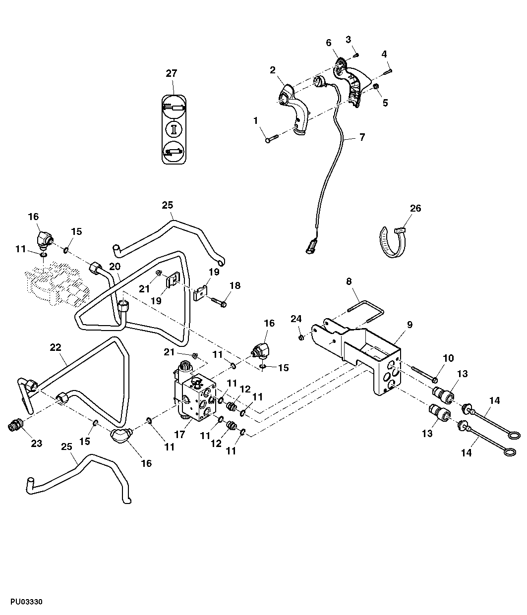

Here is a drawing from JDFparts, parts 1-7.
Have you received the parts? If so, a couple of questions:
How many wires, type of connector?
What is the diameter the grip fits?
Thanks!
