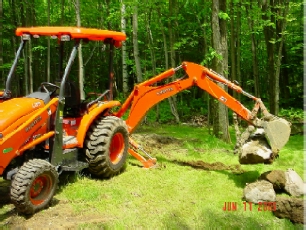

Purchased from USA attachments:
http://www.excavatorthumb.com/mt824_mini_excavator_thumb.html
Make sure you prefit all the pieces together, as the fitment is rough. I ended up welding up a few of the loose pin holes and grinding the tight ones for a good fit.
Also you need to special order the attachment bracket at 2.62 wide for a good fit to the BH boom arm. Wider and you will need to modify something.
I figure that's about a 1,000 LB rock in the claw.

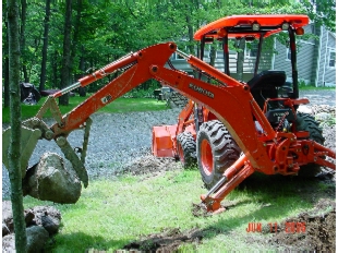

Another shot of the L39 with Thumb

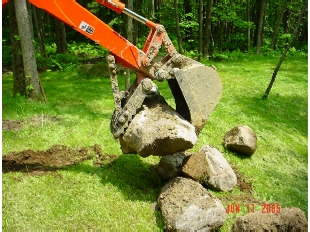

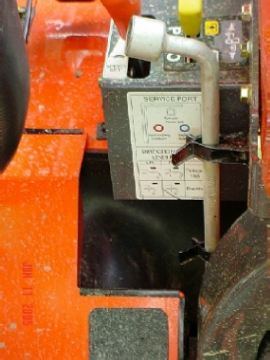

Another Photo of the Mechanical Thumb For the L39.
Note the neat fog Lights that augment the standard headlights.
