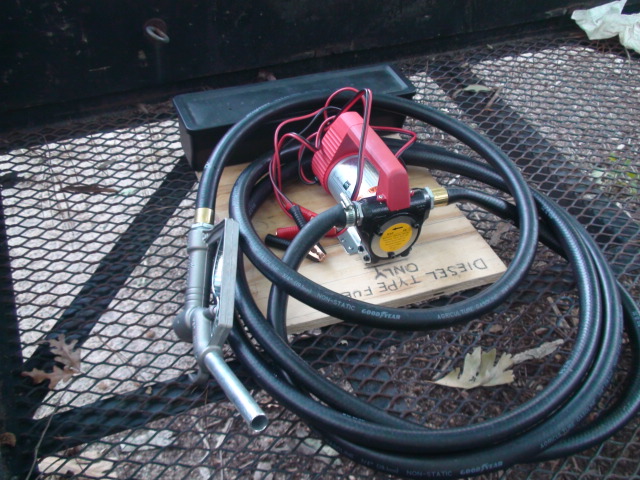

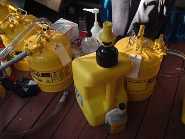

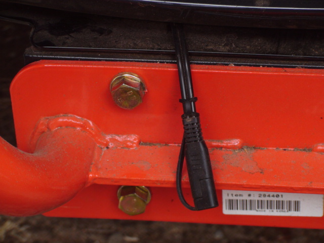

I have three more years on you so I do this. I use the round cans to transport in the car/Jeep for filling, but they have a flame arrester and I can't insert the tube for sucking out the fuel. I use the round cans to fill several square, plastic diesel containers, which I insert the diesel pump inlet hose into while they are sitting on the ground- no lifting. I also have a quick disconnect 12vdc power connector at the front of the tractor for connecting the diesel pump to. And of course insert a Mr. Funnel AF15 fuel filter into the tractor's fuel tank filler opening.
Very easy to fuel with 5 gallons containers.
