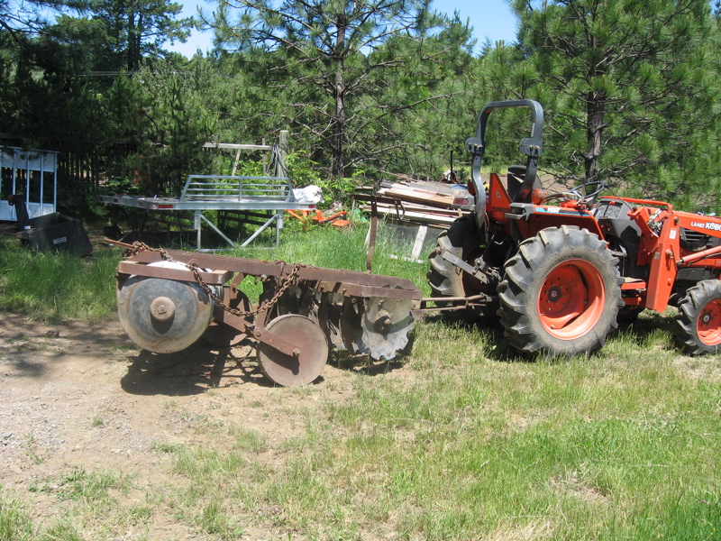

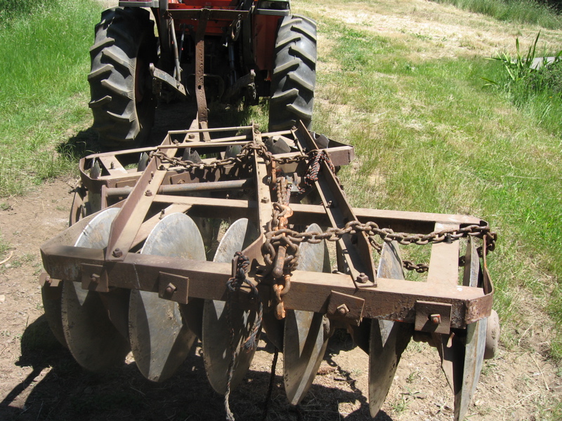

with all this talk about discs and rototillers, people with small tractors should know that there are real discs out there that actually do a great job. I am super fired up on this 4 foot, pull behind, offset bad dog, because it has transport wheels,brand new blades, really cuts deep, and has scrapers. It is supposed to have a hydraulic cylinder, but it started to bend the frame, so now it is Okie style with a chain and binder to control the wheels.

What size Disc's are those 24" ?
Are those Steel Transport wheels?
How Wide of tread foot print are they?
They look a little narrow, and with as heavy as that unit looks, it would be rather interesting transporting it in moist soft soil, I would think that it would sink easily.

the new blades are 22 inches, and steel wheels are probably 4 inches wide. the wheels are loud going down the gravel road, but they get the job done, this disc is so heavy that i can't pick it completely off the ground with the loader on my 30 hp tractor. I am not sure about the wheels sinking in wet soil, it is dry now. done for the season. I saw this disc from the hiway with a for sale sign. I have rebuilt most of it, except the lift.

troweller I like them. I like a discs that will cut . And that one will cut, it will get in the ground.
