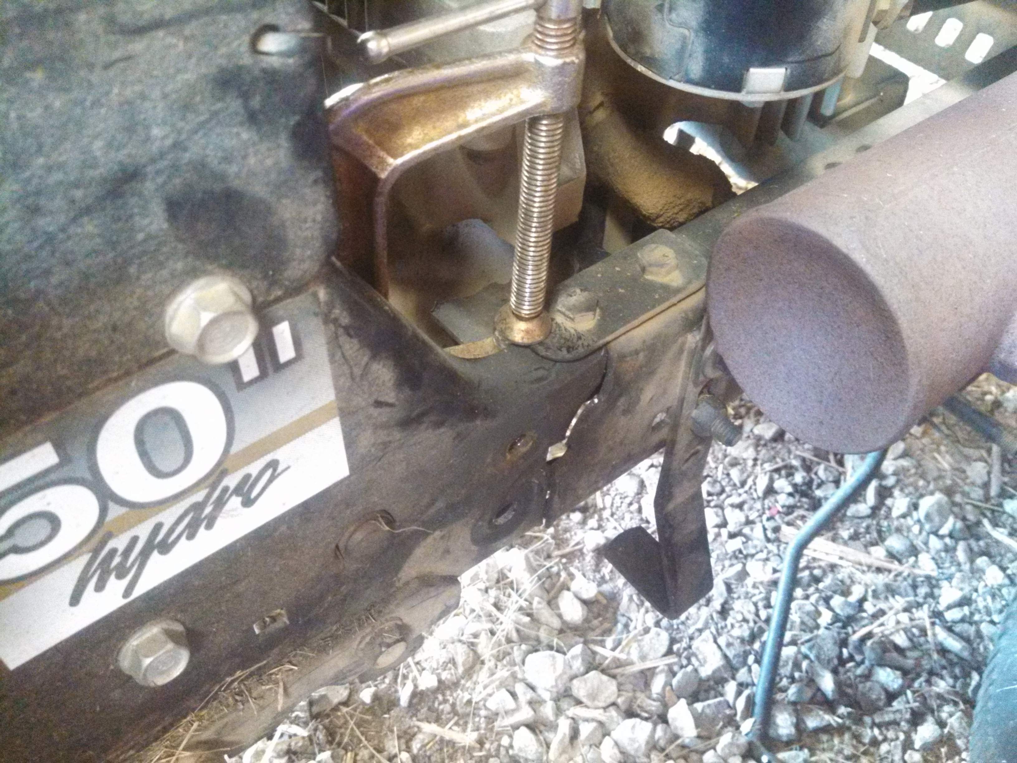

Despite my list of to-do projects, I couldn't resist tearing into this mower today. After all, it's just a few bolts here and there, right? It's not like I'm going to start welding it up or anything... (I may start welding it up.) As with many things, once I got a better look at it, the situation was a little worse than at first I thought.
The right side foot-rest was concealing a crack that I hadn't noticed before. I removed the foot-rest and the fender to clear space around it. So that's what that C-clamp was doing. I was kind of confused. The crack is in a similar, but not exactly the same, place as the welded-up one on the left side, so my best guess is the frame broke and the torsion from that was what cracked the engine mount. I think I will effect the same repair as on the other side: clean up the crack, groove it out a little, then weld it up, probably with 6011. Looks like I'll get to work on my vertical up! I may also put a piece of bar stock on the bottom, similar to what was done on the other side, as reinforcement. Even a piece of 1/8" would help. The engine mounting bracket is pretty thin--probably 3/32" I would guess. I can't really tell how thick the frame is, but I bet it's not much more.
I think, if I am very lucky, I may be able to slide the engine mounting bracket out of position without having to lift the whole engine off the mower. If I do have to lift the engine, I'm not really sure where the best lift-points are. I guess the mounting holes. Anyway... it should actually not be too hard a repair, unless I get more surprises. Famous last words...

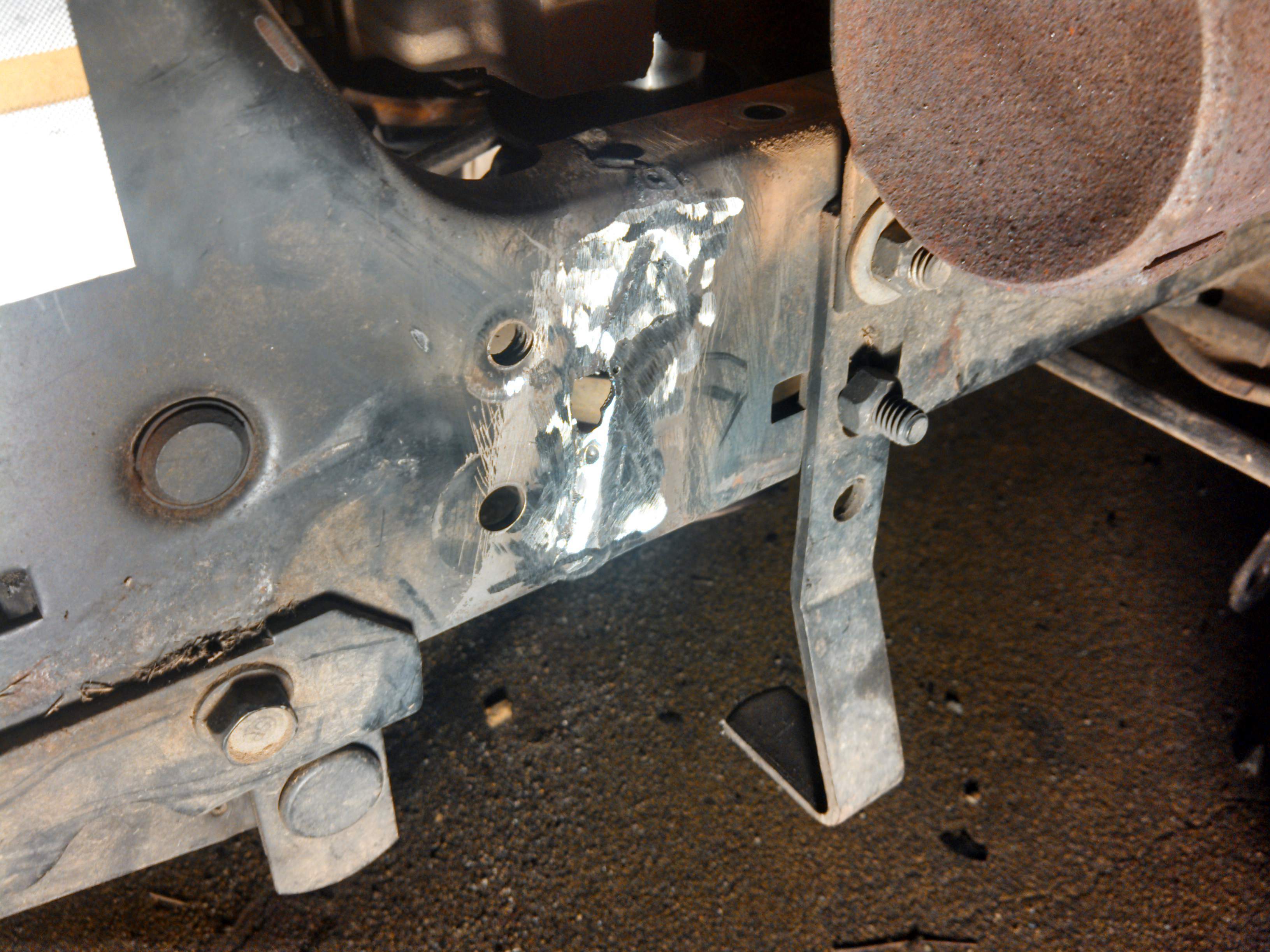

Ground clean and tacked.
I went ahead and welded it up but it was too dark by the time I was done to take a picture. Let's just say that vertical up is not my strong suit on a good day, and kneeling, bending over, looking down on the puddle instead of sideways at it... all of this was not a recipe for success. Mad props to those who do in-field repairs on a daily basis and make the welds look good doing it.
As bad as the weld looks, I know for sure it was full penetration, because I chased a keyhole all the way up! So... that's good anyway.

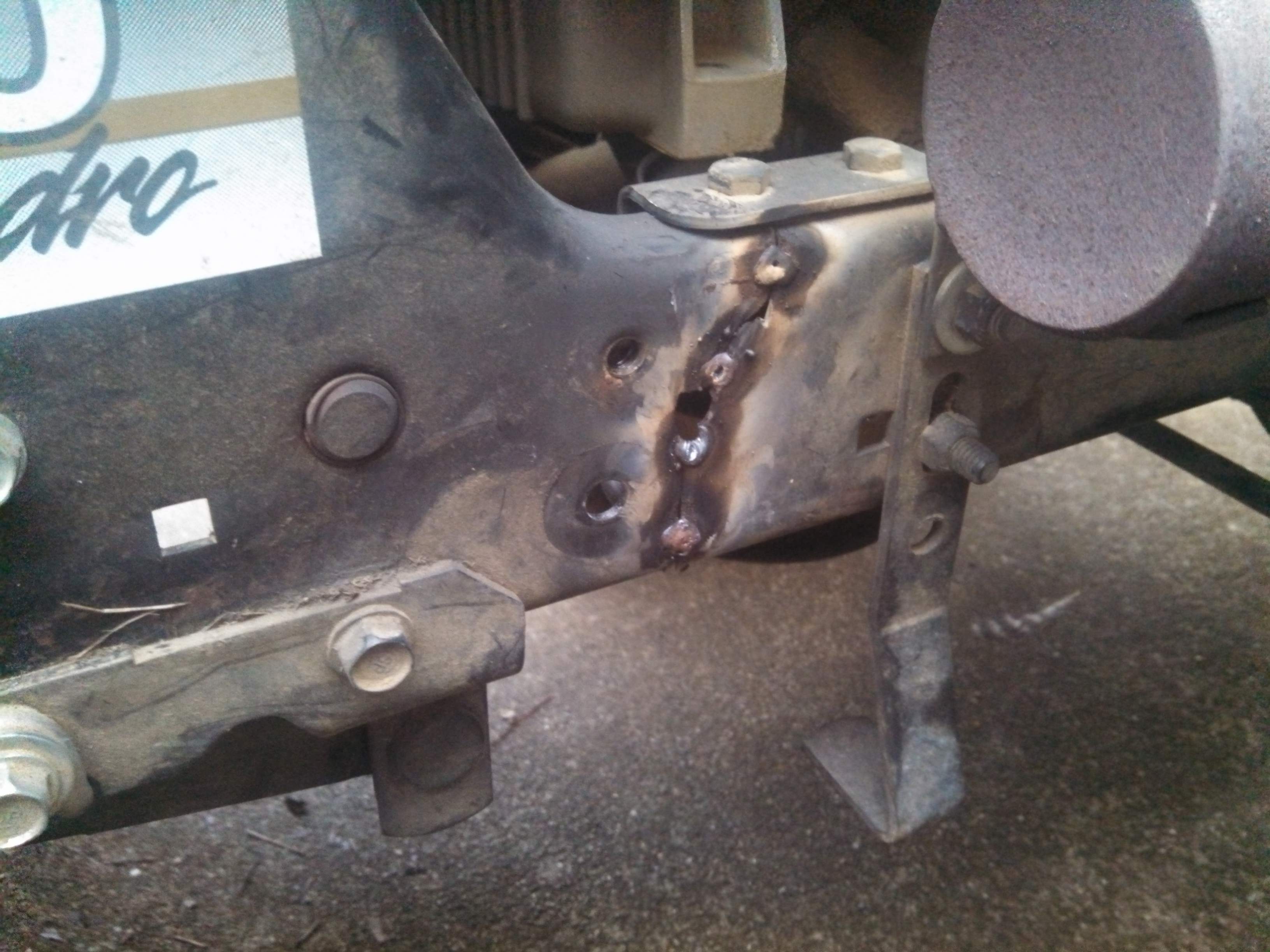

Strong remains to be seen. I mean, if it's full-penetration, it's probably at least as strong as the base metal, right? Unless it's full of slag or something. I dunno... I took a work light out and got a picture of the weld, before I ground it down.
I think I'm going to put one more bead on there before I call it a day. Maybe something a little smoother-running like 7018, now that it's not got a huge gap to fill up.

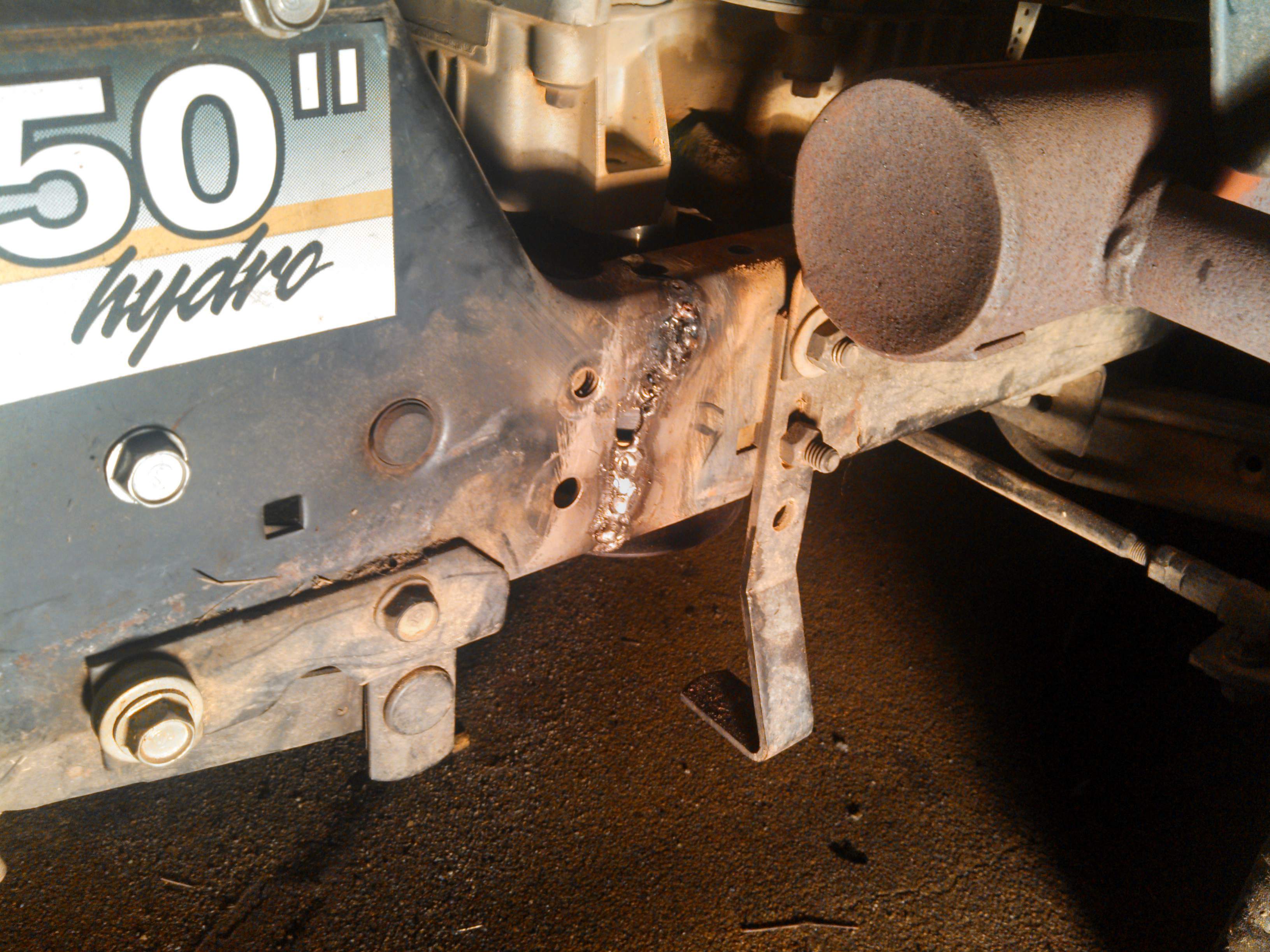

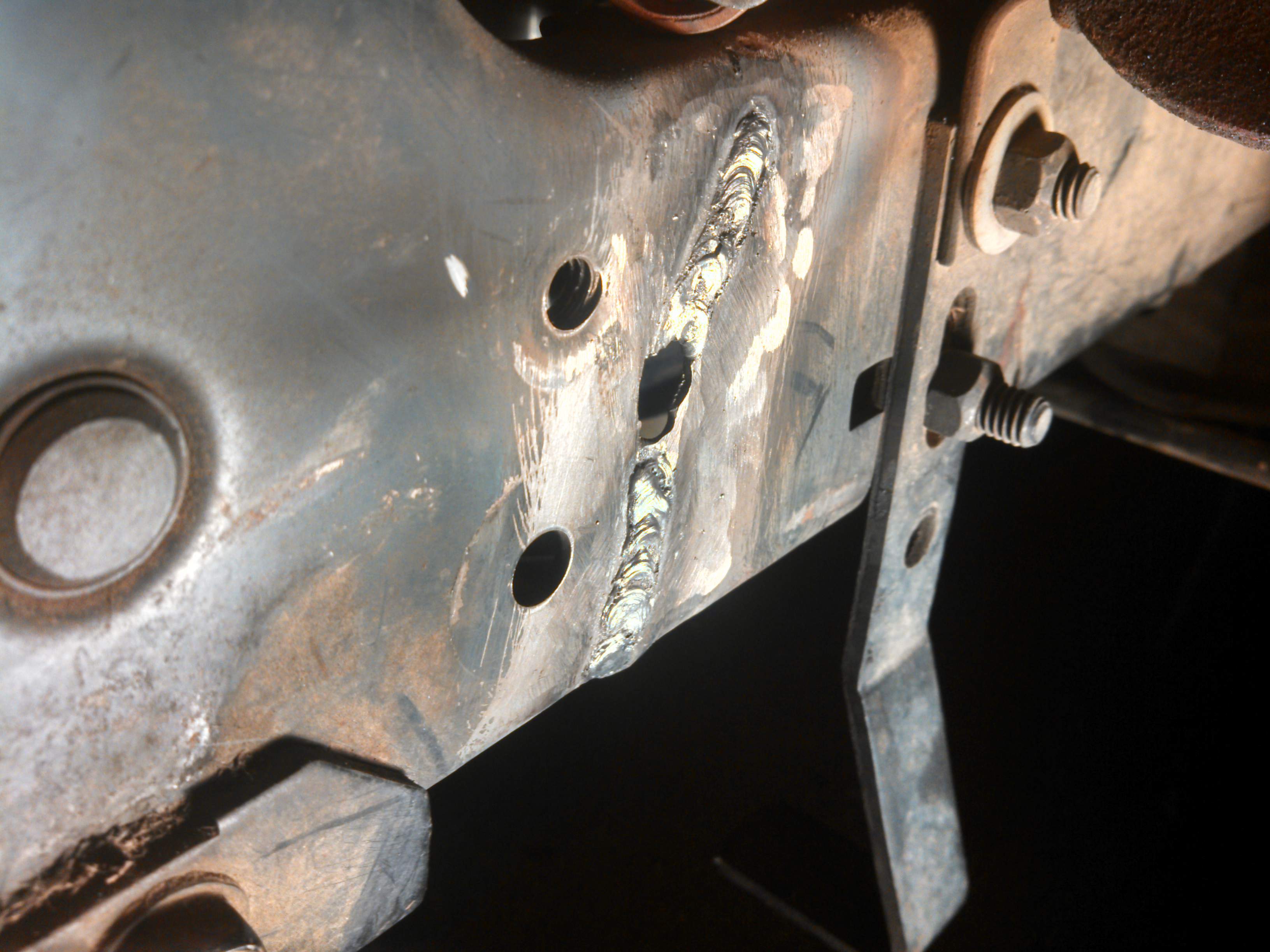

Ran one more bead, 6011 downhill at 75 amps, just to finish filling in the crack. Looks a lot better than the first one(s). Don't know if that's because of the switch to downhill or because I wasn't trying to fill up a 3/32" gap anymore.
I also used the rod to build up the bottom of the frame, where a crack is likely to start again, if it starts again. No need to cut a piece of flat stock and weld it on... I can just build up selectively with the rod. Duh.
   / This kind of neighbor is good to have! #19
Looking real good now.

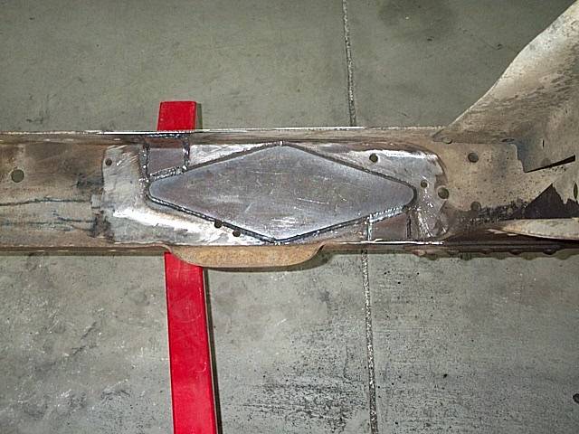

If you have anymore trouble out of it, you could always fish plate it.
