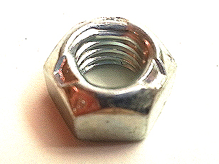

The nut that the adjuster screws into is classed as a "Locknut". It is actually a 'crimped nut' and not the common 'Nyloc'. (Part # M85516), Anyway, it is supposed to stay where it is set and if yours doesn't, take the issue back to your dealer and they should correct it.
There have been several areas of the lift linkage that have been modified since production began. Ask your dealer to search the DTAC system for all upgrades.
Some dealers have sold more X758's than others and the lesser experienced shops may not have had to get so involved with such repairs. Your issue 'should' be covered by your warranty still.

An engineer at my work told me that All-Metal-Locknuts were the most dependable. He called them squash nuts because the top 2 threads were slightly squashed in a press. Also, he said that all locknuts are designed to work once. The more often it is loosened and tightened, the higher the failure rate is.
