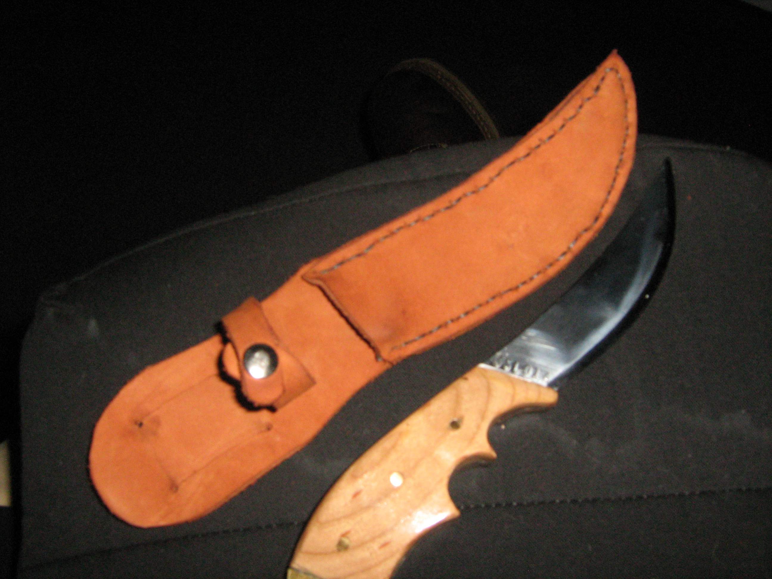

I too am interested in what you used to make the knife? A file? And where do you get your supplies from? Congrats on a great deer and a beautiful knife.
   / This years Deer
#32
Well I thank you for the compliment on deer and Knife.
Back in the mid 80s I was a saw filer for a large lumber company her in maine. I took home a peice of the worn out saw blade that I used to sharpen called "Sash Gang" There were 48 saws all 6 feet long all facing the same direction spaced 7/8 of an inch apart. They hung in a saw rig kinda like the same way a window sash is hung in this fashion they could saw a log up to 4' in diameter a one time and you would get 48 boards at once.
Anyway,.. I made a Machete and it came out ok and about 3 years ago I decided to try to make a knife from a piece I had left over. This is an extreamly high quality steel about 1/8 - in thickness and flexable.That first knife was perty dam crude let me tell you but I had fun making it.The knife you saw in the photo was number 14 or 16 ? can't remember.
As far as supplies I dont buy any really, I went back to the mill 2 years ago and asked for some worn out blades and got a few more. The wood, well that peice came from my wood pile ( fire wood that is ) It is a peice of cherry I think.I have used beach ,maple,ash,and easter white ceder(sp) The rivets are a short peice of 1/8 inch brazing rod with the flux knocked off. The brass came from a metal stamp buisness here in maine.I had the steel tested on thier rockwell hardness mechine it tested like 58 or so I think. The guy was so impressed with my knife work he gave me a few small sections of flat bar brass, about 2" long each. I used to work in the Tannery here at home and buy my leather there, scraps mostly couple bucks for a 2'x2' section or larger. I did have the hand sewing thread from a friend that used to hand sew Dexter shoes at home and tought me how to sew a little. If I can answer anything else just ask but to be brutally honest I am not very good compared to some but my work suits me well.I have also used bearing races for blades as well but that is another story all together.

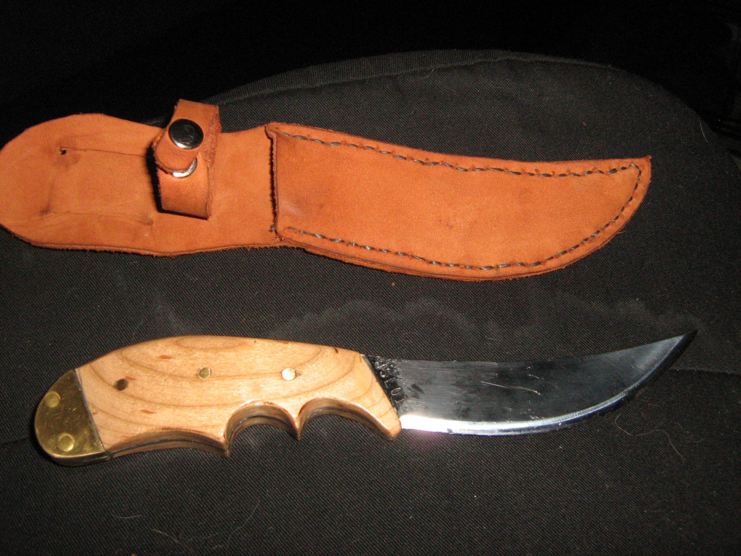

   / This years Deer #33
View attachment 287166View attachment 287167
Here are 2 photos for you hope they come through ok.
