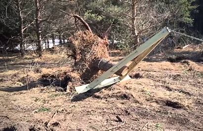

pulling up is better than pulling over - build a lever
