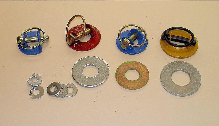

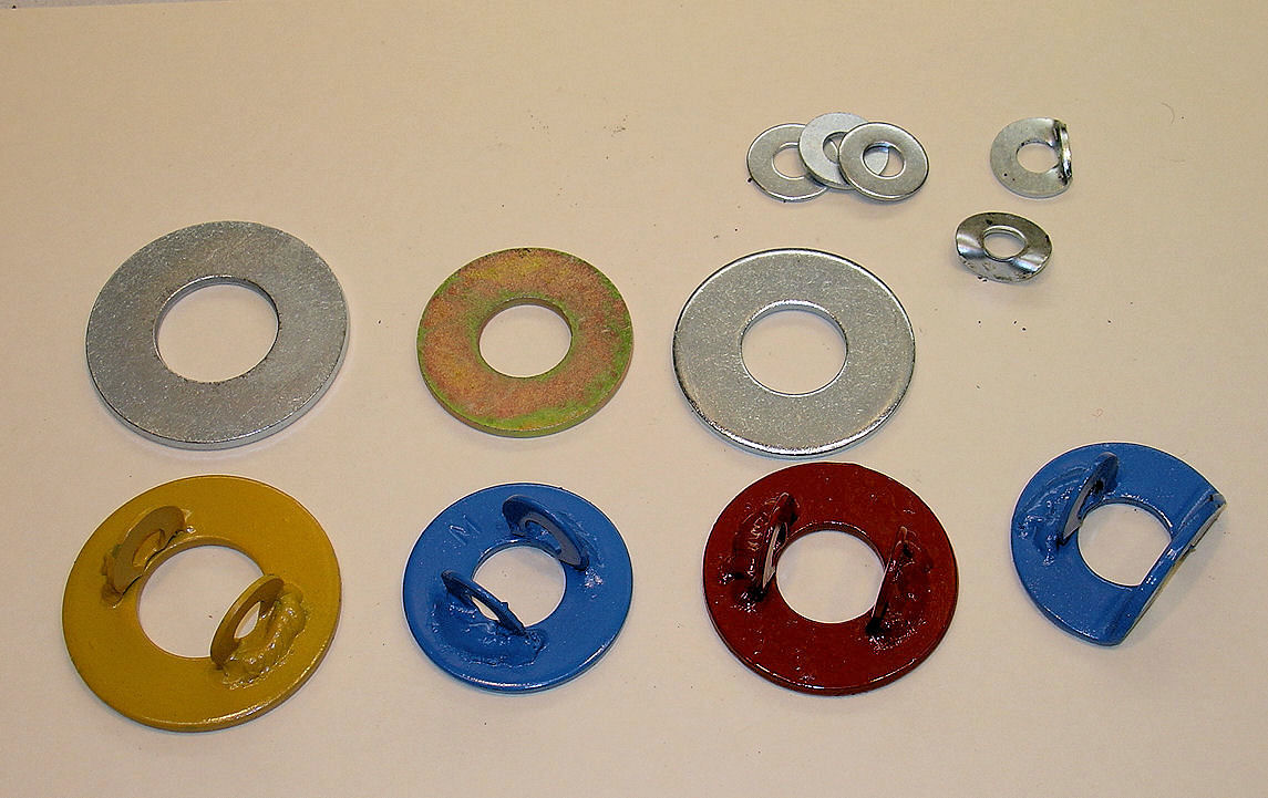

While at Tractor Supply, check out the black lynch pins. Those are super strong pins. I've not had one ever come loose but the zinc plated yellow ones have come off a couple of times.
Just don't get your finger caught in one while testing it.
Another trick is to put a large, properly fitting, washer between the pin and the ball.

View attachment 430888 View attachment 430889
This is the most genius thing ever. You win the interwebs today.
   / Those DARN lynch pins #7
Agreed. I also second the black TSC pins... the spring is very stiff and they hold on tight.
It looks like those home-made washers could also be used, coupled with a bushing, for quick attach bushings.

BTW... one more thing you can do that only requires drilling is to get a shaft collar for whatever size lift pin, drill a hole straight through it (use the set screw hole for the entry point), and then use a regular lynch pin or PTO pin to hold it on.
