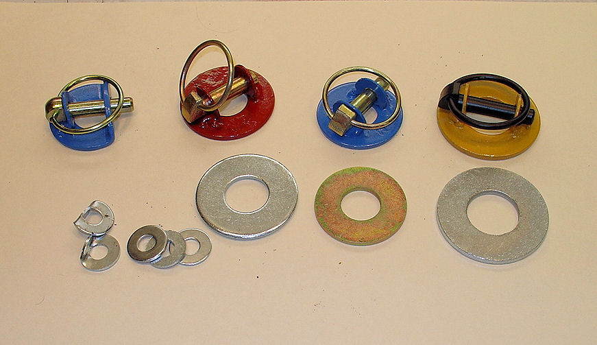

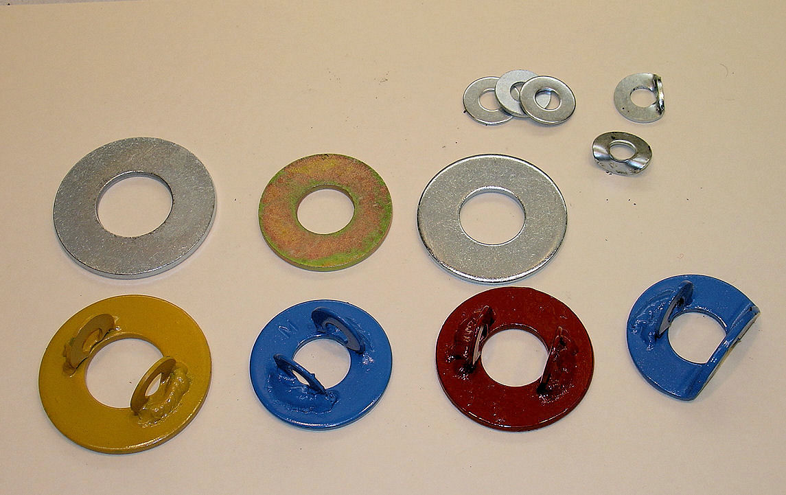

I made several pairs of the washered pins. They work great for hitching a QH to a pinned implement. Keeps the washer out against the end of the implement pin for easy hookup.

Another trick is to put a large, properly fitting, washer between the pin and the ball.
View attachment 430888 View attachment 430889
Lots of great info here. The HD black hitch pins will stay on seemingly forever. Five years ago I bought 10 to use on my tiller. I stll have 10.
On the washer thing--that's a genius idea and one I plan to borrow.

Regarding these 'bent' washers... I'm not familiar with them and, as far as I can determine, I don't have them on my tractor. What's the purpose?
I had several of them when I was using Carter quick hitches. If you have a Pats or Carters's or any other kind of quick hitch, the washer/pin combo as shown will keep the washer out there on the outer edge of the draw pin where it acts as a shoulder, that makes it easier/safer when hooking up and less chance of slipping off than just a pin alone. You just leave them on each implement all the time, as you are not slipping hitch balls over a pin now, you are just hooking the pins from below now. Make sense?

If you have a Pats or Carters's or any other kind of quick hitch..... Make sense?
Pat's yes, standard quick hitch no. Doesn't the rigid frame of the QH prevent and side to side movement and shouldn't need anything on the end of the pin anyway?
good point.
