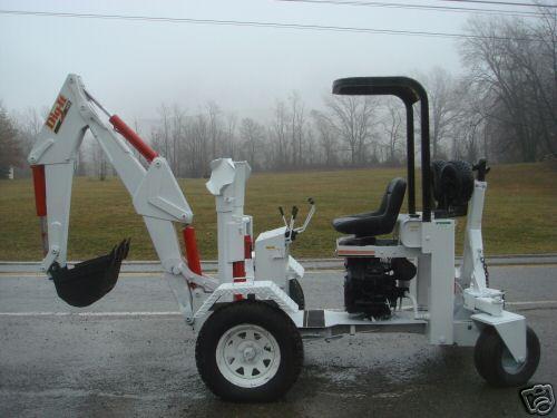

I have a hydraulic drive hoe and while it's not as nice as a mini-ex, it does have way more advantage than a strictly tow behind. I say go for it.

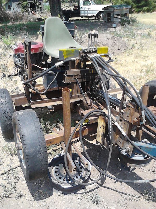

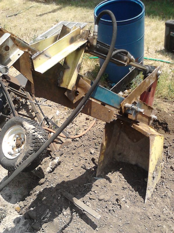

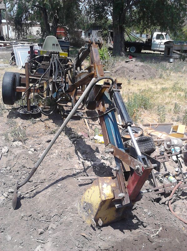

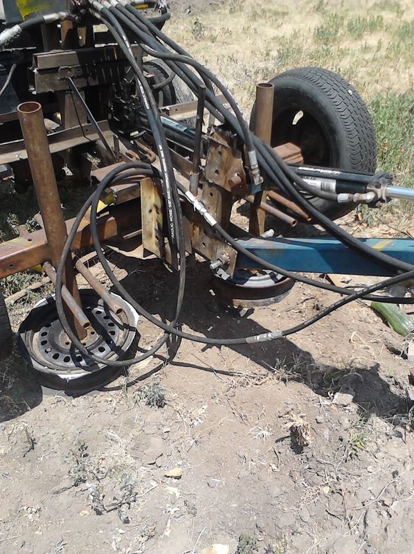

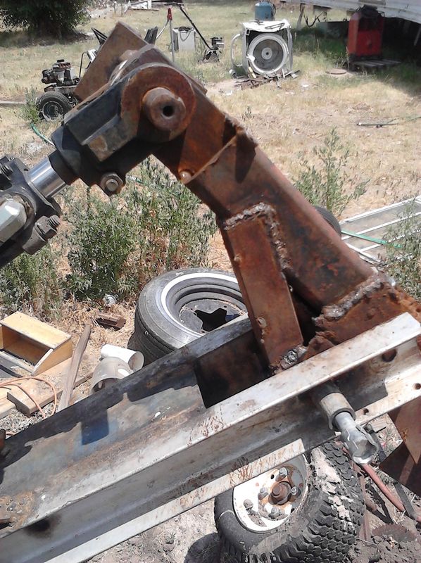

I just remembered I had some already uploaded in my attachments. So here they are. This is the excavator when it was in Kansas.
I'm gonna use that I beam that's attached to the axle. All it'll take to remove it from the axle is a few cuts through the welds holding it together.
That Ibeam is what I'm gonna weld in place of the flimsy piece in the middle. I'm gonna move the controls further up in front too.
When I get the front end steering components off the lawn tractor I'm gonna rig a way to lock the steering so I can tow it if I want to.
The transaxle will go in the back mounted to the I Beam.
Good thing about the sears transaxle I'm gonna use is the pulley is mounted to the side so I can get a Horizontal shaft engine which would make it much easier to route the belt to the transaxle at the side.
But I can still use a vertical shaft engine if I wanted to as that's what was on the mower when we got it. The belt was twisted from the motor and then back around to the transaxle pulley.
