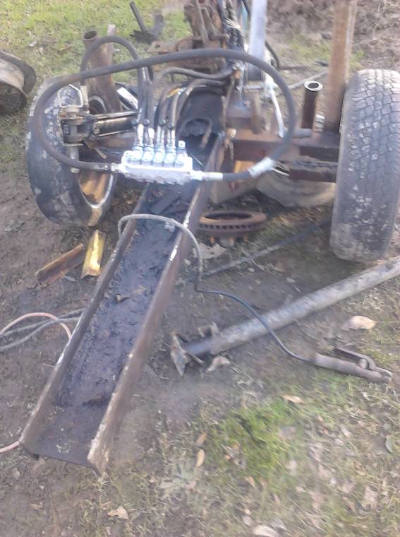

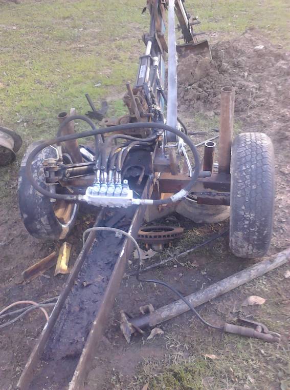

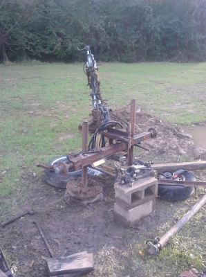

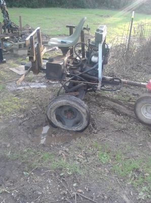

Got my new grinder in today so I went out and started cutting it with it right away. Had to play with my new toy "The grinder" lol
Here's a few pics I took today after I cut it in half to get ready to place the I beam in the middle.
The yard here is muddy. And it seems about the time it gets dried out it starts raining again and fills the yard back up.

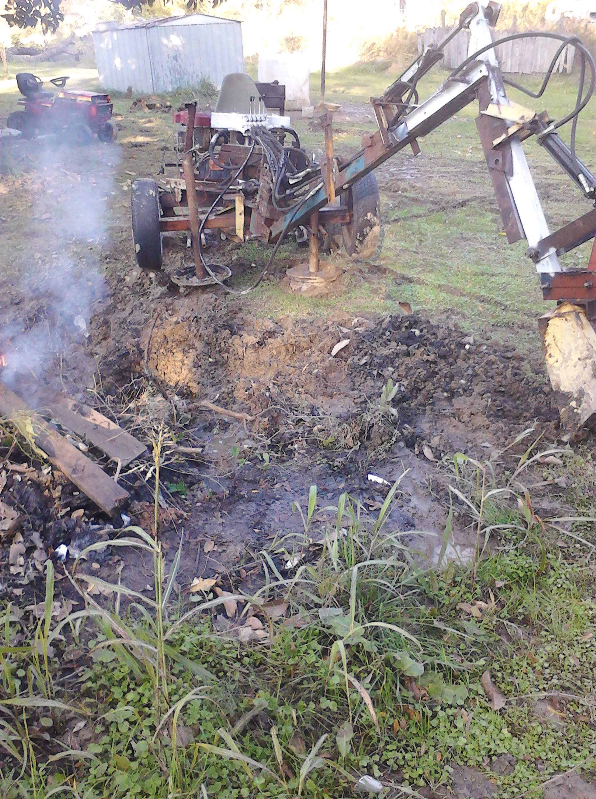

I was going through the photos on my android phone and found a pic I forgot I took.
It's a pic of it sitting by the burn pit I was digging.
I actually got to close to the pvc sewer line and ripped a hole in top.
I temporarily covered it with a plastic folgers coffee container. I cut the bottom out of it and cut it down one side and made it so I could slip it over the pipe and make a temp patch.
The attached pic is of the excavator before I tore it apart. And this pic was taken here in Cove Arkansas.

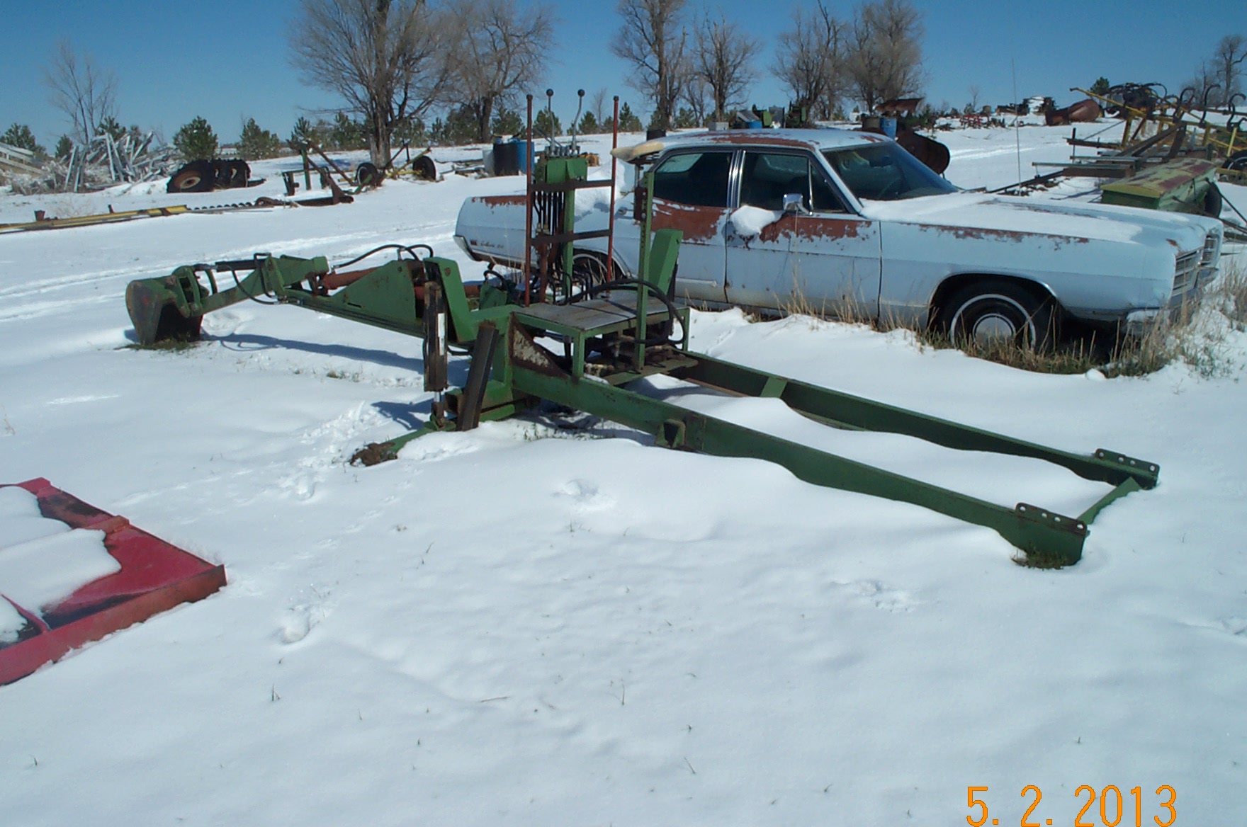

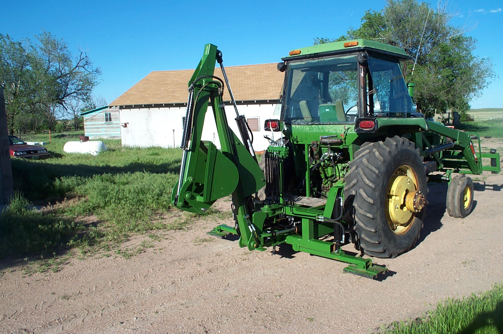

dumb question, here, but do you have a tractor? if you do you could build a under carriage for the hoe, and attach it to your tractor, mine takes about 10 to 15 mins to hook up and less to unhook.
I started out with the idea of making some what like you have a towable unit, and went through the same thought process of trying to figure out how to move it around, and ended up building it so I could attach to my tractor,
I have on the rear axel a clip that it sets in and then bolts to the under part of the tractors loader with two bolts, (original had it so the area where the real axel clips are could be bolted but found out it was not necessary, the biggest part of hooking it up is positioning it, or the tractor over it, the height and other is done with the hoes hydraulics, as putting in he two bolts is not a problem, usually if it is lined up right,
Nice Backhoe you got there BHD. :)
I don't have any tractors that I could mount it too. Otherwise that would be a great idea. I did think about mounting it under the old heavy built sears lawn tractor but figured I could use the backhoe for more projects if I were to make it driveable using the axle out of the mower.

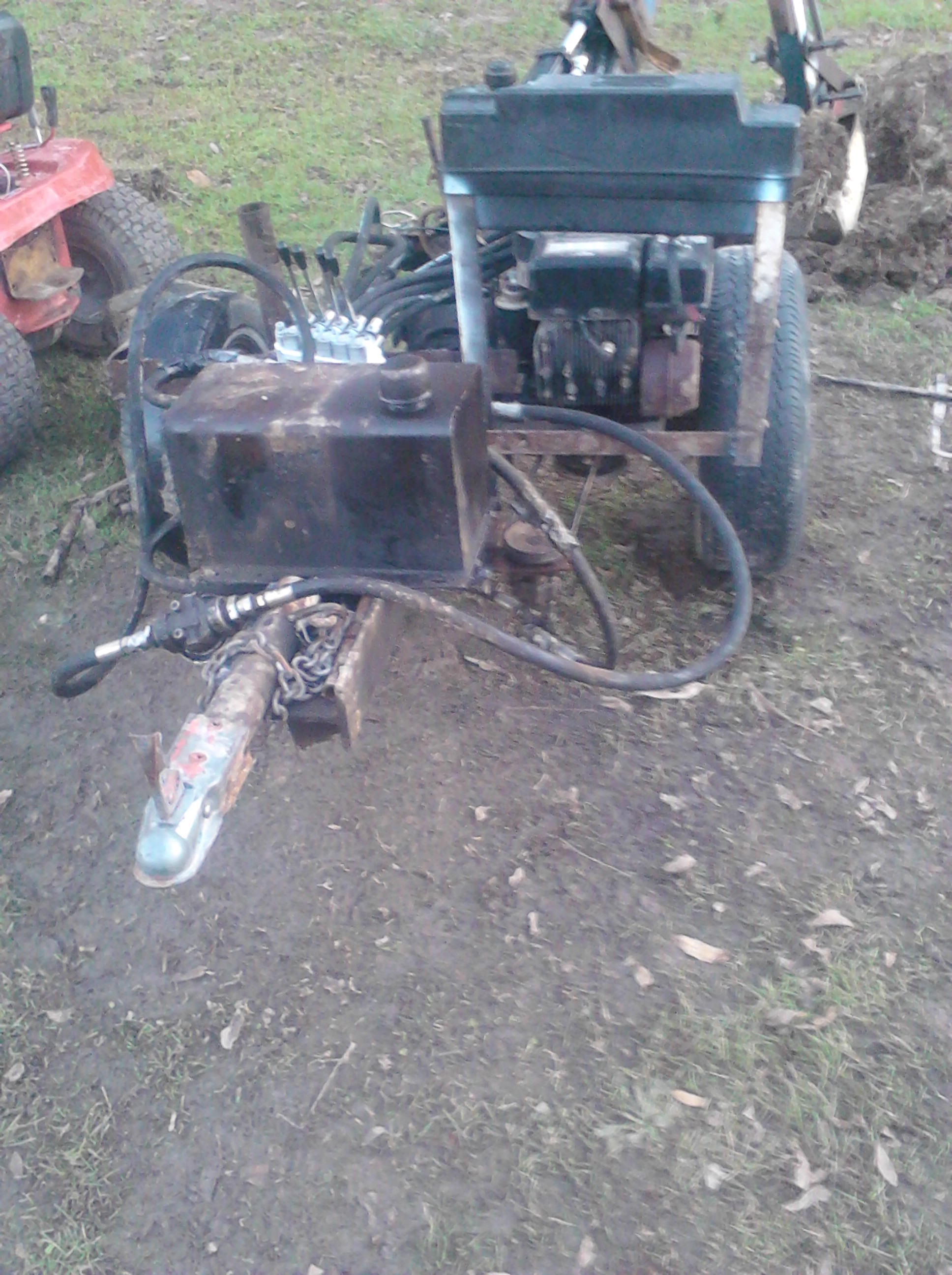

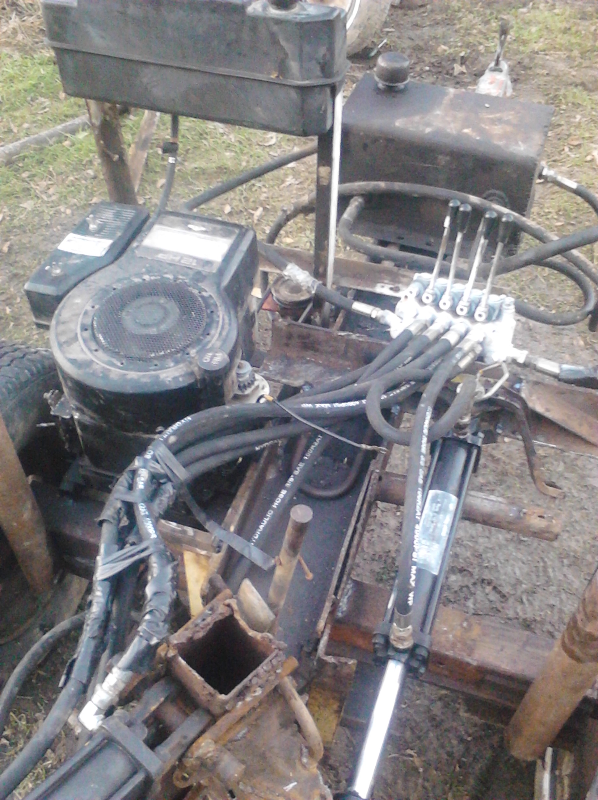

Well. I got the beam welded to the excavator and got the wheels dropped.
I cut the tubing where the hubs were welded too and welded the hubs underneath the tube
It raised it up to the right height.
I welded the hitch to it. So now I just need to get the engine mounted again and I can operate the hydraulics. It's already ready to be towed.
The attached pics are of it before I welded on the hitch.
I also temp welded that hand winch on to raise the boom up until I get the hydraulics going again.

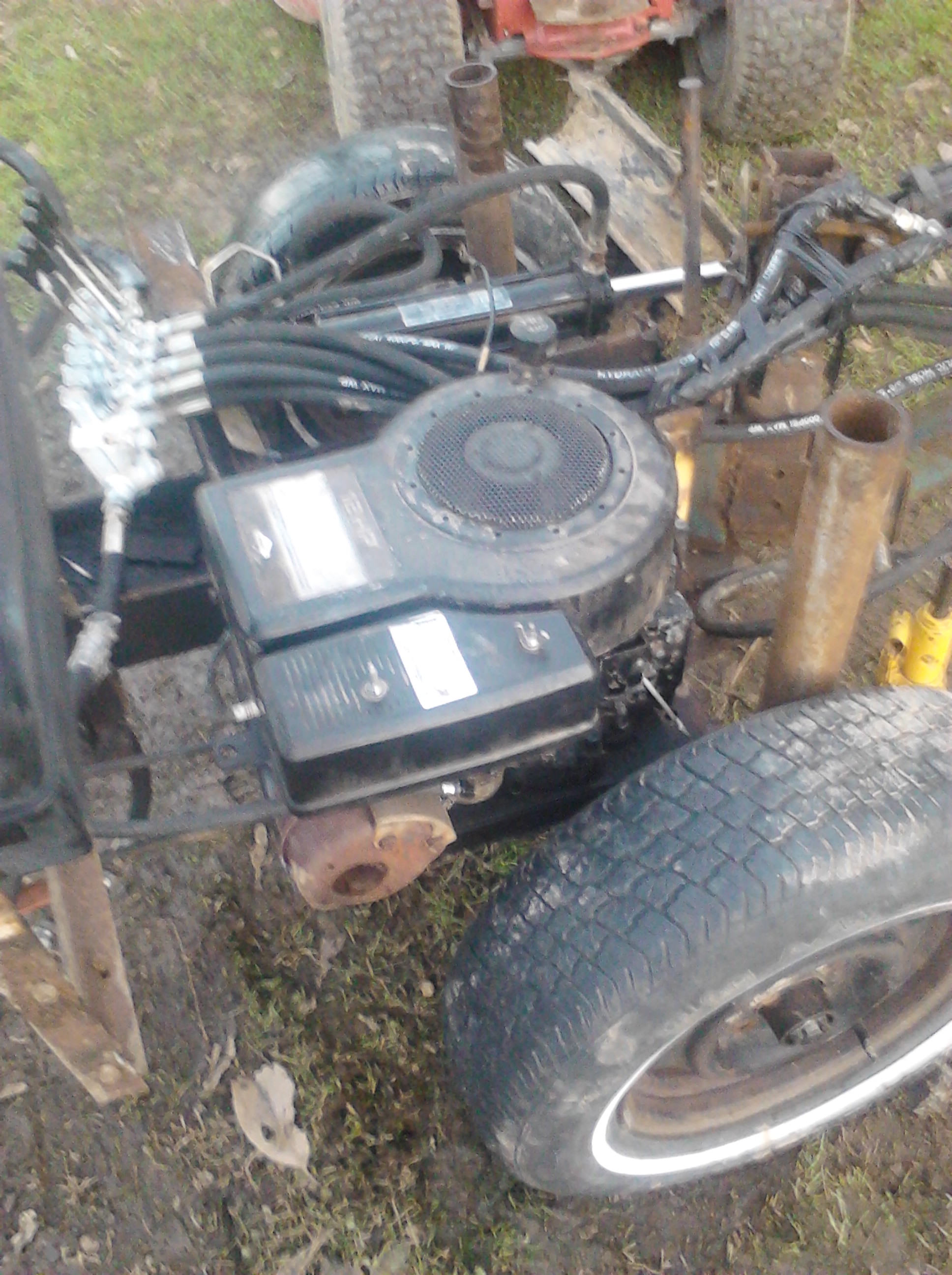

Here's a few pics I took today. The engine is now at front. I put a different engine on it. I had the engine laying around and it doesn't use as much fuel as the opposed twin.
And yes that ball couple is tilted and not sitting straight as it's bent so I had to purposely weld it at a slight angle like that. I jackknifed the excavator one day and bent the hitch. But it'll do for awhile until I replace it.
I bought those safety chains around 6 years ago and never have used them until today. So I figured I'd weld them onto the excavator.
Those chains aren't coming loose nor is the hitch. I've welded those suckers on good using my 180 amp arc welder set at 160 amps.
I almost melted the chain link into. But I stopped before I did. I had a friend who does professional welding look at it and he agreed those welds are some good welds.
