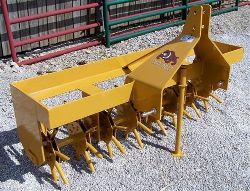

Would our 5 Ft Dirt Dog at $1875 be competitive? Ken Sweet dirt dog 5 ft core 1875.jpg
