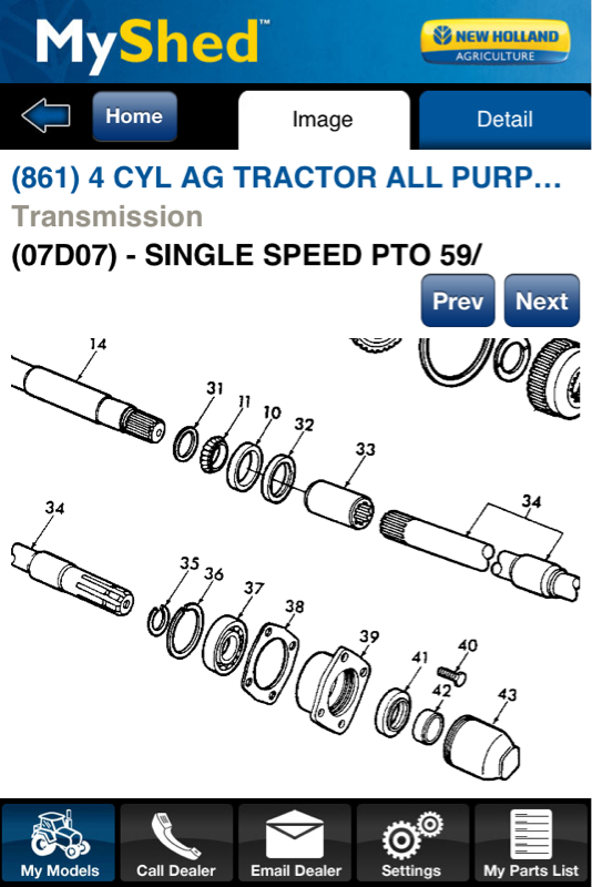

ps.. you should have the large and long stub shaft correct?
   / Thoughts on Ford 861 #32
Here are some screenshots from my NH iPhone app showing the part numbers that I believe you are looking for:
   / Thoughts on Ford 861 #33
that sleeve i believe has been superceeded by pn: 83964336
Do you mean one long shaft instead of two with a coupler? I am not sure, but the tractor is a '58, so I think it is the one long one.
Perfect! Thanks Chris! That is just what I needed!
Also interesting that the CNH website does not show the diagram on my iPad, but does on the computer. Lesson learned. May have to get that app.
no such thing as 2 with a coupler.
hit the parts site. look at that superceded sleeve number..e tc.
