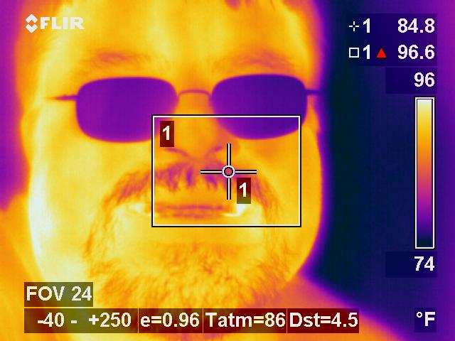

The quick answer is yes it would make a big difference if installed right. The long answer is as follows. Putting a reflective barrier on the under side of the rafters would work well to stop the transmission of radiant heat. Heat transfers 3 ways conductive, radiant and convective. You would be changing the transmission of radiant heat by placing a barrier of poor emmisivity between the hot roof and your attic. Emmissivity is the ability of something to emit radiant (Infrared) heat and the lower the number the less it emits radiant heat. A good example is to take a large polished stainless or polished aluminum pot and apply a 4" X 4" square of electrical tape to the side of it. Taking all of the safety precautions not to get burned(safety disclaimer), fill the pot with water and bring to a boil now take a non contact Infrared thermometer (point and measure) and take the temperature of the shiny metal area and compare it to the area of black tape. The area of black will be giving off a lot of radiant heat and the areas of shiny metal will be giving off very little. Black electrical tape is a good emmiter of radaint and shiny metal is a poor emmiter. oh by the way do not touch the hot areas the shiny metal and black tape will be the same temperature to the touch(conductive). I know how everybody likes pics so I have included a few of the above mentioned demo taken with an Infrared Camera. I also included a pic of myself for those of you who dont know what I look like.
