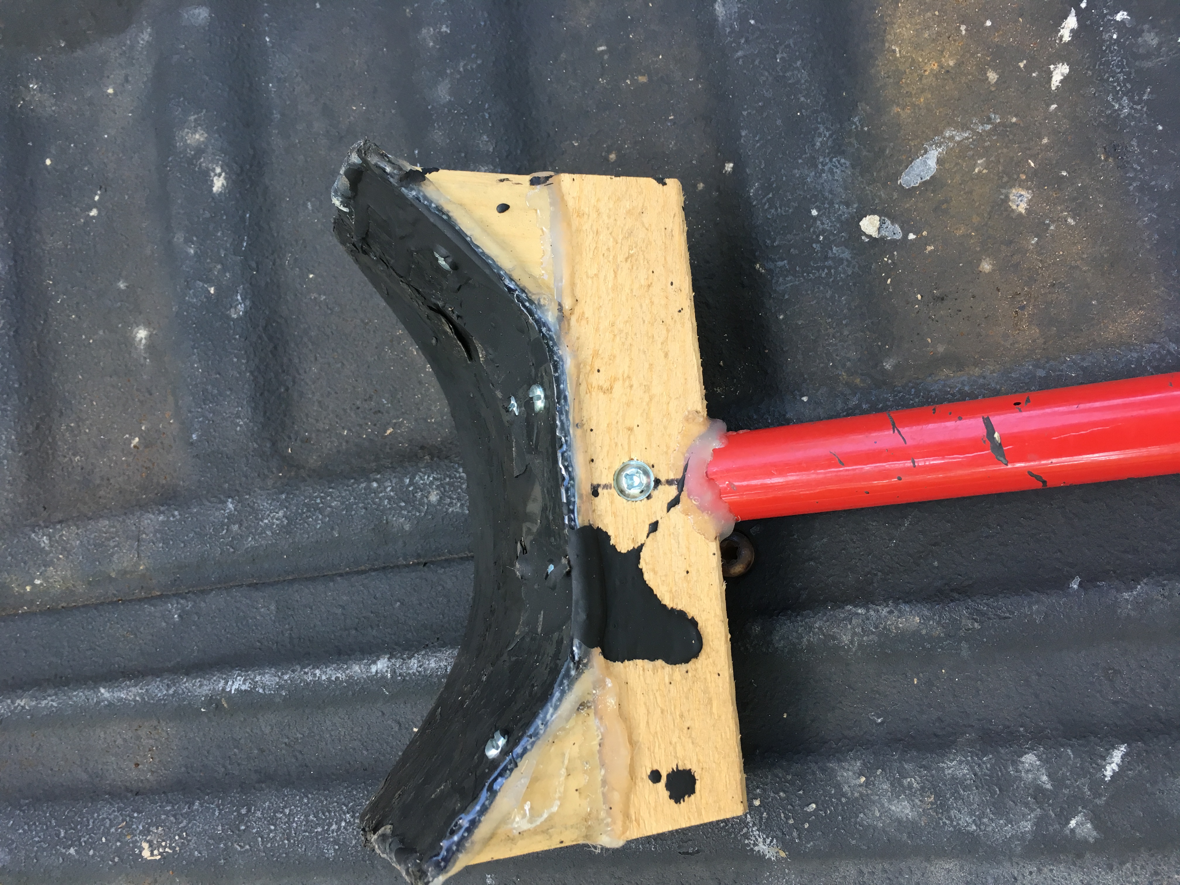

We are in the process of getting our church parking lot ready to seal. A lot of cracks needed to be filled so I made this little tool to make it a whole lot faster. Someone goes ahead pouring crack sealer while you come along squeegeeing the filler into the crack. Works really well. Used a scrap piece of belting on some 2x2 blocks and an old broom handle.
