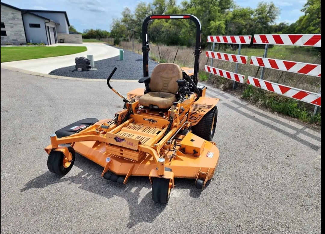

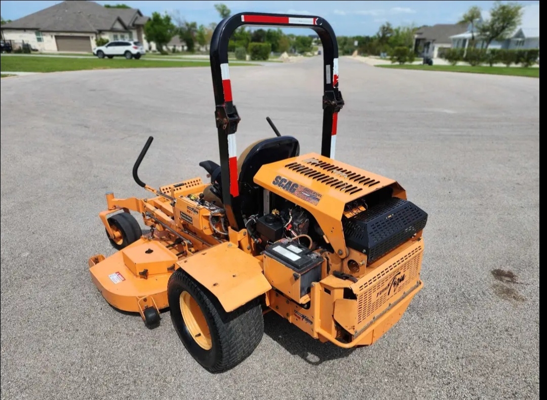

Asking for my uncle:
Anyone have experience with Skags or Kubota gas engines?
2014 72" Scag Turf Tiger with a 3 cylinder Kubota liquid cooled engine, 900 hours.
Owner states it is down on power and believes it to be the distributor.
Would like to hear others experiences before purchasing.
I am not 100% sure what engine it had but could find out.

I didn't know Kubota made a 3 cylinder gas engine but what do I know.
   / Thoughts on Skag with Kubota Gas Engine #3
That’s a Kubota dual fuel LP and Gasoline engine. I fear sellers always “believe” it’s the cheapest fix possible, but they are unwilling to do it… because it’s more complex.

They are unique. You would probably find the Kubota dealer is the only game in town for repairs. Maybe run it by them.
   / Thoughts on Skag with Kubota Gas Engine #5
At one point in time Kubota made a 3 cylinder liquid cooled iron block gas motor that was basically identical to the diesel 3 cylinders except they were gas.

Does the Kubota gas engine actually have a distributor? I never seen one on a small engine before. If there is a power issue with the mower, it's almost always fuel related. Filters, fuel lines, or even the choke being out of adjustment, are probably where you'll find the problem.

My comment on that motor is, good motor but thirsty!!
