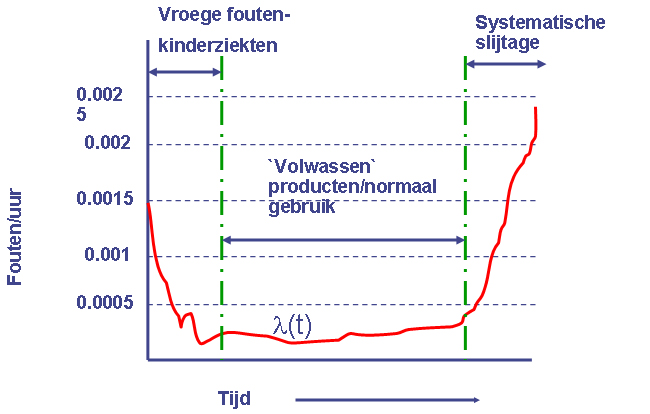

This "bathtub" curve is an illustration of typical automotive/construction/farm machinery reliability. Failure rate is higher at the start (infant mortality), then proceeds at a stable "random failure" rate until end of life (wearout). The warranty is there to resolve the problems in the infant mortality portion of the curve.
Your tractor and its components were designed by humans, built by humans, and assembled by humans. Humans are not infallable. That is why you have a warranty. Have it repaired and be happy you got a new tractor with a warranty so the dealer can resolve the problem. Splitting the tractor is not a problem if done right. You will likely be surprised at how many tractors are split before leaing the factory to repair a problem like yours that was discoered on startup - and you would neer hae any idea that it happened as painnt covers all wounds.
