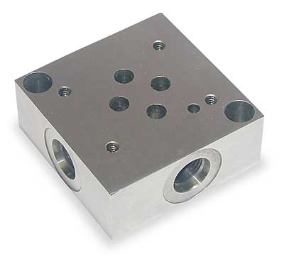

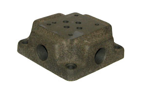

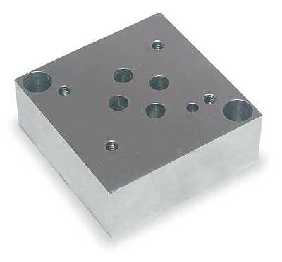

Here is a picture of a DO3 sub plate. Just bolt the solenoid valve on the sub plate, and the ports should be labeled. It can only go one way. Observe the protrusion on the bottom of the valve. Unless the wires are color coded, I don't think it matters. Put a fuse or CB in-line with the 12v going to the toggle.

Well that figures, My subplate looks like the first pic you showed, cast. But it doesn't have the extra little alignment dowel or hole like the one in the pic. The valve does have the hole in it. Thanks for the info J. J. I'll do some more research. :)
I found this , looks as if the alignment hole should have been between the P port and the B port So I hope that is correct.
http://www.sourcefp.com/products/pdf/man/SFP_man2.pdf

Here is a side port,and a bottom port subplate.These are from Grainger.
