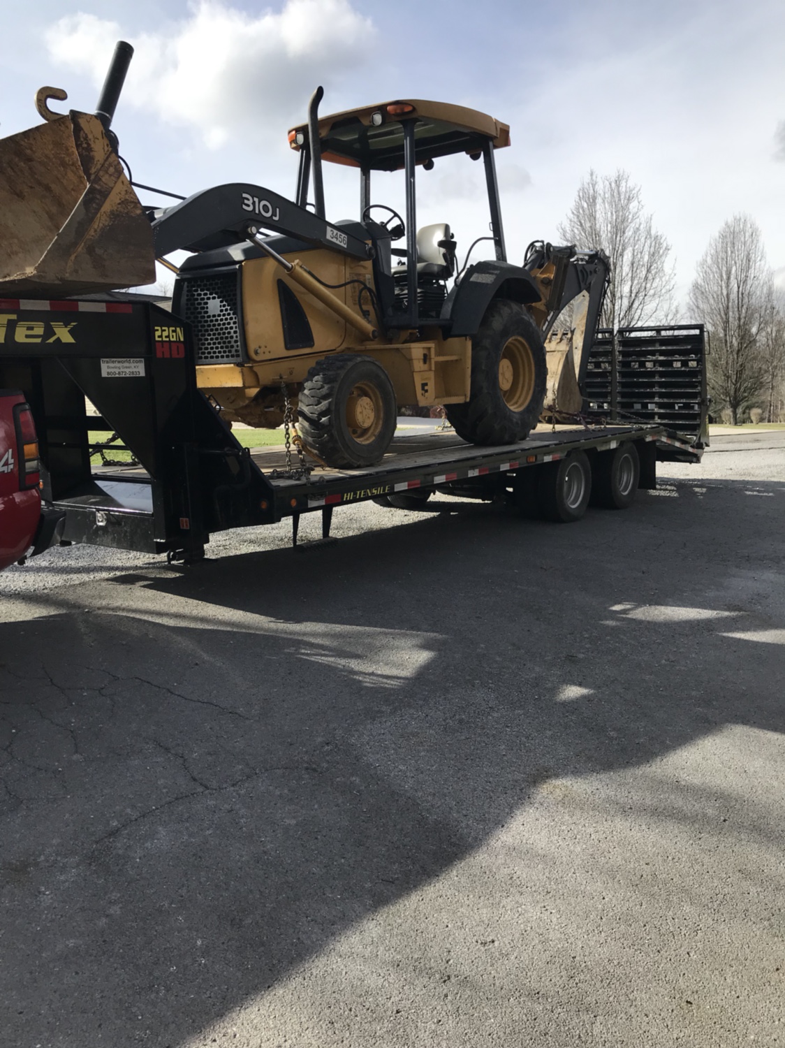

I’ve pulled over double that much with a Duramax and a Allison on a GN. There’s zero sway and I can load the hitch as heavy as a want without compromising the truck steering. There’s no way I’d put the backhoe on my current pintle hook trailer and pull it with the 1 ton truck. A BP is a much less stable rig and a lot more sensitive to loading. ATTACH]608170[/ATTACH]

A GN will be much easier on the truck, No way I'd want to pull that kinda of weight with a BP. Not saying won't, but a GN would be more stable.
The truck you have isn't the issue here, it will pull a house.. I used BP for years till I saw the light and got a GN..
