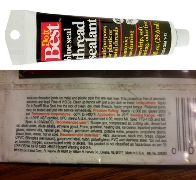

Does anyone know if Loctite Blue 242 thread locker is OK to use on fuel systems? I'm replacing the fuel shut off on my generator. It screws into the bottom of the tank. I used to have some thread sealing tape that was approved for fuel system use, but can't find it. I'm hoping the Loctite stuff is OK to use, but nothing on the label mentions gasoline.

I use this stuff on all fuel related threads. Lowes here carries it. Might try auto parts stores. Comes small squeeze tubes as well.

If you are trying to seal pipe threads, a thread locker formulated for threaded fasteners is not the right application.
I'd use a teflon based thread sealant. And, use it sparingly keeping it off the first two rows of threads on the fitting.

Blue loctite is for threaded FASTENERS, not pipe joints. I'm sure Loctite has a product that is meant for sealing pipe joints containing gasoline.
