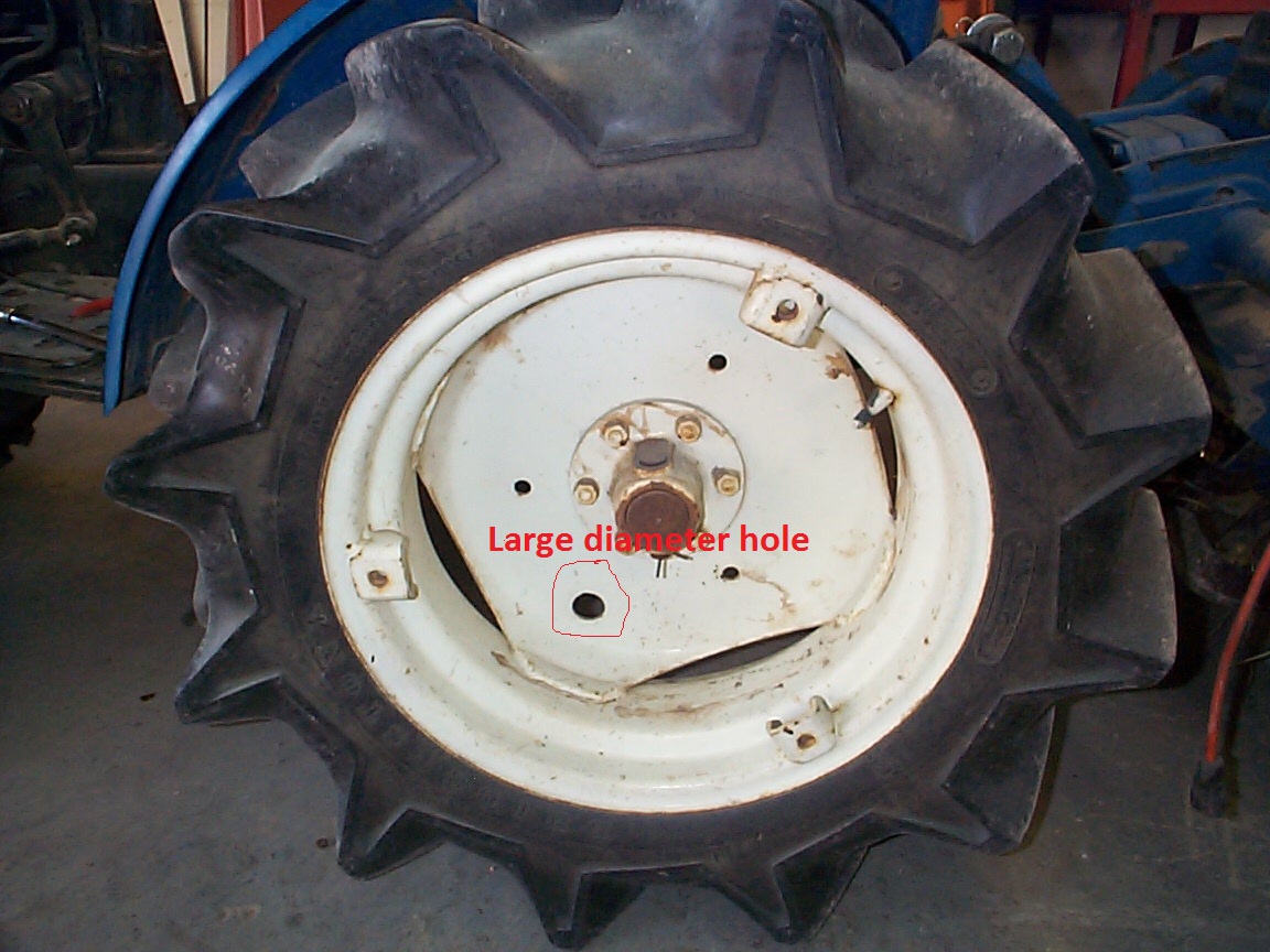

2: Replace the crossbar. You have to simply remove one rear tire(remember the bolt that holds the tire on is behind the tire, not the lug nuts exposed on the rim.)
Mitch, you do not have to remove a tire to change out the crossbar, if you have the single larger diameter hole (see my picture) in either of your rear wheels.
Once you align larger hole in the wheel to the crossbar, the crossbar will push thru the hole.
   / Three point hitch hook up help please! #15
Thanks! Thats actually very helpful, and I feel a bit dumb, I wondered what that hole was for. I always figured it was part of the wheel weight mount, but that makes perfect sense now. I am going to try that tomorrow, and as long as mine is not bent too badly, it should fit perfect. They were originally paired with a rotovator in Japan that required that you remove lift arms and that would make it much faster. Thanks again!
