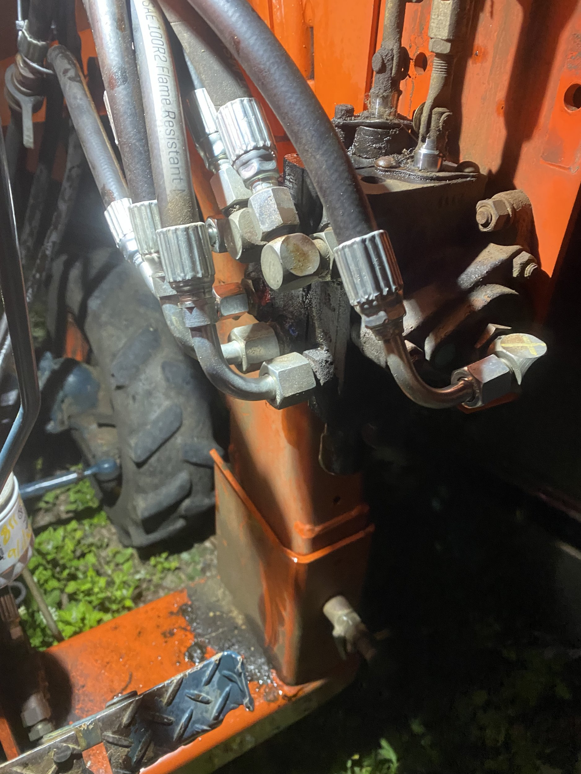

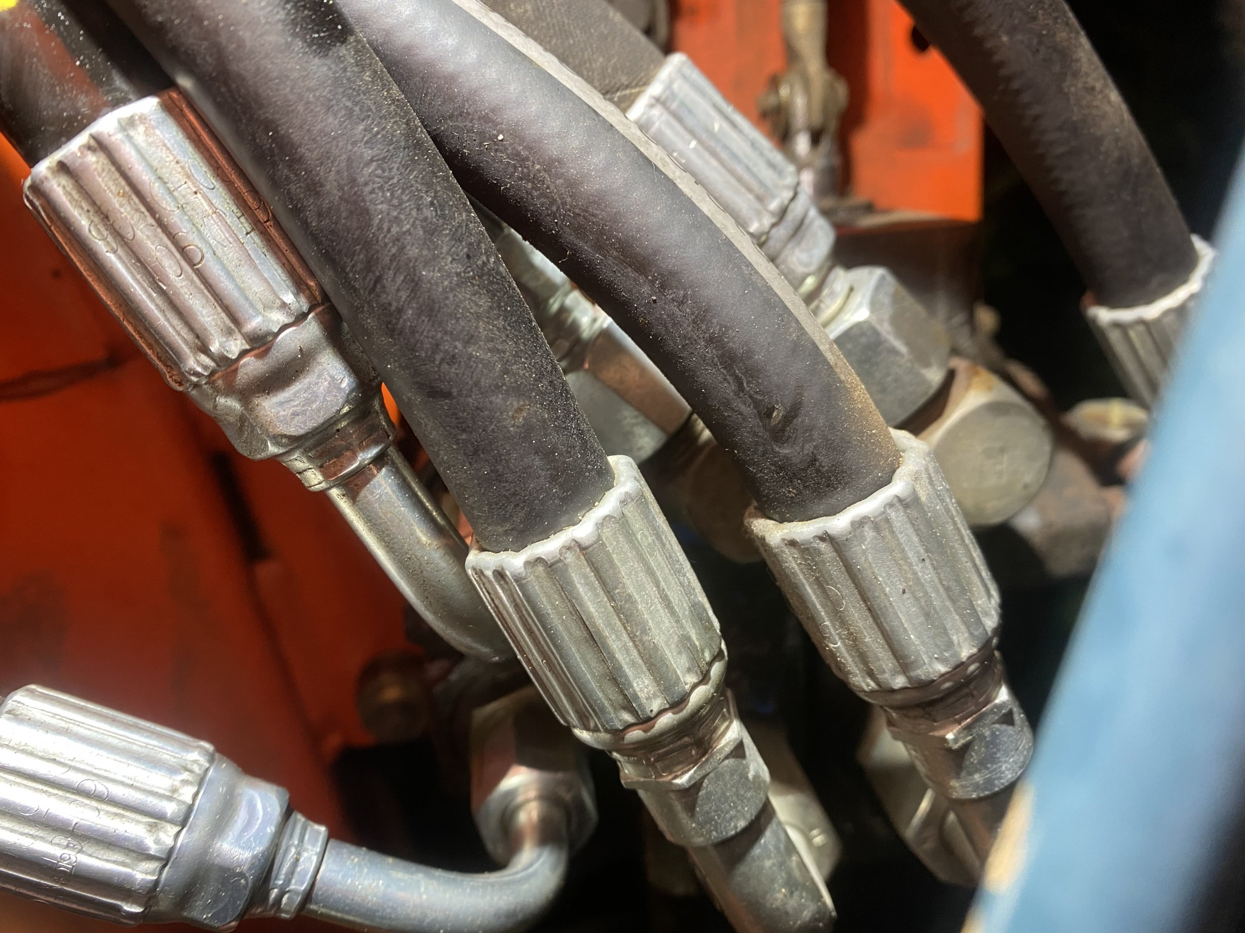

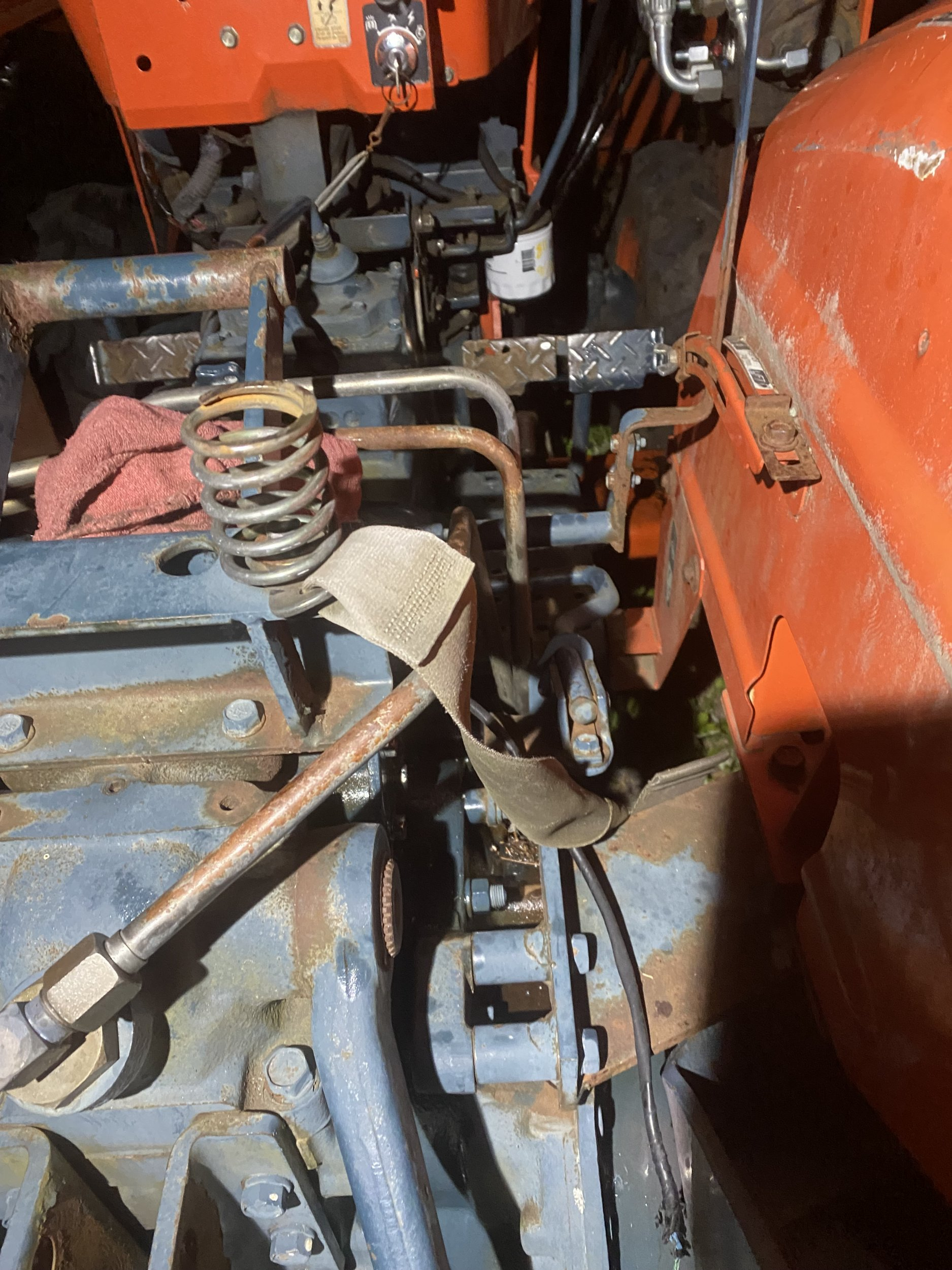

IT'S A 7 LINE VALVE I SWAPPED THE LINES THAT RUN FROM THE LOADER BLOCK ON THE SIDE TO THE 3 POINT TOP COVER AND IT ALMOST STALLS TRACTOR. ONE THING NOTED IS THE LINE TO THE TOP REAR OF THE 3 POINT AREA NEVER GETS FLUID TO IT NORMALLY. A LITTLE WENT THERE WHEN THE BUCKET IS CURLED. I ALSO PULLED THE CAP AND VALVE ON THE LEFT SIDE RIGHT UNDER THE FEED FROM THE PUMP. THE SPRING IS GOOD AND THE VALVE IS FREE. NO DIRT CORROSION OR WEAR. I DID NOTICE THERE WAS NO TENSION ON THE CAP WHEN I THREADED IT BACK IN FROM WHEAT SEEMED TO BE A VERY STOUT SPRING
THE LINE AT THE REAR OF THE FEL CONTROL VALVE GOES TO THE REAR OF THE LOADER VALVE BLOCK ON THE SIDE OF THE 3 POINT HOUSING. THE LINE AT THE LOWER FRONT OF THE FEL VALVE GOES TO THE FITTING ELBOW ON THE TOP REAR OF THE 3 POINT KIND OF BETWEEN THE ARMS THE OTHER LINE FROM THE LOADER BLOCK ON THE 3 POINT UNIT GOES TO THE OTHER BOTTOM FITTING ON THE FEL
