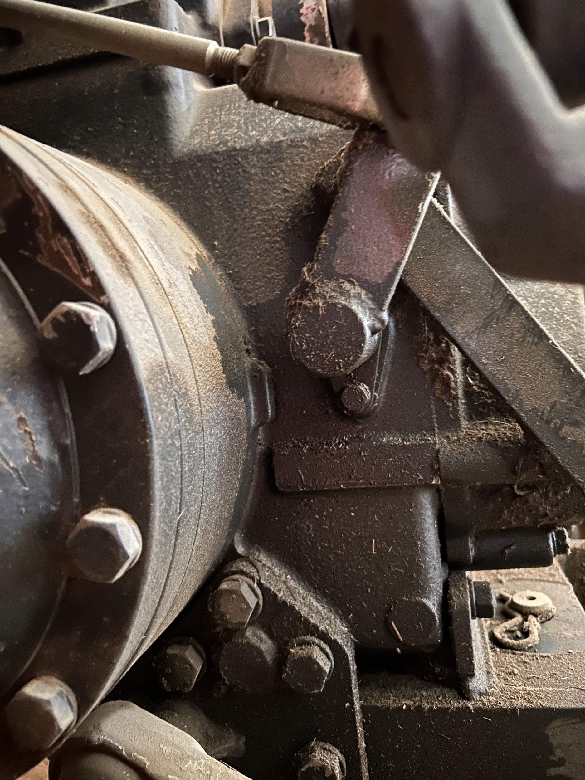

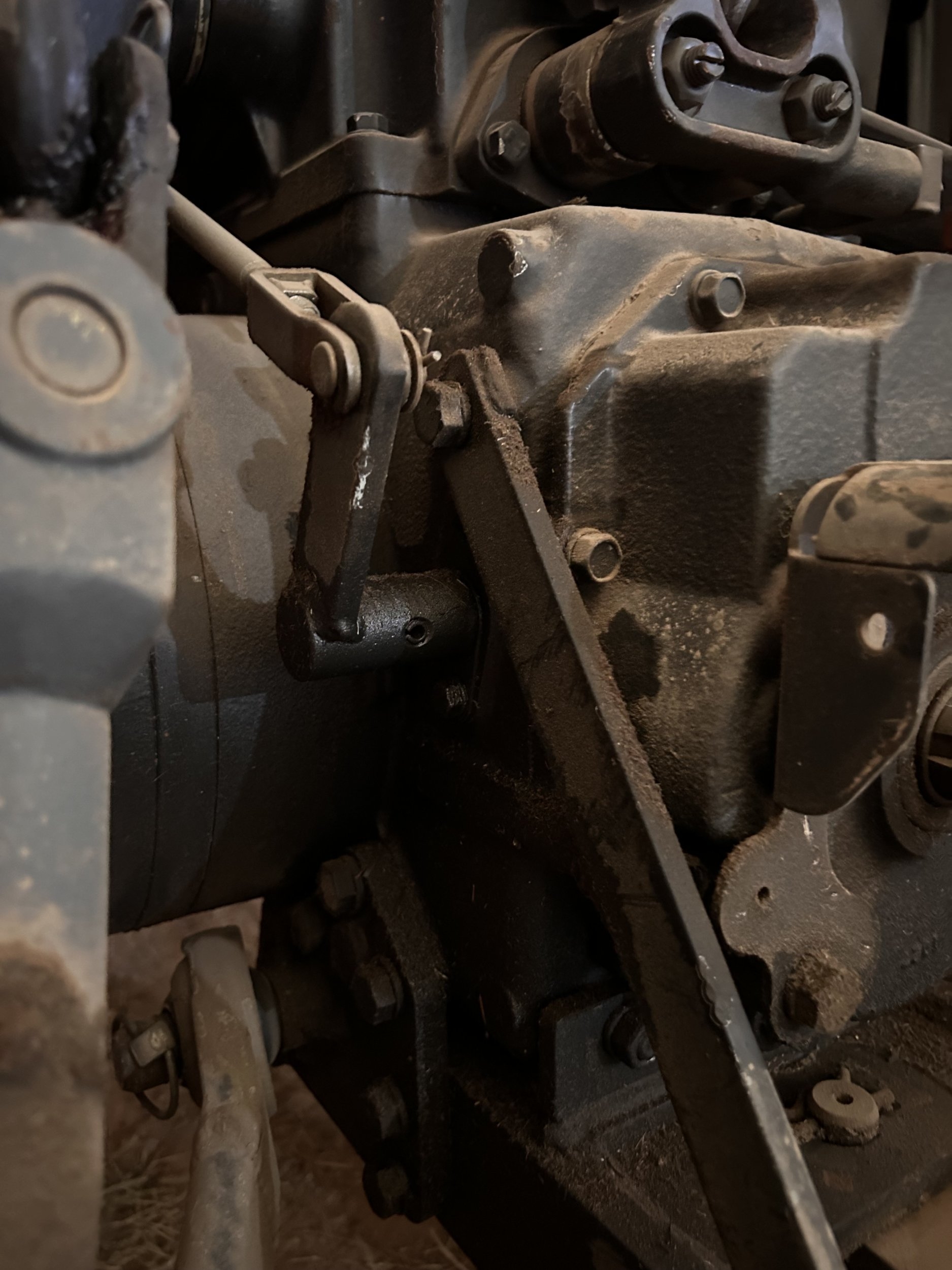

Hello all. I am looking for some answers to where my leak may be coming from. My three point hitch leaks down when not in operation and when it’s in operation it hiccups. The only noticeable external leak I can see is where the PTO shifter shaft from 540/1000 goes into the rear pto housing but it is a small minimal leak and I didn’t think it would be loosing that much pressure to cause the full leak down of three point hitch when tractor is off in about 10 minutes. Was curious if I should start there or is it most likely an internal leak up at the rocker arm shaft. Any help would be appreciated.

Welcome to TBN. The internal 3pt piston seal is leaking by. Most likely and hopefully, it will just require replacing the oring and backup ring on the piston.
The external leak doesn't have any connection to the 3pt.

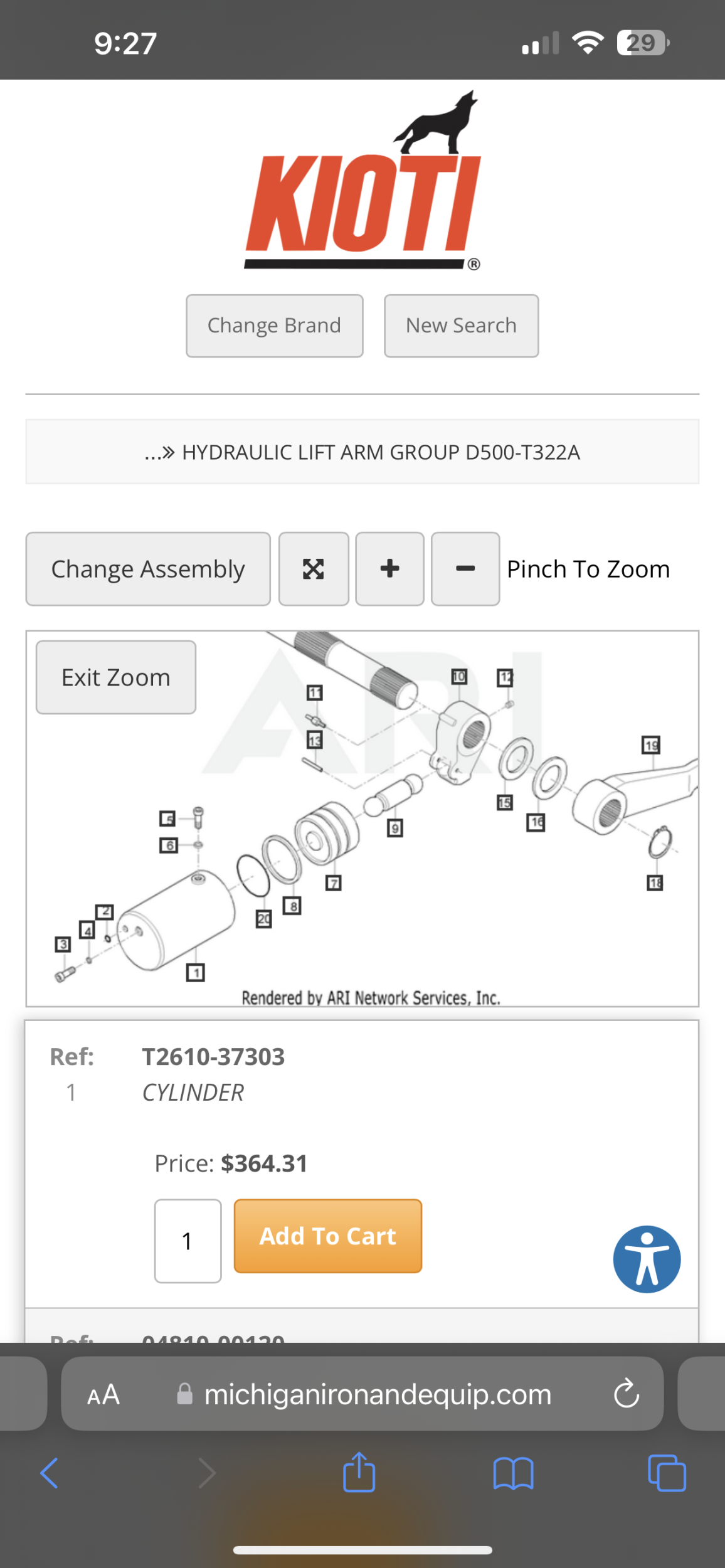

Thank you for the quick response. I attached another picture of a parts diagram to just confirm you are talking about part #8 and #20 correct? Where would the oil be going to if it was seeping past the piston when lifted, just back into the transmission housing?
   / Three point hitch slow leak down and hiccups when in use #4
Yes, those are the parts. Only other thing that might be wrong, but usually not on a low houred machine, is that the cylinder has some scoring.
The oil leaks by back to the sump/transmission

Once you have the piston out, just a pick or small blade flat screw driver to remove. Since they are probably the cause, a knife to cut them out and a very careful stretching of the new rings onto the piston.
