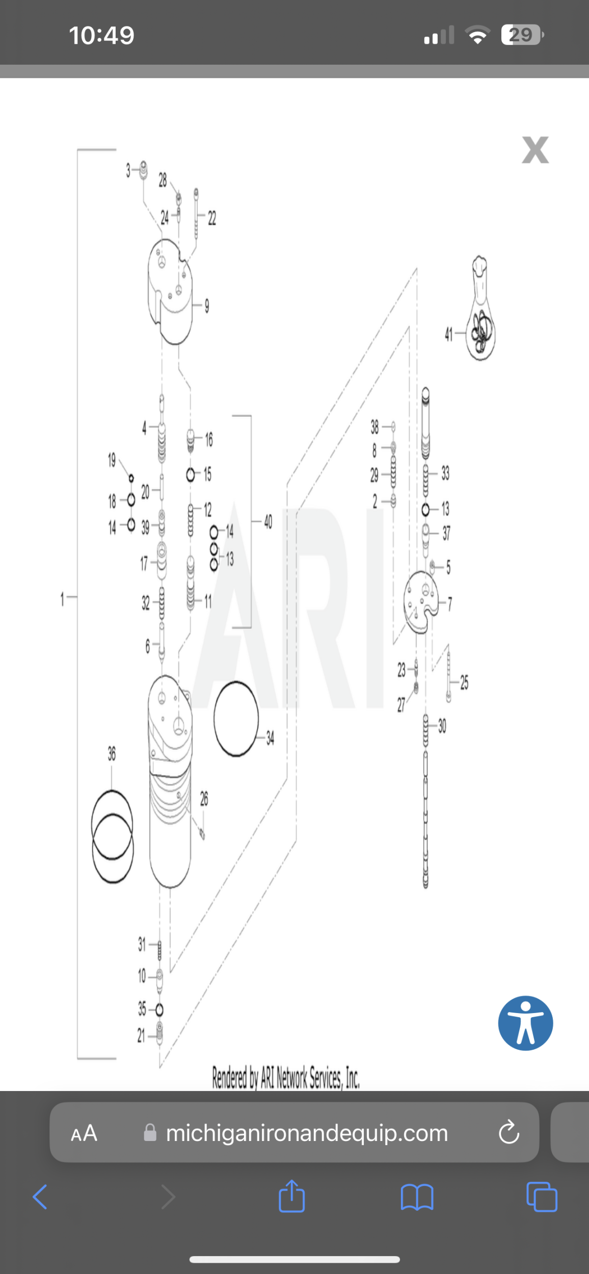

@rScotty Well looking at the MLS valve assembly group, that looks like a whole new can of worms. Not what I thought I saw today when I removed the seat and cover. That looks to be inside the hydraulic cylinder body. They have a seal kit for $72 dollars otherwise I wouldn’t know where to start with that complicated looking valve assembly haha. I wanted to get all the stuff ordered cause I am out in the country and it always takes several days to a week to get parts delivered before I dig too deep into taking things apart and had everything sitting in my non fully enclosed barn where it gets quite dusty on windy days.

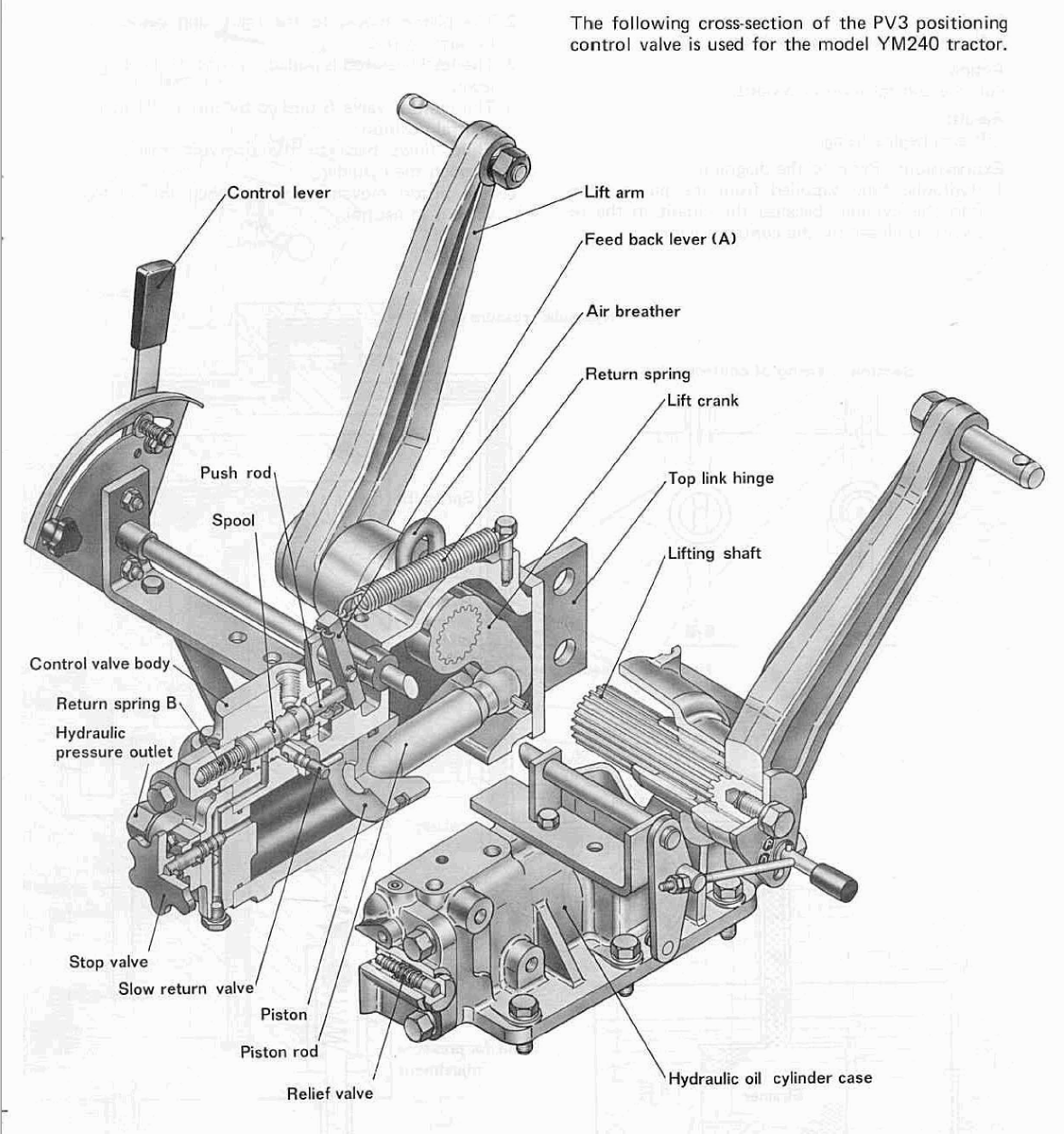

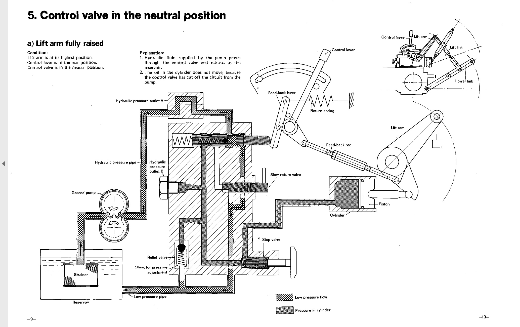

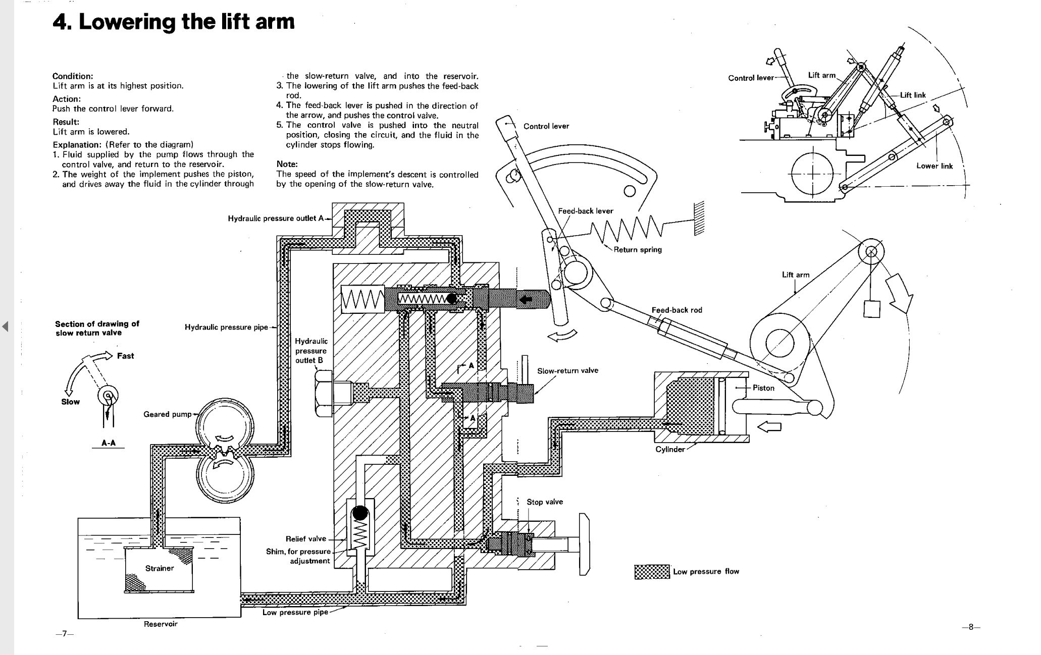

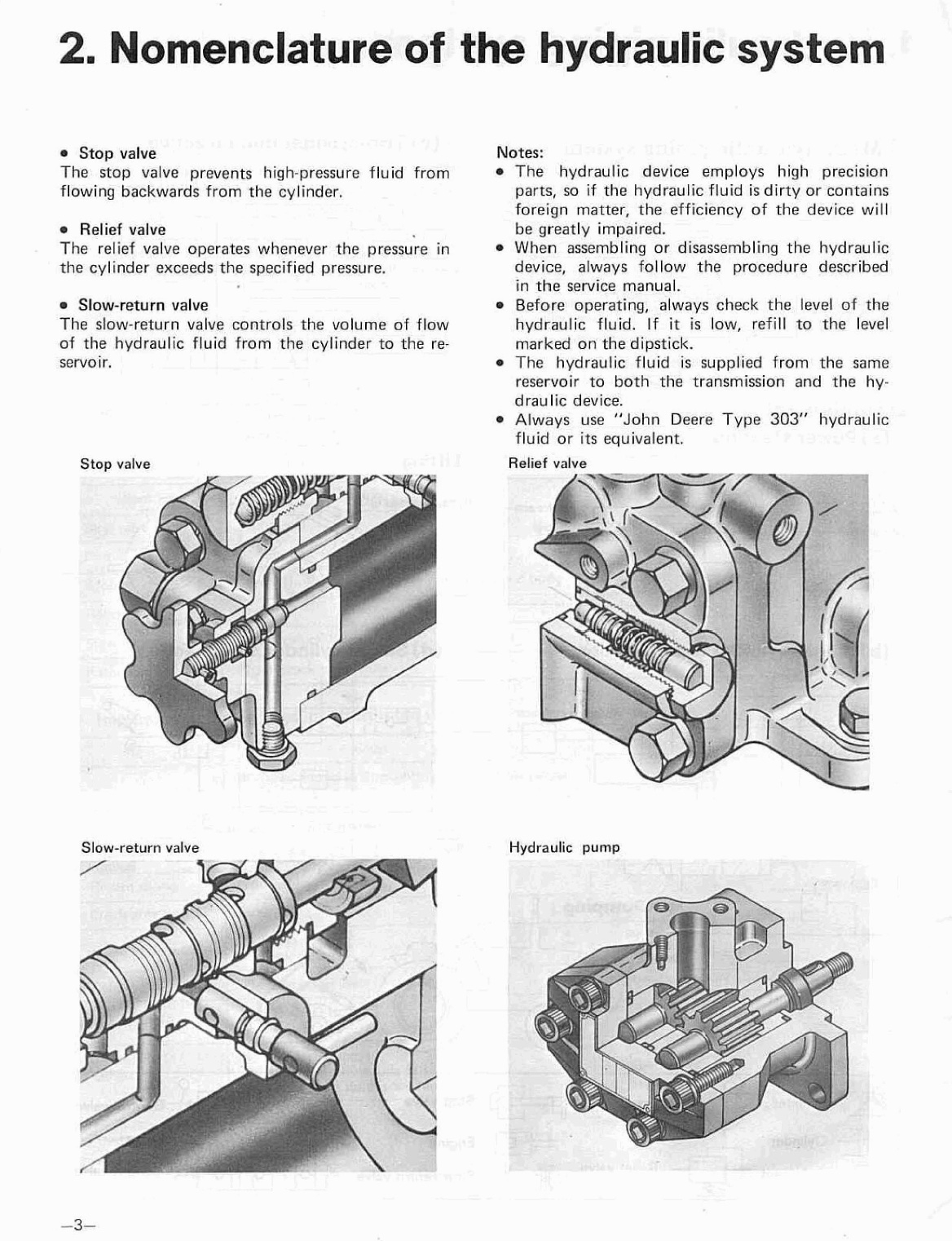

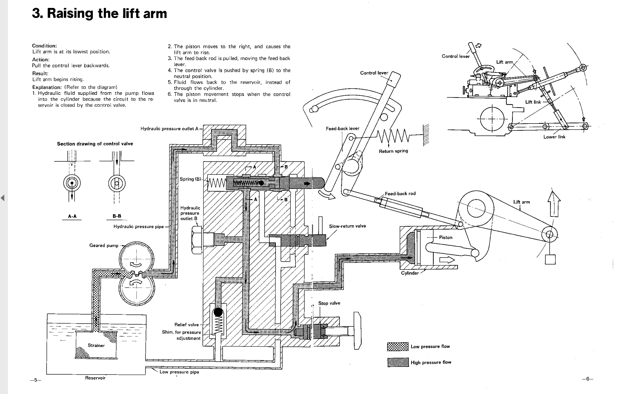

Let me attach some beautiful old Yanmar illustrations on their 3pt. from 50 years ago. It will give you a better idea of how the sytem works. Every part will be different of course, but still nobody has bettered Ferguson's original 3pt and they all work basically the same.
1_Artist Cutaway view of YM240 3pt hydraulics.png2_Nomenclature of the hydraulic system.jpg3_Raising the 3pt lift arm.jpg4_Lowering the 3pt lift arm.jpg5_Control Valve 3pt in Neutral position.jpg

Wow those are probably the best illustrations I have ever seen for anything I have owned. So the stop valve pretty much hydro locks the 3pt when in any up position and like you mentioned it can only leak down from either there or past the piston. The only other way I see it loosing pressure from the illustrations is from the hydraulic pressure outlet. Maybe I should check that as well…if the stop valve is working properly that would not happen though. I appreciate you sending those illustrations over that really helps me understand the flow and how a 3pt moves the fluid around
   / Three point hitch slow leak down and hiccups when in use #20
Yes, mechanical drawing used to be a required course for mechanical designers. At one time all designers could make a creditable drawing. Of course some were better at it than others. Yanmar hired real artists. That first drawing is museum quality in my eyes. Tremendous detail and done by someone who understood how it worked.
The old US series of Yanmars were trying to emulate John Deere's excellent manuals back 50 years ago. I'd say they succeeded.
Not shown is the filter you mentioned. It is in series between the "strainer" and the "geared pump".
