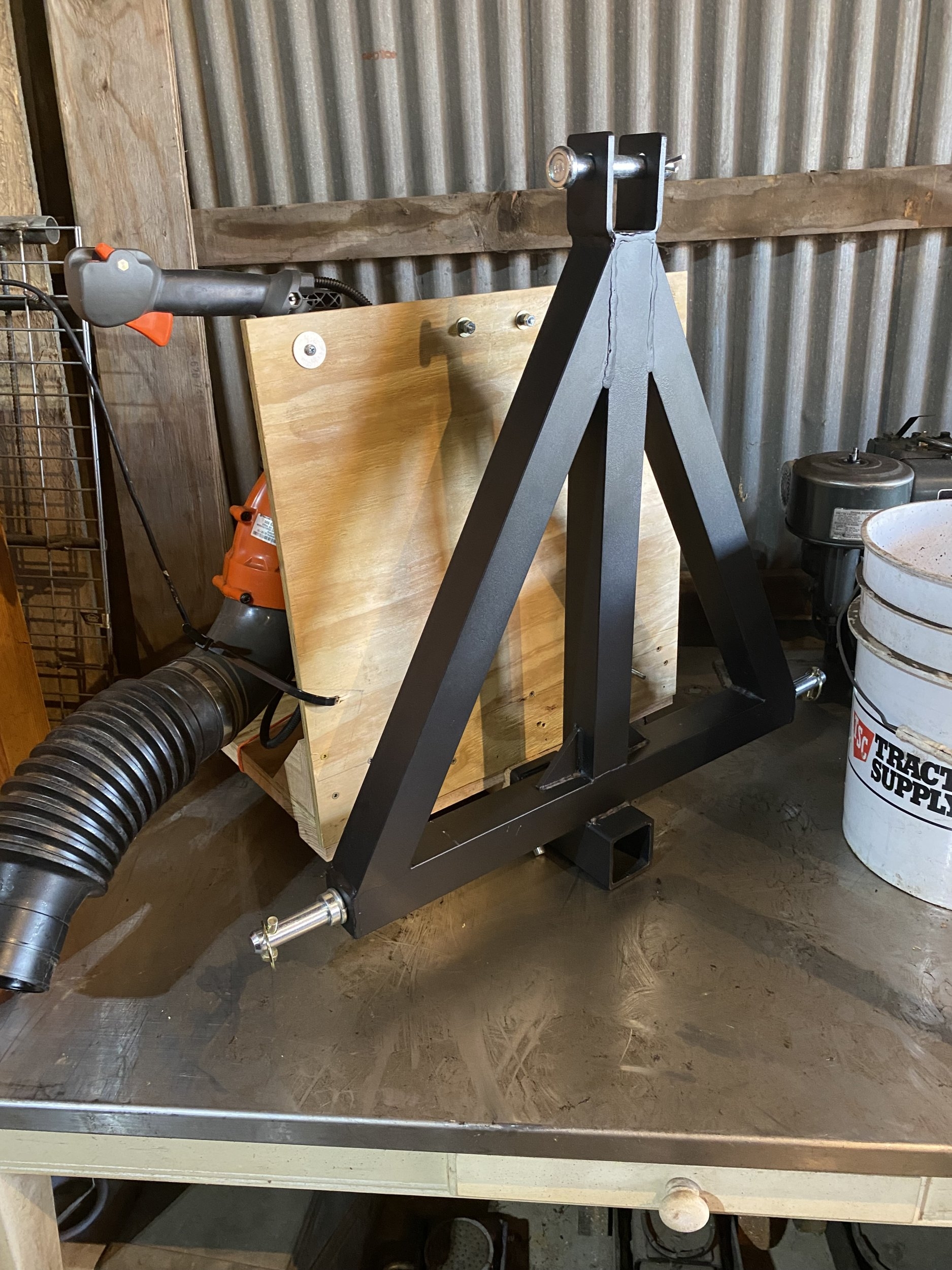

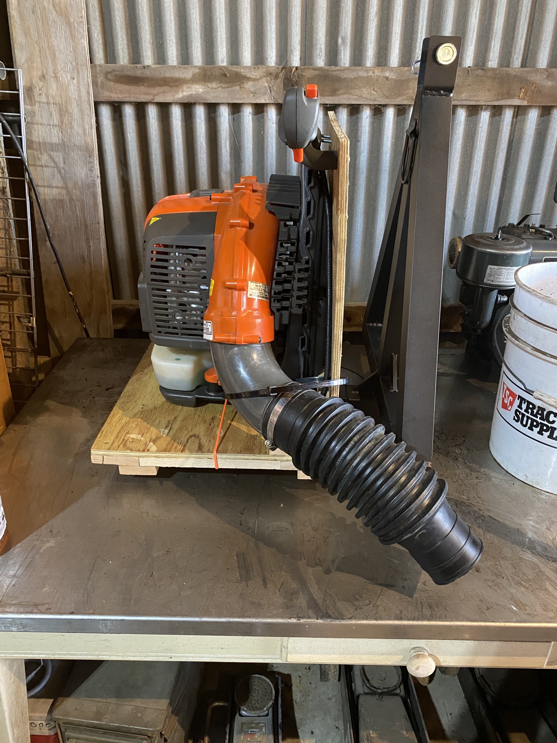

I am sure some have built a three point hitch leave blower i have made my own three point hitch and welded it up turned out fine, If you have one and some ideas let me know this will be a winter project for next fall when the leaves pile up, I swear i had a semi load of them LOL thanks !
here is what i came up with i made my 3 point assembly and mounted the back pack husqvarna on it
