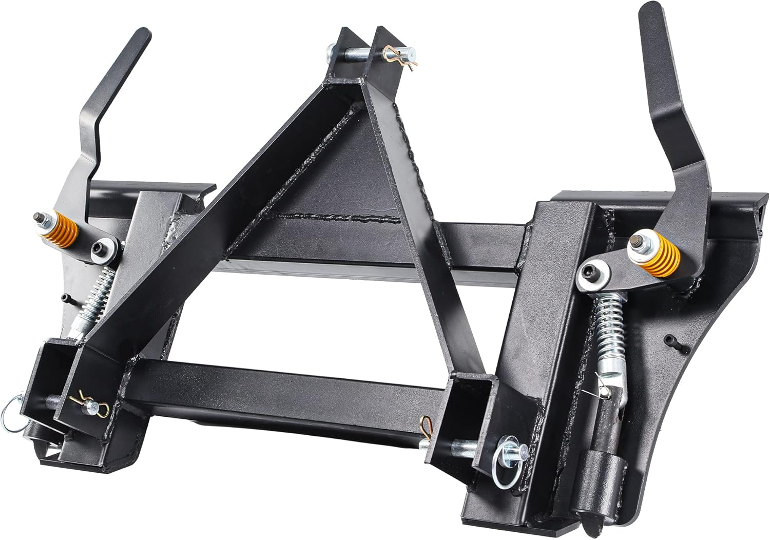

Any reason why you can't use the tractor FEL bucket as a scoop? If you want something on the rear of the tractor, you can use one of these 3pt to SSQA adapters. That way you can attach your FEL bucket to your 3pt hitch and use it as a scoop.

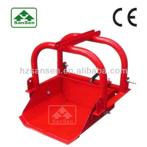

A farmer down the road had one on his old Massey 135 - a beautiful heavy 35 hp tractor but it didn't have a FEL or power steering.
He used a 3pt mounted rear scoop for moving dirt or carrying anything heavy. It would scoop dirt moving forward or in reverse, then lift and dump.
Implement companies still make rear scoops....called dirt scoops or sometimes pond scoops. Used to be used for cleaning ditches.
Before FEL and power steering became common those old 3pt scoops were found on most farms.

Nifty gadget...though I'm not sure why I would want my bucket on the rear of the tractor...:unsure:
I have an extra FEL bucket that I use as a scoop on the 3pt when moving a lot of material around. That way, I can carry a bucket load front and rear. Works particularly well with a hyd. top link.
The adapter also works well for attaching other SSQA implements to the 3pt like a bale spear or even a FEL plow.
If you have a hyd. tilt cylinder, you can also adjust the angle of the bucket when grading. That's something you can't easily do with a FEL bucket.
View attachment 5106203View attachment 5106203
I have had one of those for over thirty years. It's dredged the vernal pool out back bringing the rich soil to the gardens out front. Moved TONs of stone, sand and gravel. It's a decent firewood mover too.
If I didn't have one, I would go out and buy one!
A quick welded on "dam" fitted to the open end would serve to haul concrete.
