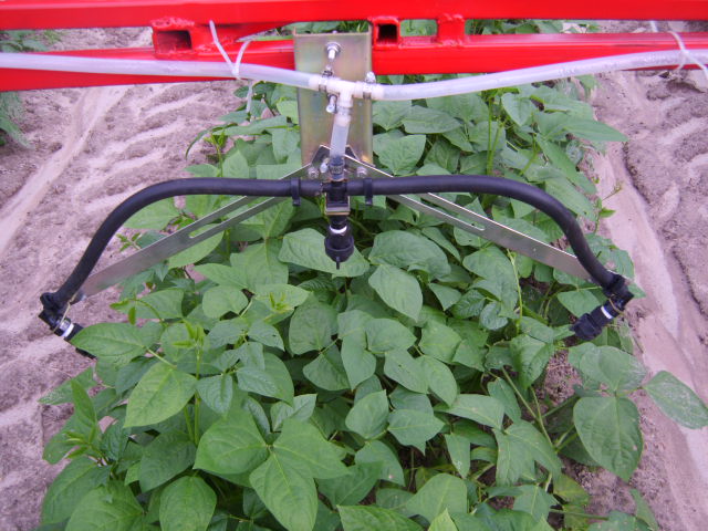

Here's 1 of the sprayer setup, on the Boom. You can adjust it about any old way you want too. If your Rows are off, they will slide either way down the tube.. make sure you leave some extra hose to do that...
These sprayer setup.... You can get them from Tractor Supply, You can get this one or they have the one that does not have the SS arms, it's alittle cheaper. Tractor Supply had them for $64.00 x = how ever many you need.
You may get them from a dealer near you, much cheaper, like $32.00.....
So shop around before you buy them....
All the spray tips / Fittings, came from .... You guest it ........ Tractor Supply...... And they aint cheap either...

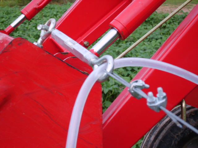

You can see where I hooked up the cable, for support, this is hooked to the top of the bucket, with that air plane cable, Tractor Supply has....
/ Three Row Boom Sprayer
This one has the other end of the cable hooked up to the bucket, clean and simple.
Just drill a hole in the bucket, mount the I-Bolt, run your Thing a ma bob, all the out....... Well you get the rest of it.......

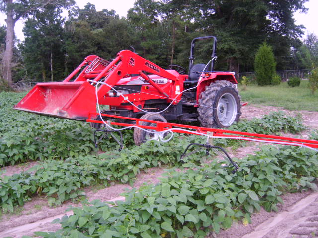

This one is setting on the Tractor, gives you an idea of what it looks like running down the row.
The rows are 60" apart, just enought room to walk and pick those purple hull peas. YUM !!! YUM !!!!! ......... They just started to run....

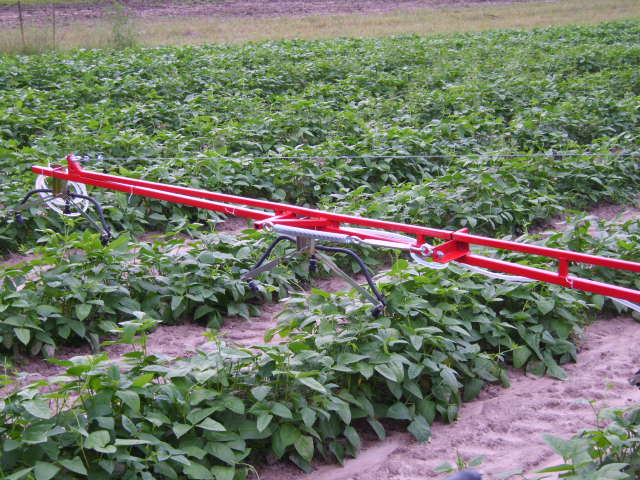

This is one shows the full meal deal...... With this setup you can spray Corn Tomatoes, Peas, or just about anything you can get down the row.
You can make it a regular field sprayer too, just slide the sprayers together..

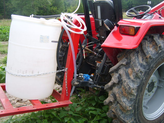

Do you have a picture of your tank and pump set up?
/ Three Row Boom Sprayer #9
KillerTractor said:
Yes sir I do........
Thanks, hate to ask for more. looks like a recycled 55 gallon drum. I've got a drum carrier (previously a spray rig) I want to reconfigure or re-equip and your set-up looks good to me. Mine can hold two drums and was thinking to use one for round-up and the other for what ever else. My co-op has the drums for $15 each but I think the bottling companies will almost give them away.

Hey Rvaitor...... it's no problem, your right again... I got it from our local pedler for $15.00. It's alot cheaper to get these than go and buy a 50 gal. tank from Tractor Supply, are somebody else...
Shoot ....I can buy 10 of these, for the price of that one.......
Some had soap in them and some had drink syrup... Nice and clean.....
I just drop the suction hose, in the hole of the barrel with a weight on the end of the hose , it does just fine. Then when I get ready to wash the barrel out, I fill it with water some soap and I disconnect it from the pump, and let it drain out several times. Ready to go next time.

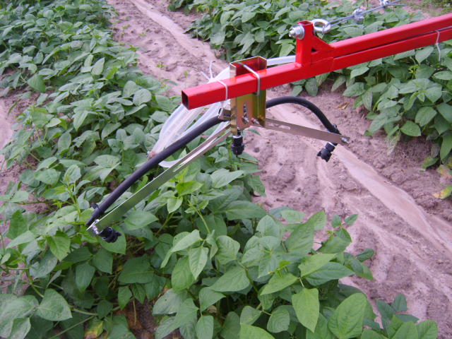

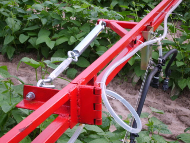

This picture has the hinge and spring close up. What I did was weld up everything first,then I made the cut on the hinge. I did it with a grinder, a sawsall or a band saw would work much better ,for a finer cut.
Live and learn I guess... I had fun with it..... I think it will work really good on a corn patch next year...
