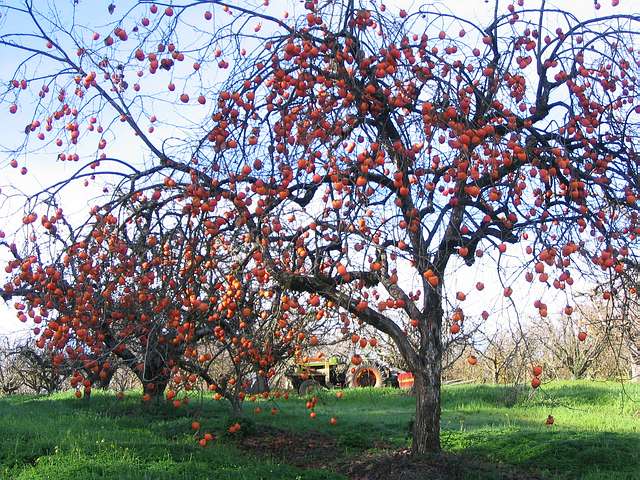

I wanted to harvest the lone persimmon tree down in the back of the apple orchard so I tied my harvest buckets and ladder onto the loader bucket and drove on down - see attached. Yeah our winters are pretty mild.
