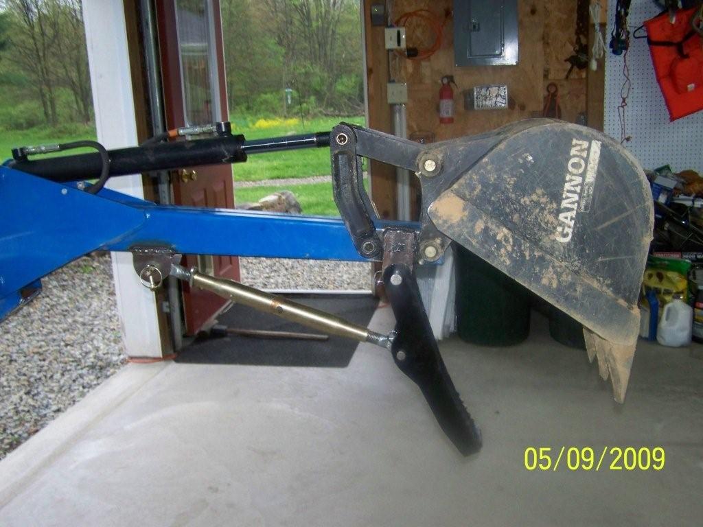

Here is my thumb kit welded onto an actual blue Woods 7500 hoe. Tho the
Woods unit is not quite as stout as my 7500 clone hoe (Prairie Dog 7.5),
the owner has reported no problems. The most important element is
the forward brackets that are welded all the way around the end of the
dipper. Not just to the inner surface.

Thanks for the photo and info dfkrug.
Nickle plate, I was Emailing back and forth with MIE and was thinking about the bolt on unit for my back hoe. You guys have me thinking about the weld on though.

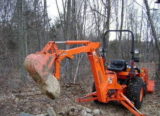

I have worked my Brot-Tek thumb pretty hard for 3 years now
I put 12 hours on my BH this weekend moving rocks up to about 2' long by 2.5' wide 8" deep, stumps, general brush and anything else that got near my BH
This is a glamour shot of the thumb, I have had zero issues
My only complaint is that I can't completely roll my bucket back but it only stops about an inch short, I can deal with that for the utility
Believe me, had they had a hydraulic option I would have bought it, this is the next best thing for me and relatively cheap
   / Thumb addition causing dipper stick damage?
#19
AMR, what back hoe do you have?
   / Thumb addition causing dipper stick damage? #20
UWAdventurer, I have the Kubota BH75A on my B3030
I actually took a good look at it again last night in the garage and it looks to me like the way the Bro-Tek thumb fits and works will not be an issue, the dipper looks just fine
As I stated before I have done what was needed to move some really big rocks, the only issue is that I can't roll the bucket back entirely it stops with about 1" of cylinder left
