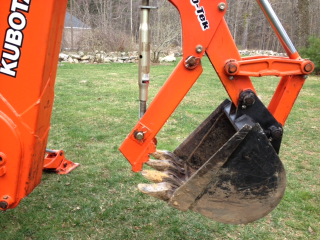

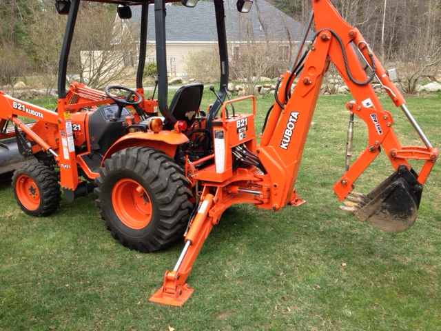

I dont have the 4690 but a B21 which is similar in size and frame - I have the bolt on Brotek thumb I got in 2004 I think. I had to upgrade to the 1" pins (Cat 2) and HD setup from the 3/4" Cat 1 as I bent the conecting (an old top link). So Richard sent me new parts and plates and its OK but has some side to side play due to the design.
It works OK but if I were to do it again I would get a unit like Michigan Iron Equipment shown here Hound Dog Backhoe Thumbs
They have a 6" gripping area and look more stable when clamping. Here is a shot of mine installed.

I'd recommend either the Extreme Metal Products or the Hound Dog because of the design. I bought a Bro-Tek for my BH75 back in 08 or 09, and hated it. Fortunately, got it sold after a couple months use. There was WAY too much side-to-side play on that thing. I hated it so much, I decided to do without until I was ready to buy something like the other 2 I mentioned. Was pretty well set on the EMP thumb, but never got around to buying it before I traded.
Bandit,
I agree with you - the side to side play is annoying - the 1" Cat 2 is a better setup but still lacking. For rocks the Brotek works but gripping area is a PIA. For logs and general pickup its OK.
Vernon, as far as Hyd or not, it just depends on your budget and how often you will use it. getting off the machine to do the mech thumb is not a big deal but if you want the optimum in flexibility go Hyd. If its jsut occasional rocks and logs and stumps then mechanical. If you intend to do a lot of stumps and brush grubbing go hydraulic.
