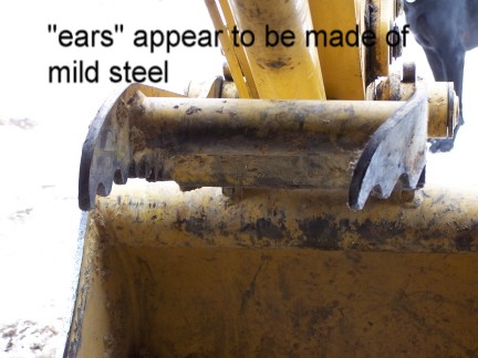

I have a 110 with the JD thumb.
It is fairly useful on most everything once you get used to having it.
A couple of things about the JD thumb,
2500 Dollars? I hope that's installed. I paid 1450 installed at my JD dealer.
The JD thumb is (IMHO) a total piece of crap. It does work, however the Cylinder is too small, it lacks power, doesn't travel far enough, & has a tendency to break off the grease fittings due to clearance issues with itself.
I bent the "ears" over on it in about 2 hours. All mild steel as far as I can tell.
A much better thumb is made by Addington Equipment, which is what mine will have shortly.
I can take pics of the issues I have had with mine if you wish.

I would love to see the pix.

   / Thumb for JD TLB110 #5
pic

Thx for posting the photos, dubba. I am amazed that the JD factory thumb is so poorly designed. The 110 is a great machine, though out of the league of most of us with non-industrial tractors. That said, I love the new mechanical thumb that I fabricated for my Prairie Dog hoe. Every hoe should have a thumb!
