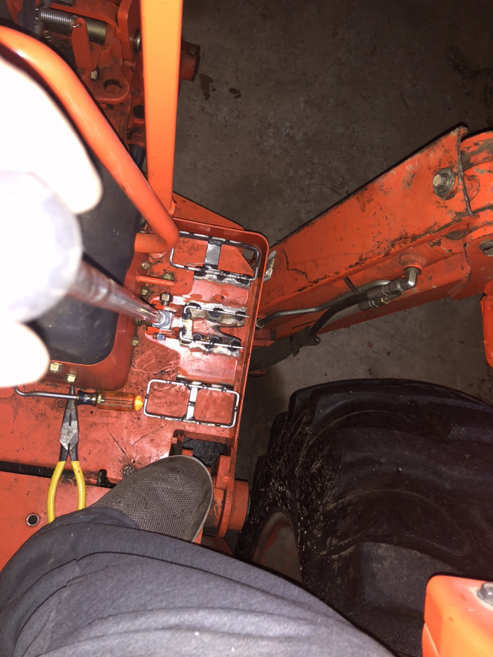

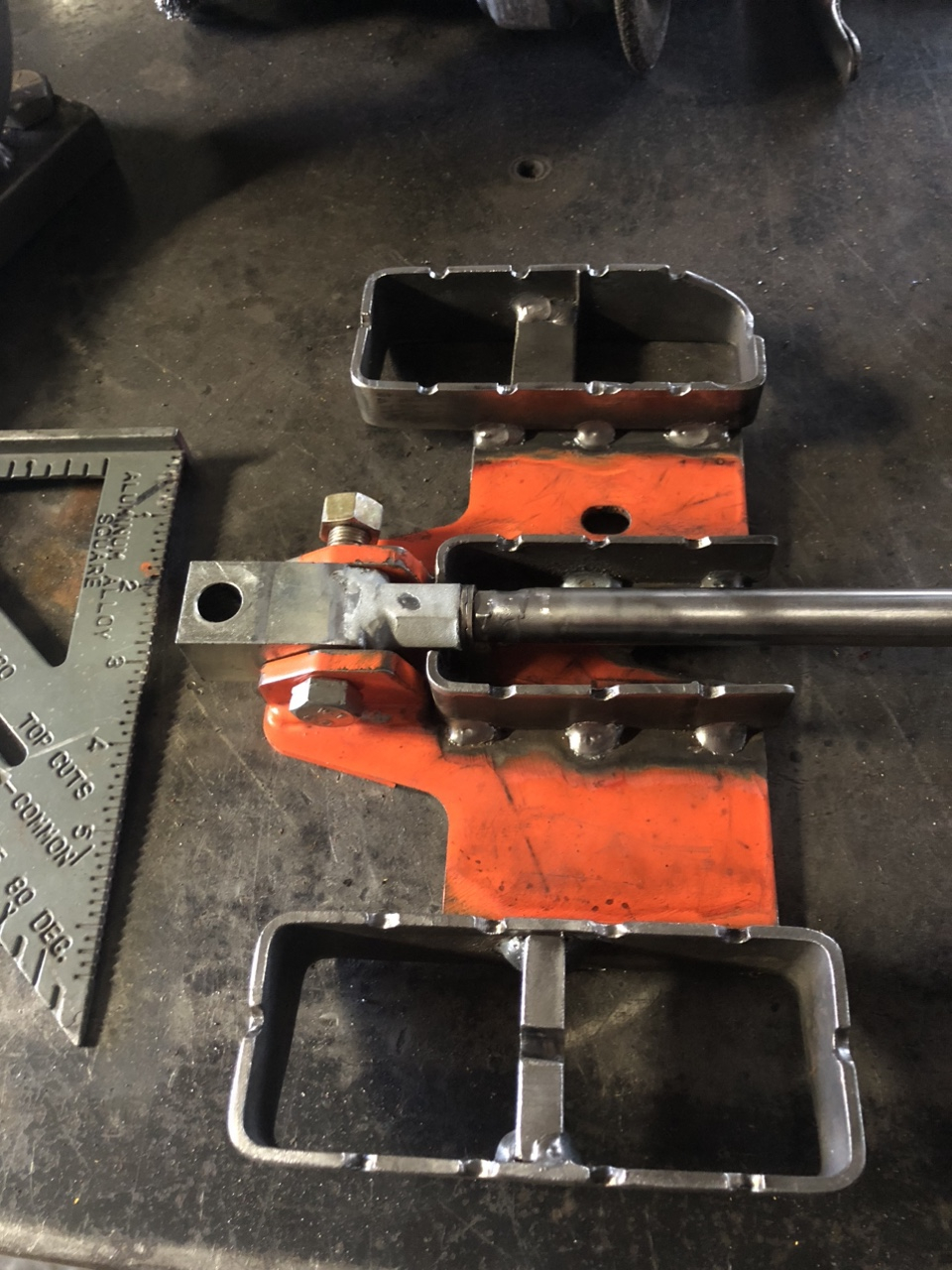

Added a hand control lever to work in concert with the existing foot pedal on the M59 backhoe. Also added some tubing/grating to the pedal to better fit my brogans.
Can use either or together.

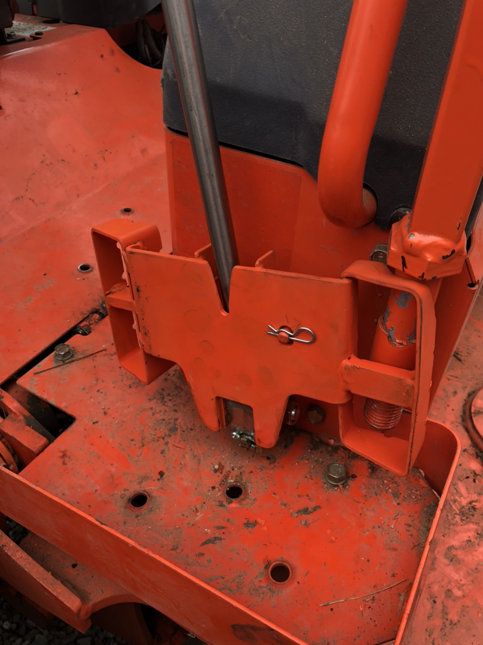

Lever was easy by welding a 3/8” hold down coupling nut to the pedal swivel/hinge block.
Pedal treads made from 2x5” tubing. Pedal is now 4” longer.
Still can hinge the pedal up to lock and disconnect the pedal and lever from the valve like the OEM design.
Hopefully giving this old fellow better dexterity stacking rocks and such.

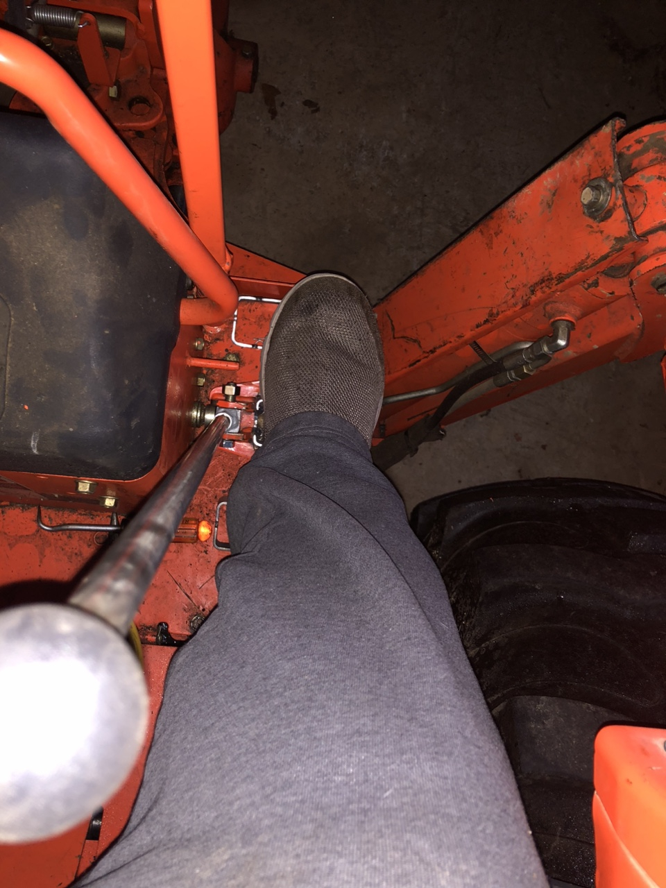

Pedal control so much easier and smoother. It has a stout return to center spring. Even with the long hand lever the spring force is more compared to the other two levers.
Precise hand control. Don’t always need it but good to have available.

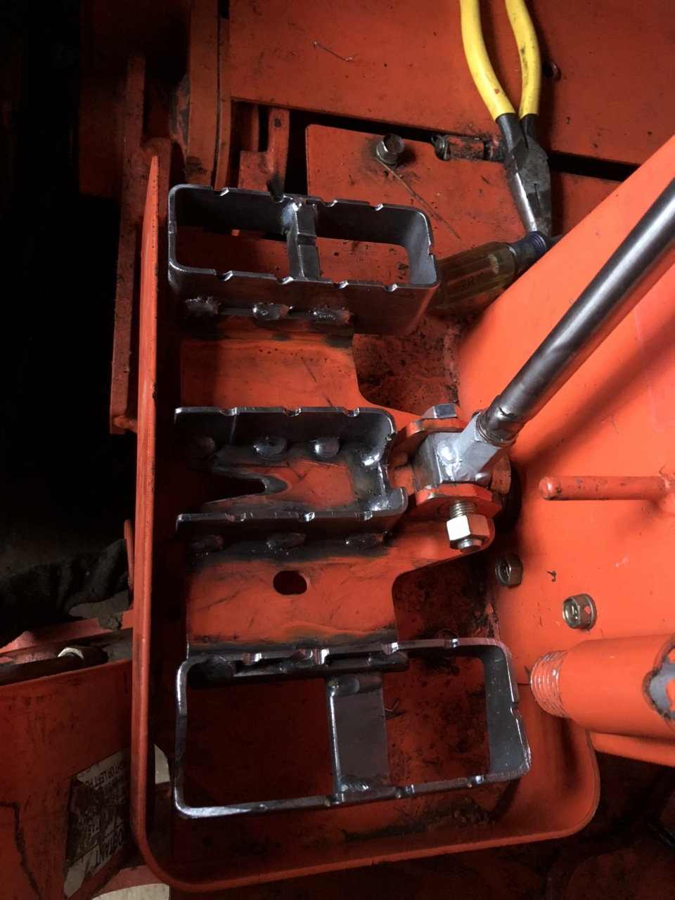

Modifications to the pedal for foot control made for much improved thumb operations. Extra pedal length, height, and grip makes a huge difference controlling the close and release function. Giving natural fluidly to movements.
B26 now needs one to.
Wish I had done this years ago.
