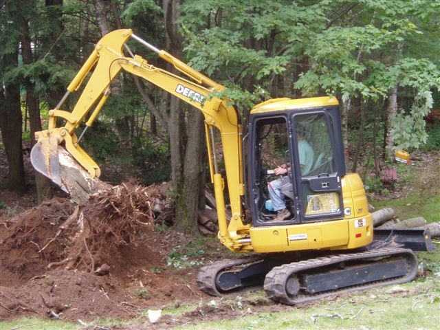

Here is a picture of my 10000# excavator with thumb lifting a stump.

Tony,
I have heard of them but no insights. It may fit the unit very well. Have you visited their sight? The dealer should be able to show you pictures of the thumb on some units.
Good piture of a mini excatator with a thumb doing the pull and carry thing. Very useful attachment. Very.
Are you a welder? If so, there is a low cost way of getting into a thumb? It is not a bad idea to get the whole thing right up front.

RayDiers, nice picture, that's exactly why I want one of those. Gray's pictures have motivated me to go for the option.
Gray, Yes, I've been to their site: www.werk-brau.com, and they have solid looking stuff. They have a ripper tooth I like the looks of too for stumps and rocks. I'm not a welder, and not particularly mechanically gifted, but I hope to learn as I go - at least enough to maintain a machine...Tony
