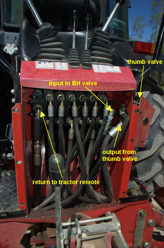

Thanks to all for the ideas! This is getting a bit complex for me to understand but I understand the basic concept that maybe high pressure fluid is getting to where it should be low pressure fluid.
A few more tidbits.
When I spoke with my dealer, I mentioned that I had turned the PRV adjustment screw 1/4 turn and the leak had stopped (the leak has not leaked since). He mentioned that he had spoke with a tech at Prince and that person said that sometimes if there's not enough pressure on that spring in the PRV, it will leak and that tightening it a bit can fix the leak (not very scientific I know).
I also found in the valve docs a cutaway drawing of the internals of the PRV cartridge itself and it seems very simple. Adjustment screw presses against a plunger (my term), which presses against the spring, which presses against another plunger which is where the relief happens. The first plunger appears to have an o-ring which seems to be where the fluid would be passing to leak down the adjustment screw.
This is my crude understanding of how the valves are setup: two hoses connect from the rear remotes of the tractor to the BH control valve (I assume that maybe there's a PRV for the BH on this valve inside the BH console). There are hoses that come from the BH control valve to the thumb valve and this thumb valve is mounted on the outside of the BH console (it is enclosed in a bracket and only it's spool and PRV are really accessible without unbuilding the bracket and BH console). The Prince RD4100 thumb valve has a number of options including a power beyond port but it is plugged.
So as far as I understand, it's tractor>BH valve>thumb valve.
I recently received my pressure gauge but have not used it yet. If I plug it into the output rear remote, won't that give me the pressure that the tractor is putting out? Do I need to do something to make the pressure go to the max or is just plugging in the gauge enough to read the max pressure?
If I plug in the gauge at the thumb cylinder, won't that show me the pressure that the thumb valve is putting out?
These two places and the FEL connections are the only places I have QDs to plug in the gauge.

Why are you not using the PB from the thumb valve to go to the 3pt. You seem to be using the OUT/TANK port to send fluid to the 3pt, and if that is true, you are providing the thumb valve with to much back pressure whenever you use the 3pt. That is not good for the spools and the relief valve, depending on the thumb PRV setting. I would set all the relief valve the same.
You should have a series connection like this. Pump, FEL, BH, THUMB, 3pt. You should be using any PB port available to feed the next valve, as this port can handle the high pressure. .

After getting my tractor out of the bog it was stuck in today (I hate when that happens:mad:), I finally can now upload some photos which may shed better light on the situation (see attached images of BH console).
I opened the BH console today to see how things were setup. It turns out that it is setup like this:
tractor rear remote > thumb valve input > thumb valve output > BH control valve input > BH control valve output > tractor rear remote.
So the thumb valve is first, then BH valve. My dealer set things up this way. At the moment, the thumb valve PRV has not been leaking... but I haven't put sustained heavy use on the BH since I slightly turned the adjusting screw.
