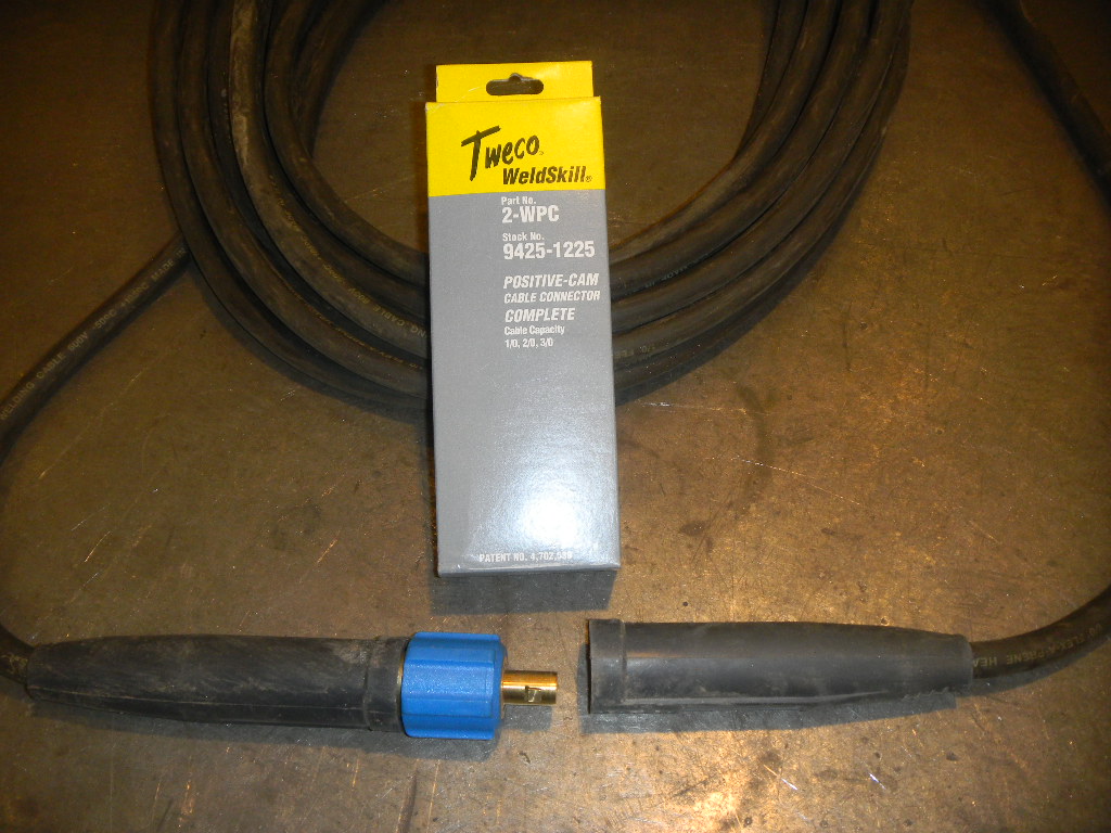

I have some long leads I want to use with the PA300. What kind of connector do I need to buy to put on the end of them so that they will plug into the machine?

It is a DINSE connector. The numbering is confusing as to what it means. It actually deals with the cable capacity of the plug, not the size...It's a volume measurement. Don't ask me for more details than that, because it's too much work for me to look it all up again. lol. It's roughly 1/2" in diameter across the 'pin'. A lot of sites will list it as a DINSE 50, DINSE 1/2" or DINSE 35/70mm2 (squared). But the DINSE connectors you have on the unit can be used with longer cables by sliding the rubber boot back and loosening the set screw and sliding the cable out...and reverse it for installation.

Thanks. If I can remove the existing cable and add a new one I am good to go. I thought the factory ends might be molded on or something.
Took me a while to figure it out too.
But they are in square MM. The larger ones are usualy listed as 50 MM^2 and the smaller ones are listed as 25 MM^2.
