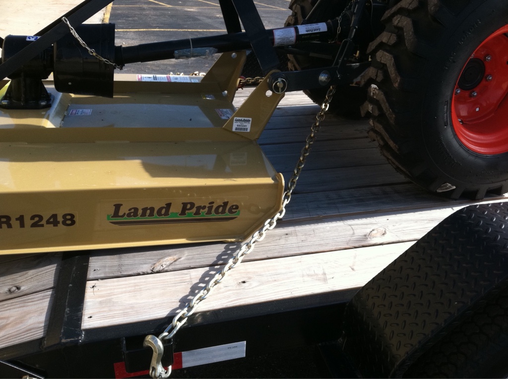

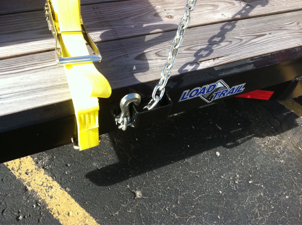

I just find chain binders and a cheater bar to tighten easier on my aching arthritic thumbs than straps big enough to secure, for me. I can grip a binder with my hand easier than I can pry a strap release with my thumb. Use both but chains on the B2320 itself. ImageUploadedByTractorByNet1471232656.533924.jpgImageUploadedByTractorByNet1471232703.273067.jpgImageUploadedByTractorByNet1471232717.496872.jpg
