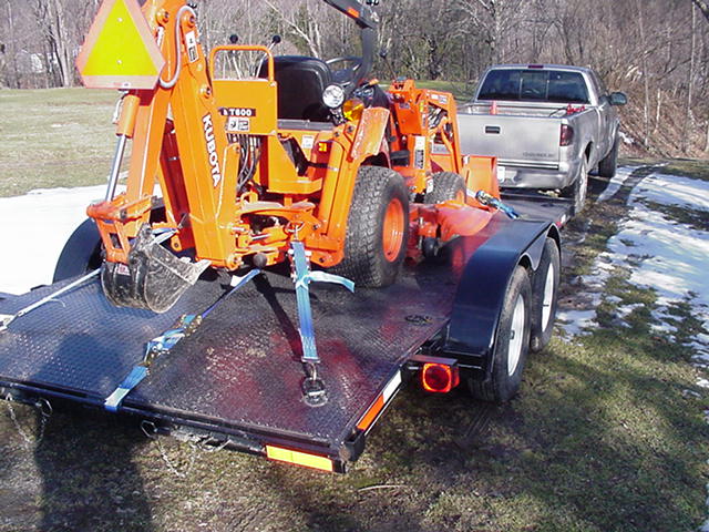

Hello Dave,
I have a BX22 and I tie it down with 2 inch racheting type straps. I hauled it 200 miles from my upstate house down to long Island New york. I did make provisions on the tractor as you can see in the photos.(common "D" rings) I also towed it with a Chevy S10 with no problem.Anyone familar with RT. 17 knows of the hills heading west towards Rosco N.Y. like I said the S10 pulled the hills with no problem.
Bob A.

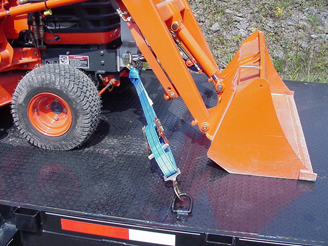

I'll learn how to use this forum yet.
Here is the front tie down picture.
