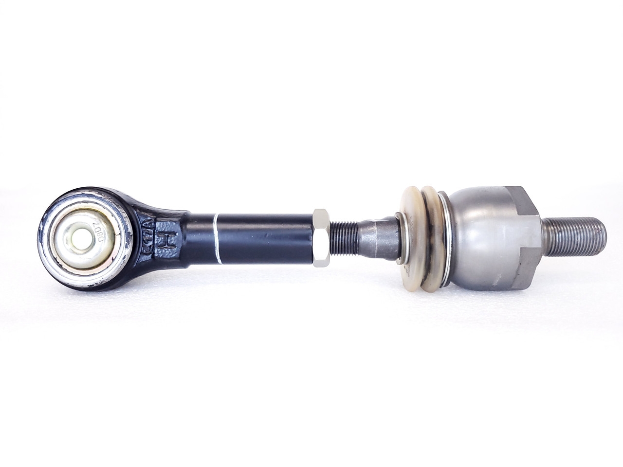

I tore the tie rod boots on my 4550 and need to replace it. Mahindra wants $150.00 for a replacement rubber boot (ouch) Part L1009100012. Does anyone know of an aftermarket part of an alternative I can use. Rubicon International has the entire tie rod assembly with the boot for $112.00 (currently out of stock) Seems pretty extreme for the boot to cost more than the entire assembly
/ Tie Rod Boots #3
Do you have a picture of one? Dorman sells off the shelf boots for $6-$8 and found at most auto parts stores. Google "tie rod boots" and see if you can find one close. They come in many forms. Or find someone that can make a 3D file and print it out of TPU filament. I've got the printer and filament but no file. :cool:

/ Tie Rod Boots
I need to pull the boot off to get measurement and I'll begin my search.

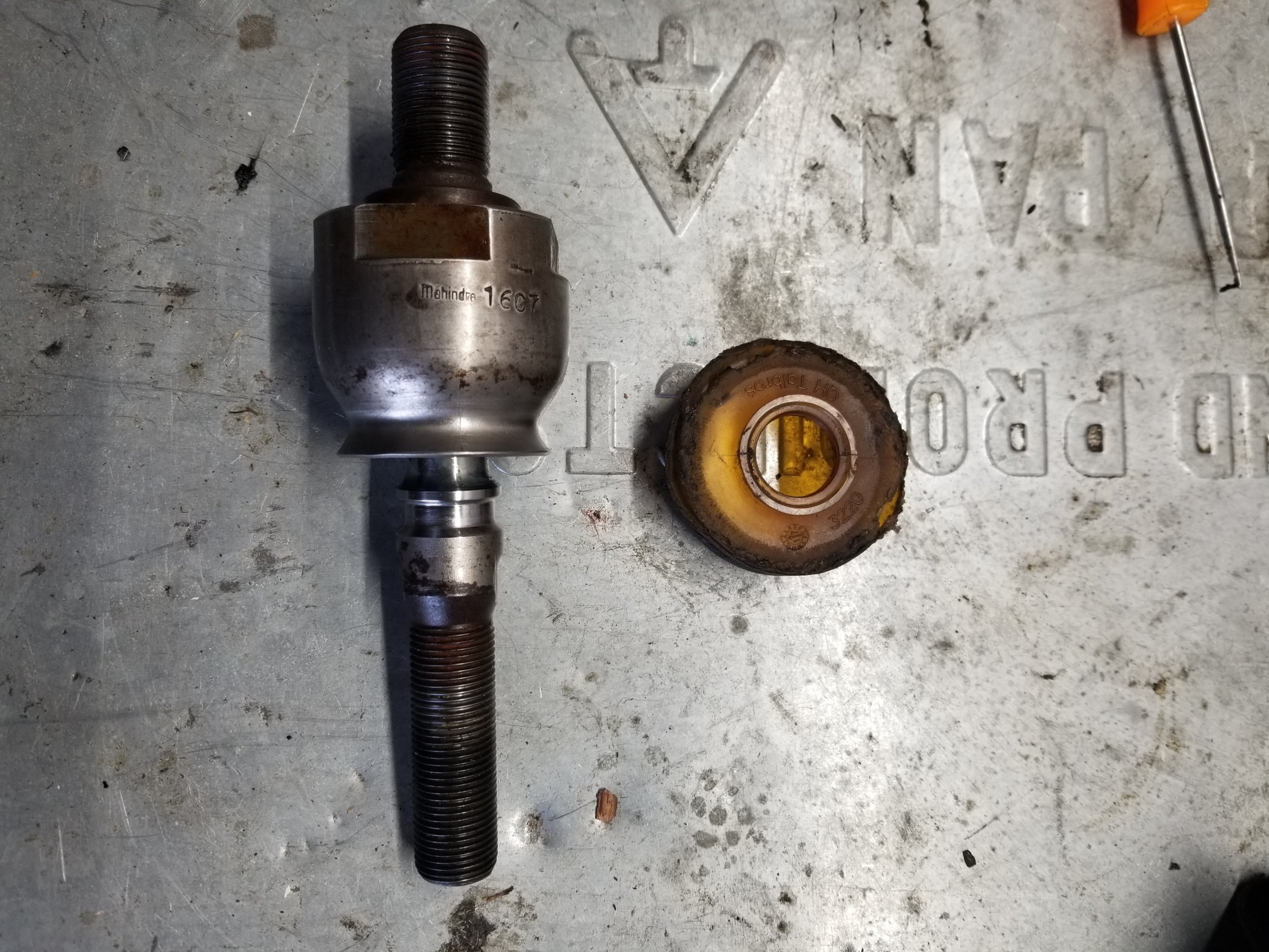

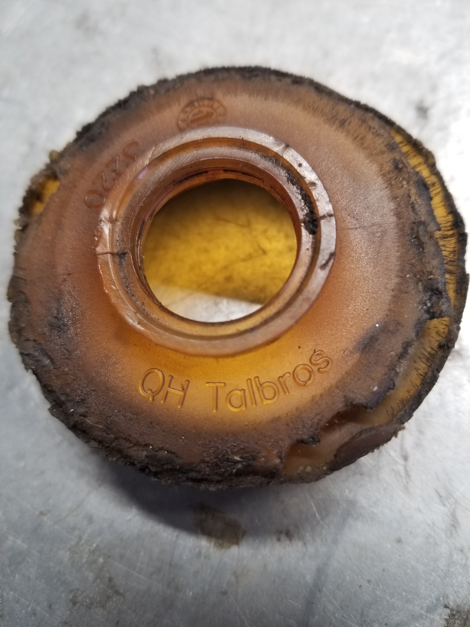

Here is a picture of the boot. The measurements are on the small side are .73 or 18mm. the large side is 1.51 or 38mm. I found something close on e-bay that I ordered but it is coming from Bulgaria. Due to come around Jan 11 to Feb 1 2024. It's made from silicone so I hope it will work.
The company MTGreen mentioned (polyboots.com) looks to have a close match but they don't sell to private buyers and they are also in Bulgaria. That too bad because it would be a good resource for this type of boots
The Company name on the Boot QH Talbros is a company in India but they seem to be focused on tie rod and steering assembles and not individual parts for the tie rods.
SimpleSimon The disassembly wasn't too bad.
