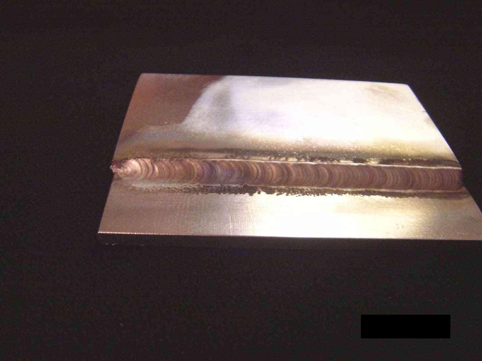

Old school Tig welding on DC with 100% helium.

Shield Arc said:
No. That's not true.:D;)
well, yes. You sure can do it. But for most of us mortals, AC works out better. If helium wasn't so expensive I'd have my argon tank filled with helium and give it a try.
