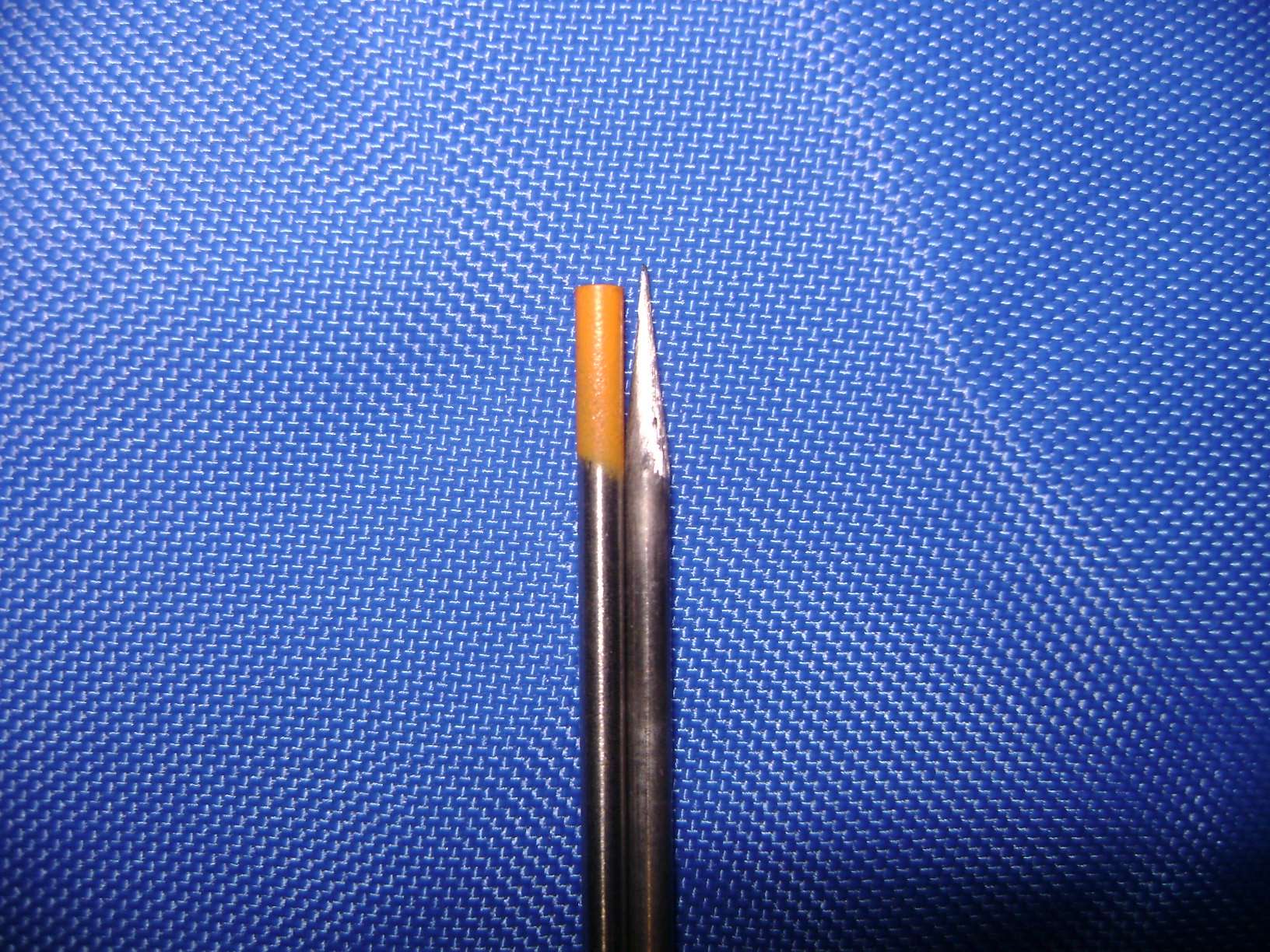

Was trying to weld some SS, 1/16" thick with the MultiMatic200 (with Miller TIG kit). Had an awful time getting an arc started. Sometimes it would just make a conical halo around the sharp cone-tip of the tungsten. And when I did get a real arc going, the arc seemed hotter than the 'settings' was difficult to control. Ground clamp was set directly to the work, and was clean I think. Never got anywhere. Any ideas?
   / TIG question (arc problems) #2
How are you grinding the tungsten?
What was the amperage?
How far away from the part were?
What machine and what all settings do you have available to adjust?
Tungsten ground (parallel) on a beltsander. Previously when all was working I was using a flapper disc. That's the only change I can think of.
I don't recall the amps, because the machine has a 1/16" (thickness) setting. It does display the amps for that setting but I don't remember. Will try again and pay attn. Not sure I can say how far away, was trying anything to get the arc started but generally from 0 to 1/16" away. Basically it acted like it was trying to arc anywhere OTHER than at the point.

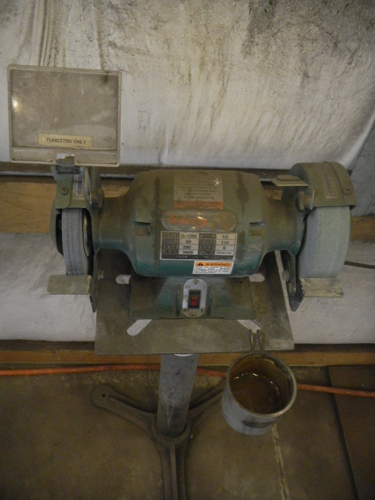

I'll bet it's the way you are sharpening the tungsten. Use a drill motor on a dedicated grinding wheel. Don't use the grinding wheel for anything but tungsten.

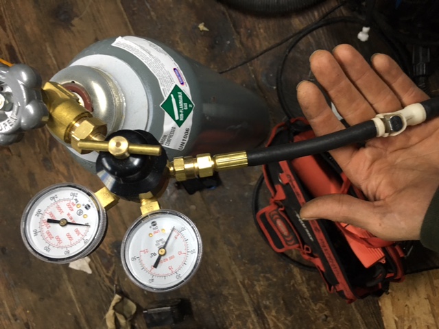

If your ground is proper, it could be a shielding gas problem. Is it a new bottle? It may be contaminated. IF you have used the gas bottle previously with good results, check the fittings on the torch all the way from torch to bottle. A loose coupling will suck air inside the hose and mess with your arc and weld.

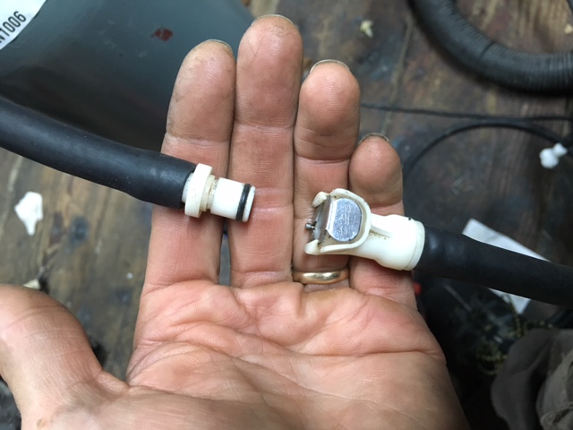

Hmmmmm. First welds offa fresh filled bottle. The valve was shrink-wrapped with the gas company's wrap.
I use these "CPC" gas fittings, always purge the short line off the regulator and hook them up with gas flowing. The other connector to the welder has a shutoff, it seals when disconnected and holds the gas in the line.

My money's on post 5. Dedicated wheel...possible contamination if not..
