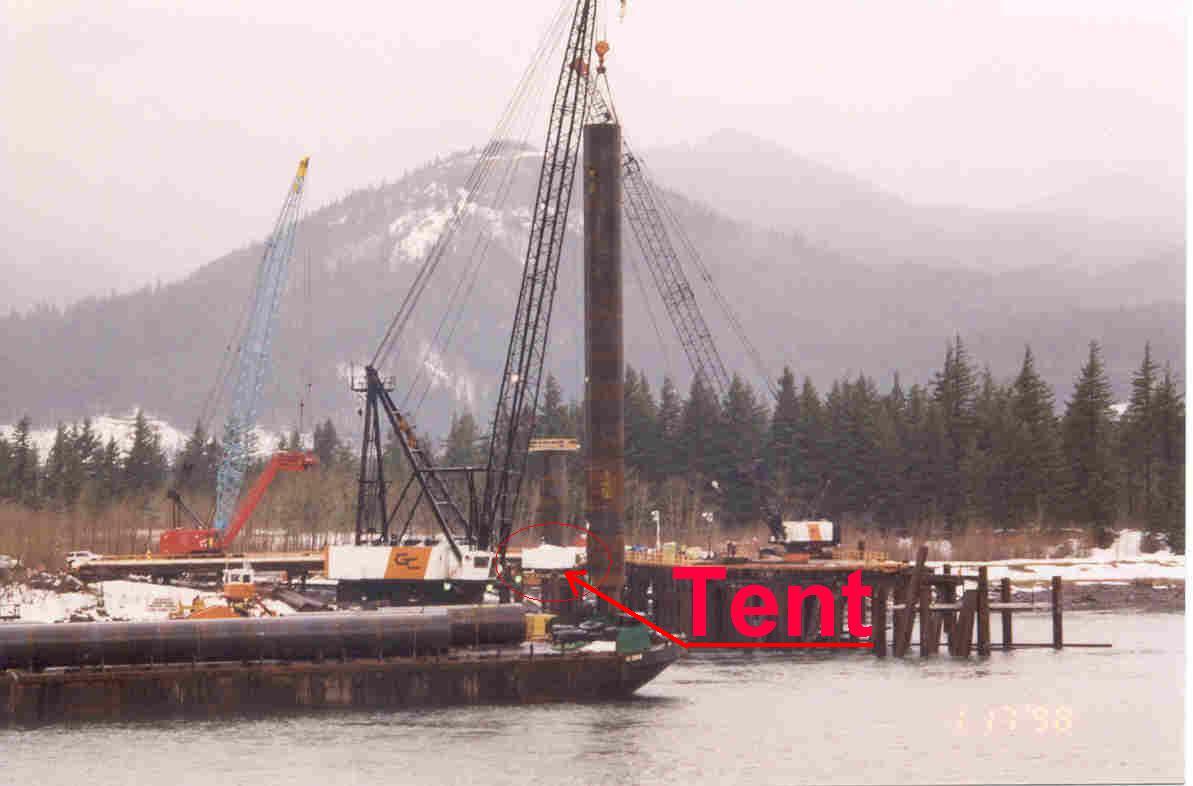

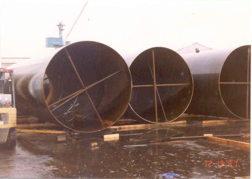

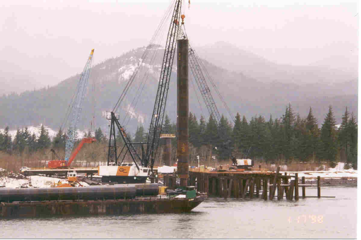

I had two shifts of welders splicing these 10-feet in diameter pipe just down river of the Bonneville dam. Running 1/16" dual shield. 100 % xray. I bought all regulators, the welders refused to use them, they wanted flow meters.

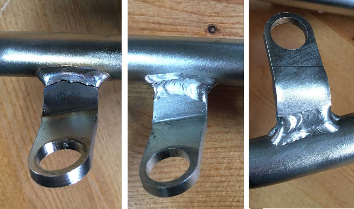

Heres a stainless motorcycle protection bar 'repaired'. Man this TIG is fun stuff!
