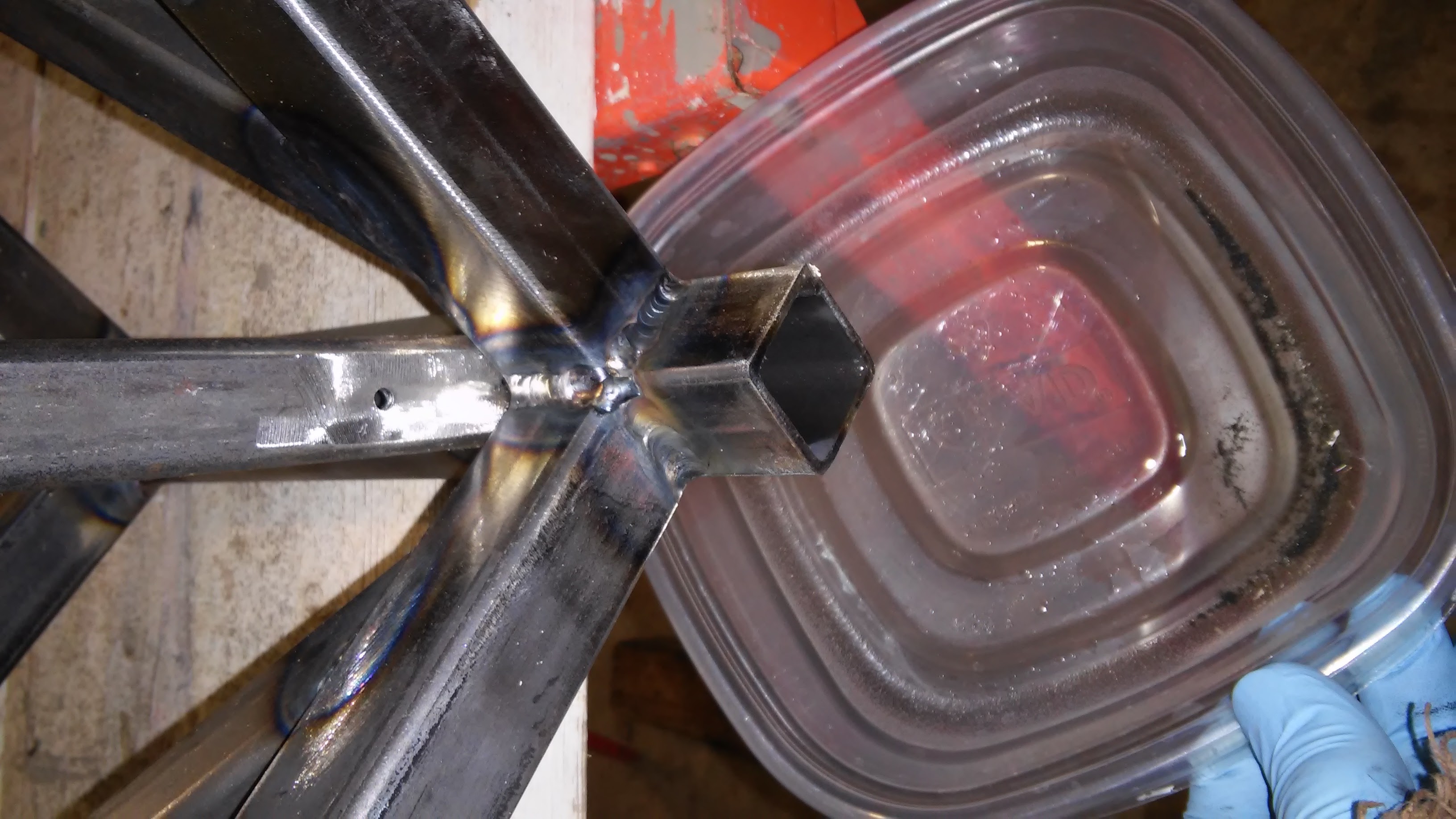

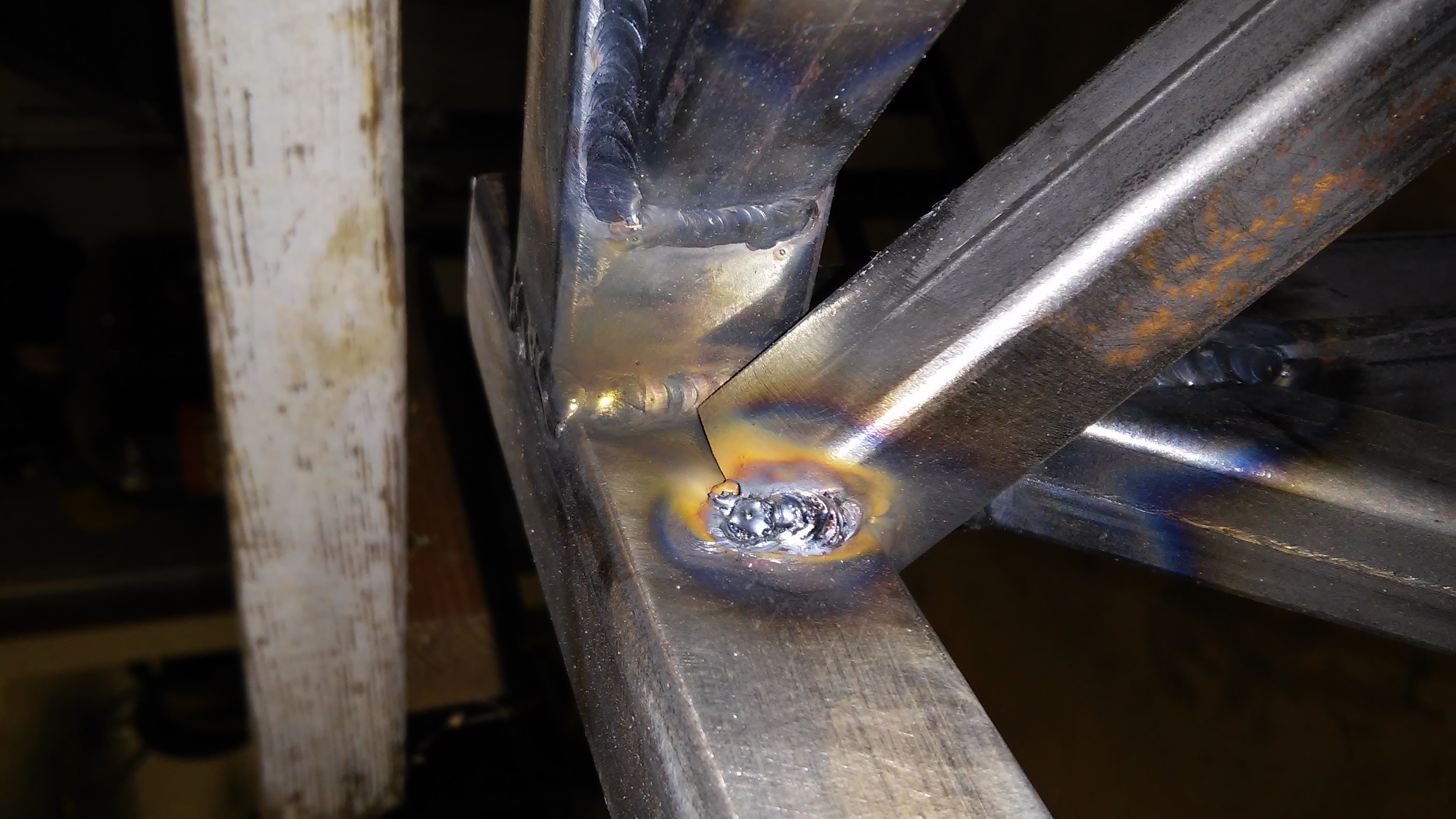

Not sure if this is contamination or what, but I've been welding this frame together with no problem on all the other joints. All of a sudden this one joint causes sparkling and popping, it contaminates the tungsten even though the tungsten doesn't touch. In the photo you can see it leaves a brown residue and a very pock marked looking attempt at a weld. What's causing this? This is the same material I used on the whole frame, it's 3/4" square steel tubing with .065 wall, same welder, same filler, same human doing the welding. Could this be oil or something that's inside this one piece of material? 20160519_193320.jpg

Is the tubing closed on the other end? Pressure will build up and force the atmospheric air out the joint contaminating the puddle. I ran into that problem a lot when doing s/s tubing rails, same with aluminum as well. I ended up drilling holes that would be covered by the pipe before I tacked it together to prevent pressure build up....Mike
   / Tig weld problem

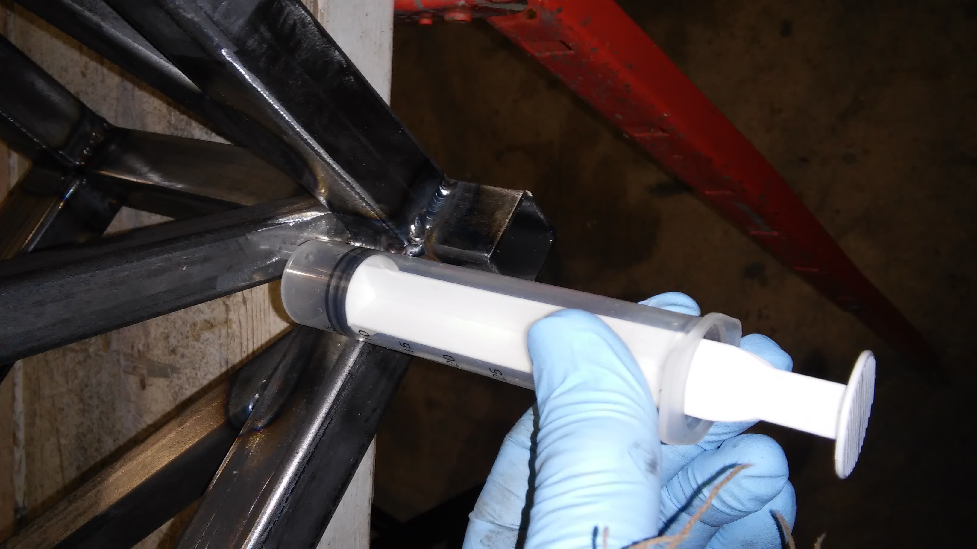

Problem solved, here's what I did. I drilled an 1/8" hole in the bottom of the square tube near the end that had the contamination problem. Then I stood the frame up on end so that piece is oriented vertically and injected acetone in that hole with a horse syringe. I collected the acetone that ran out the bottom through the parts of the bad joint that I hadn't welded yet. There was a lot of dark sediment that looked like grinding dust that came out, presumable there was also oil. There was still a little hissing and spitting when I rewelded that joint because there was trapped impurities in the old weld, but it came out pretty good all things considered. When I originally cut all these pieces I cleaned them in a parts washer with hot solvent, my guess is I somehow forgot to clean this piece. Won't make that mistake again. 20160520_183509.jpg20160520_173927.jpg20160520_173839.jpg
