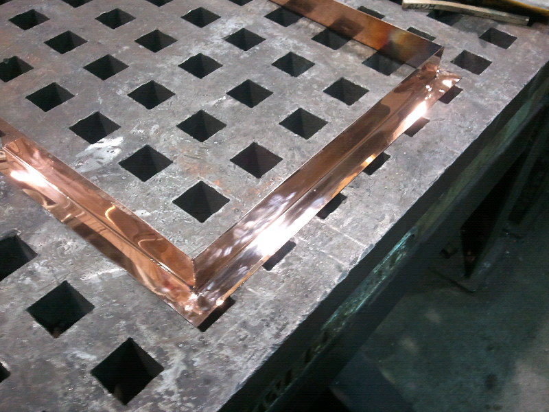

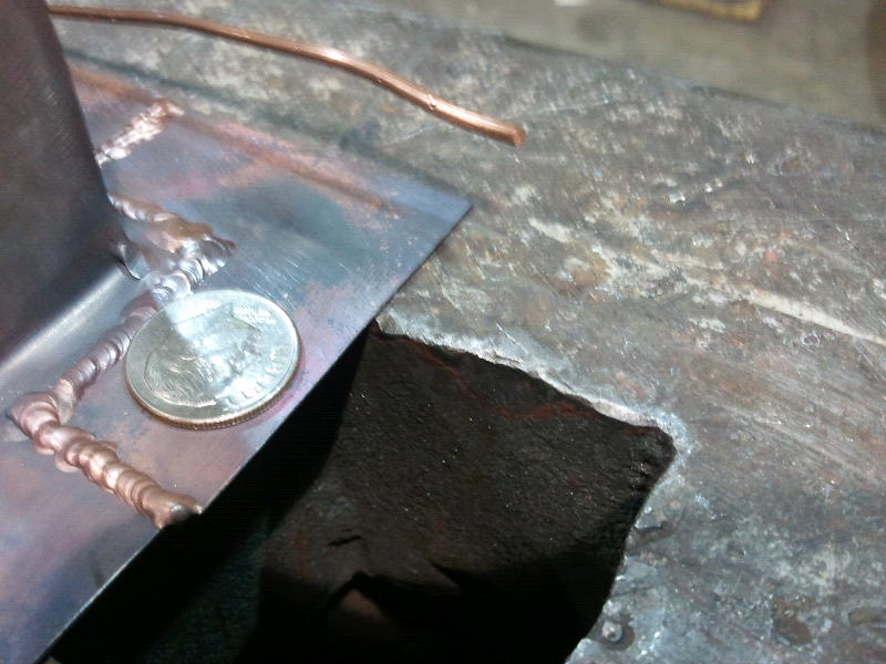

I recently welded up some copper, it was strictly ornamental and needed to be ground, blended and polished with colors matching. It was 28gauge and the only filler I had on hand was some #6 house wire. I took some real focus but I was able to pull it off. I used dcen straight argon, and dont hold me to it, but I think I had the machine over 100amps, copper can take some heat! Merry Christmas guys!
/ tig welding copper
#15
Mike, I had seen your post before about welding the copper. Its kind of what has given me the ideal to try it. A question I have for you, I have read that when welding copper that you concentrate the heat on the rod more than the piece to be welded. Did you find this to be true,
/ tig welding copper #16
Yes, in a way I did find it to be true. The instant that I would start my arc I had that filler right on it in the argon flow and instantly balling up and using the arc to break off that molten ball so to speak, then I would just stay with it like that, just breaking off one molten ball after the next. What took so much focus was trying to keep my giant filler as close to my tungsten as possible while still maintaining the tiniest closest arc as possible and keep repeating the balling and breaking off. If my base metal was thicker and I was a little more prepared with correct tungsten and filler I think it would have been just like using silicon bronze, that was kind of like the feel it had. I would say tho that my method was definately not textbook, and I was just winging it, LOL. Hope that helped a little bud!
